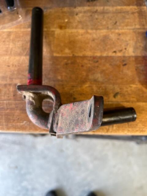

WH1987 10 #8 Posted May 9, 2022 This is what the spindle looks like. 1 Share this post Link to post Share on other sites

Handy Don 14,886 #10 Posted May 9, 2022 (edited) 3 minutes ago, WH1987 said: This is what the spindle looks like. Yep. I'm sure others will chip in, but those are the strongest and longest ¾" spindles I've seen. Are you trying to simply replace the bent one or get longer ones? Edited May 9, 2022 by Handy Don 1 Share this post Link to post Share on other sites
WH1987 10 #11 Posted May 9, 2022 3 minutes ago, Handy Don said: Yep. I'm sure others will chip in, but those are the strongest and longest ¾" spindles I've seen. Are you trying to simply replace the bent one or get longer ones? I would like to replace if I can find one. Otherwise I will try and repair this one. I have two machines with these spindles. Both are 414-8 machines. 1 Share this post Link to post Share on other sites

ri702bill 10,308 #14 Posted May 9, 2022 For what it's worth - judging by the severity of the damage to the spindle - you probably have other problems related to that. Bent rim, destroyed outer bearing, bent tie rod, on and on. What exactly happened?? Got a Honda 4313 Rider years ago where the PO missed the cup holder and pegged a tree. All the above as described... 1 1 Share this post Link to post Share on other sites
wallfish 18,677 #15 Posted May 9, 2022 I'm curious what happened to bend it like that. My loader tractor that has been worked to it's limits and beyond has those spindles on it and never bent one. 2 Share this post Link to post Share on other sites
WH1987 10 #16 Posted May 10, 2022 2 hours ago, ri702bill said: For what it's worth - judging by the severity of the damage to the spindle - you probably have other problems related to that. Bent rim, destroyed outer bearing, bent tie rod, on and on. What exactly happened?? Got a Honda 4313 Rider years ago where the PO missed the cup holder and pegged a tree. All the above as described... 1 hour ago, wallfish said: I'm curious what happened to bend it like that. My loader tractor that has been worked to it's limits and beyond has those spindles on it and never bent one. Interesting story but I do not drink while operating machinery. I have had this machine for 20 years and have not hit anything to do that. The RH spindle sheared at that joint about 5 years ago and I had it repaired. The LH is currently bent so before it shears I will repair it. My guess is seeing it is on the same machine it is a manufacturing issue which caused fatigue in the 90 degree bend. I have another 414-8 with a loader and so far no problem. 3 Share this post Link to post Share on other sites
wallfish 18,677 #17 Posted May 10, 2022 34 minutes ago, WH1987 said: Interesting story but I do not drink while operating machinery. I have had this machine for 20 years and have not hit anything to do that. The RH spindle sheared at that joint about 5 years ago and I had it repaired. The LH is currently bent so before it shears I will repair it. My guess is seeing it is on the same machine it is a manufacturing issue which caused fatigue in the 90 degree bend. I have another 414-8 with a loader and so far no problem. That is interesting ! Bending metal can cause fatigue as I was going to suggest just bending it back may result in the same problem. Wonder if the factory had to bend them after they were originally made???? 2 Share this post Link to post Share on other sites
