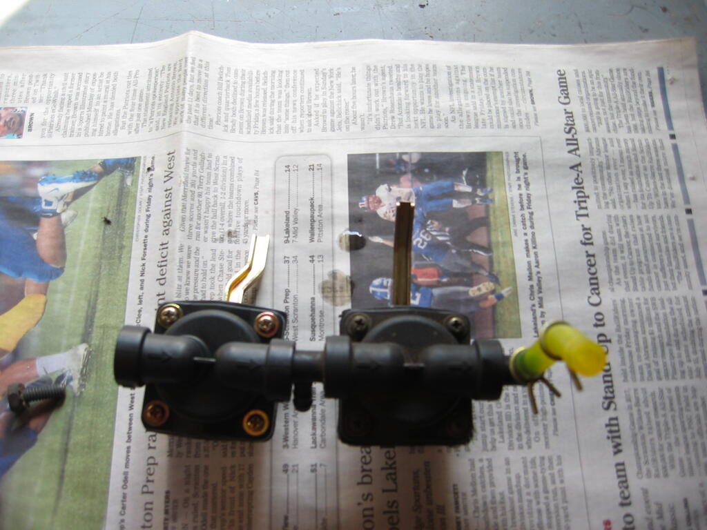

pfrederi 20,884 #2 Posted May 8, 2022 (edited) small block Kohlers K181 fuel pumps have an offset in the pump arm. if you are trying to use a big block pump it will not work Edited May 8, 2022 by pfrederi 3 Share this post Link to post Share on other sites
pfrederi 20,884 #3 Posted May 8, 2022 K181 pump on the left big block (10hp and up) right Welcome 2 Share this post Link to post Share on other sites

redrider55 2 #5 Posted May 8, 2022 14 minutes ago, pfrederi said: small block Kohlers K181 fuel pumps have an offset in the pump arm. if you are trying to use a big block pump it will not work thanks for the info this has to be it! Share this post Link to post Share on other sites
