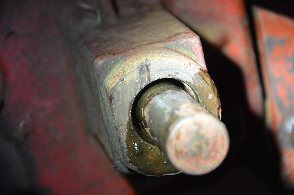

CodyP 51 #1 Posted May 8, 2022 (edited) My axle was walking off on both sides so I tightened the set screws on both sides but my left side is just leaking grease is it the seal? does it even have a seal or do I just regrease the axle??? oh it's a raider 9 1968 trans is 5060 axles limited slip Edited May 8, 2022 by CodyP forgot vital information Share this post Link to post Share on other sites
pfrederi 20,831 #2 Posted May 8, 2022 There is a seal you can replace from the outside after you remove the hub WH#100443 SKF 11050 2 1 Share this post Link to post Share on other sites
pfrederi 20,831 #3 Posted May 8, 2022 Also check the bearings. There should be no movement up down and front to back. about 1/8" in and out is OK. Share this post Link to post Share on other sites
stevasaurus 23,739 #4 Posted May 8, 2022 BTW, that is not grease, it is 90wt gear lube oil. Share this post Link to post Share on other sites
Maxwell-8 4,371 #5 Posted May 8, 2022 A bit like this? Share this post Link to post Share on other sites
CodyP 51 #6 Posted May 13, 2022 On 5/8/2022 at 2:27 PM, Maxwell-8 said: A bit like this? yes I got the seal suggested and it worked perfectly Share this post Link to post Share on other sites
