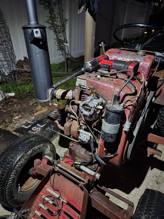

Monstrosity 1,153 #30 Posted May 14, 2022 NOT A FAN DO NOT RECOMMEND NO AFTERMARKET CARBS..... HATED putting this carb amazon carb on here. NOTHING lines up. Don't know what to do about the choke but it's only to move it while the original gets cleaned.. But not going to lie starts right up runs very smooth linkage doesn't allow for wide open throttle because NOTHING LINES UP! Need to be very crafty to make these fit and operate as original. Max helped me remove original carb learned how to use a wrench and screw driver not bad for a 4y/o. Rebuilt the fuel pump and never order stuff from Amazon... 3 5 Share this post Link to post Share on other sites
ebinmaine 81,289 #31 Posted May 14, 2022 23 minutes ago, Monstrosity said: NOT A FAN DO NOT RECOMMEND NO AFTERMARKET CARBS..... HATED putting this carb amazon carb on here. NOTHING lines up. Don't know what to do about the choke but it's only to move it while the original gets cleaned.. But not going to lie starts right up runs very smooth linkage doesn't allow for wide open throttle because NOTHING LINES UP! Need to be very crafty to make these fit and operate as original. Max helped me remove original carb learned how to use a wrench and screw driver not bad for a 4y/o. Rebuilt the fuel pump and never order stuff from Amazon... Looks like he done alright. Where'd you get the fuel pump rebuild kit?? 1 Share this post Link to post Share on other sites

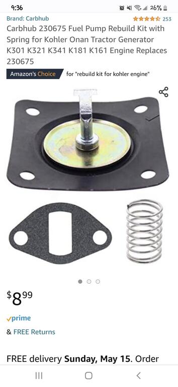

Monstrosity 1,153 #32 Posted May 14, 2022 (edited) @ebinmaine had to trim down the "T" to fit the pump too Edited May 14, 2022 by Monstrosity 1 1 Share this post Link to post Share on other sites

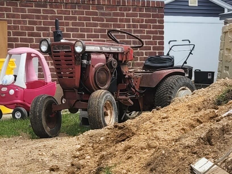

Monstrosity 1,153 #33 Posted May 14, 2022 So I'm toying with the idea of painting frame and engine and leaving the patina on the seat pan, hood and grille. I'm torn about it too. My wife wants a full paint job though.... I would have the sheet metal powder coated and I'd paint the frame, axles and engine myself. I like the look of a fresh tractor.. but this one has the right amount original paint on it to do the patina look. 3 1 Share this post Link to post Share on other sites
Handy Don 17,740 #34 Posted May 14, 2022 9 minutes ago, Monstrosity said: So I'm toying with the idea of painting frame and engine and leaving the patina on the seat pan, hood and grille. I'm torn about it too. My wife wants a full paint job though.... I would have the sheet metal powder coated and I'd paint the frame, axles and engine myself. I like the look of a fresh tractor.. but this one has the right amount original paint on it to do the patina look. I can relate to the dilemma. I wanted to patina the 854 I'm doing now, but as I got into it there just wasn't enough good paint so it'll get a full paint job. Without explaining my discovery, I simply told my spouse that "On second thought, you were right. It'll look better painted so I'll do that." 1 5 Share this post Link to post Share on other sites

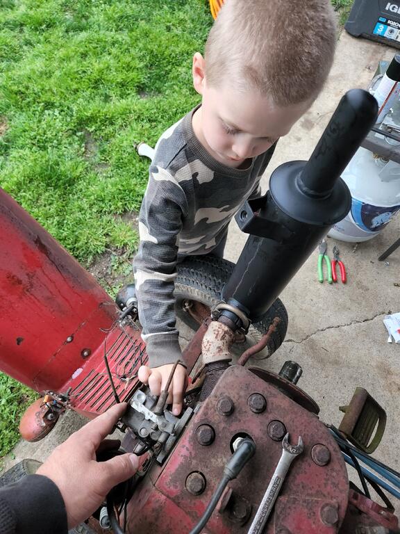

Monstrosity 1,153 #36 Posted May 20, 2022 Well the itch has started. I started to pull apart the center mast. 2 1 Share this post Link to post Share on other sites
ebinmaine 81,289 #37 Posted May 20, 2022 6 hours ago, Monstrosity said: the itch has started (Un)fortunately ((??)) There's no known remedy for that. 4 Share this post Link to post Share on other sites
