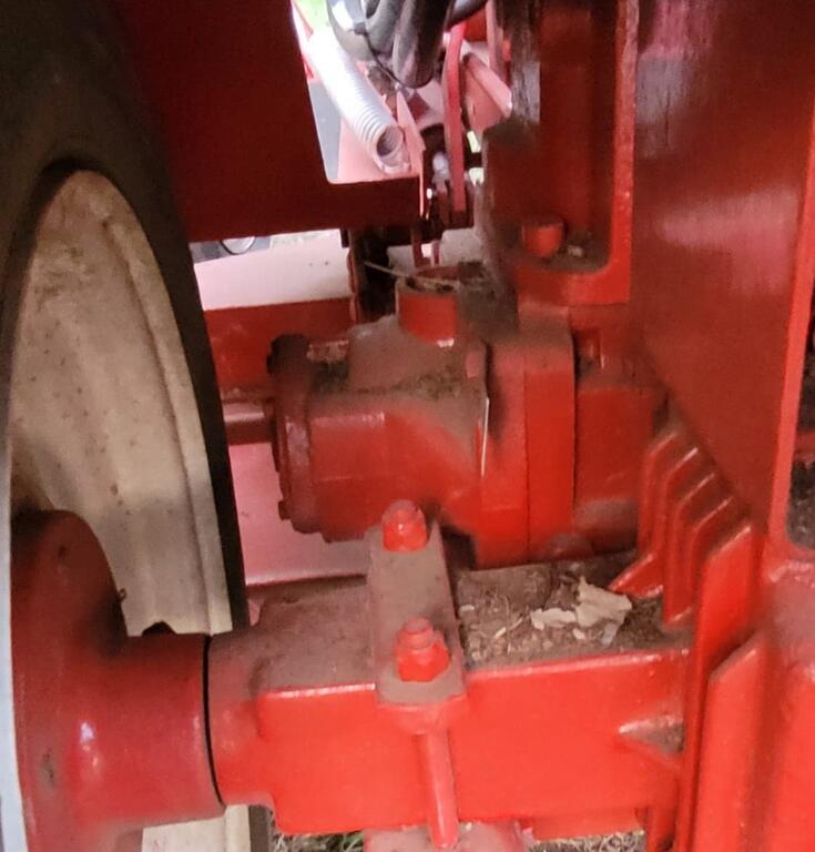

JoeM 10,154 #7 Posted May 8, 2022 (edited) There is an angle iron bracket that is used on the top of the rear axle mount. The standard bracket is just a flat bar, your 8 speed should have that angle style. Page 3 of the manual shows this bracket. 8 speed vs hydro I used both like the hydro better, I just pull the hydro a little in reverse to control the tiller. Especially in hard untilled ground. Edited May 8, 2022 by JoeM Share this post Link to post Share on other sites
Mike C160 251 #8 Posted May 8, 2022 5 minutes ago, JoeM said: There is an angle iron bracket that is used on the top of the rear axle mount. The standard bracket is just a flat bar, your 8 speed should have that angle style. Page 3 of the manual shows this bracket. 8 speed vs hydro I used both like the hydro better, I just pull the hydro a little in reverse to control the tiller. Especially in hard untilled ground. I see it on the 8 speed, but I dont see where it would go on the hydro... see photo below... I dont have the manual for the new hydro one. its a 1977 Share this post Link to post Share on other sites

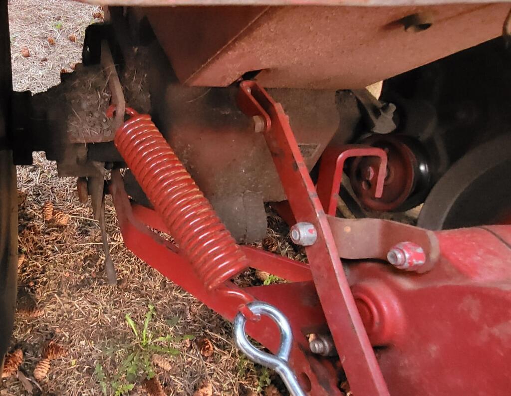

Goldnboy 1,147 #9 Posted May 8, 2022 The axle bracket is shown from a 8 speed 1 Share this post Link to post Share on other sites

Goldnboy 1,147 #12 Posted May 8, 2022 (edited) The chain goes from the rear rockshaft under seat on tractor to the clevis or slot hitch. A cable still runs from the tractor lift arm as shown in the picture above to the rear rockshaft. Different model year tractors had different configurations for rear lift. I am not positive but I believe most tractors pre 1976 used a cable from lift arm to the implement sleeve hitch. The in 1976 Wheel Horse began using a rear rockshaft under the seat similar to what I posted and changed it again in 1978 models Edited May 8, 2022 by Goldnboy 1 Share this post Link to post Share on other sites
Mike C160 251 #13 Posted May 8, 2022 Just now, Goldnboy said: The chain goes from the rear rockshaft under seat on tractor to the clevis or slot hitch. A cable still runs from the tractor lift arm as shown in the picture above to the rear rockshaft. Different model year tractors had different configurations for rear lift. I am not positive but I believe most tractors pre 1976 used a cable from lift arm to the implement sleeve hitch. The in 1976 Wheel Horse began using a rear rockshaft under the seat similar to what I posted and changed it again in 1980. Yeah, geeze.... I am missing that rear under the seat rocker shaft. Any way around this? Cheers Share this post Link to post Share on other sites
Mike C160 251 #14 Posted May 8, 2022 7 minutes ago, Goldnboy said: The chain goes from the rear rockshaft under seat on tractor to the clevis or slot hitch. A cable still runs from the tractor lift arm as shown in the picture above to the rear rockshaft. Different model year tractors had different configurations for rear lift. I am not positive but I believe most tractors pre 1976 used a cable from lift arm to the implement sleeve hitch. The in 1976 Wheel Horse began using a rear rockshaft under the seat similar to what I posted and changed it again in 1978 models And the tiller i have is for the 8 speed manual lift. See the photo. I suppose I could make up a cable similar to this and operate in the same way.. Cheers! Share this post Link to post Share on other sites
