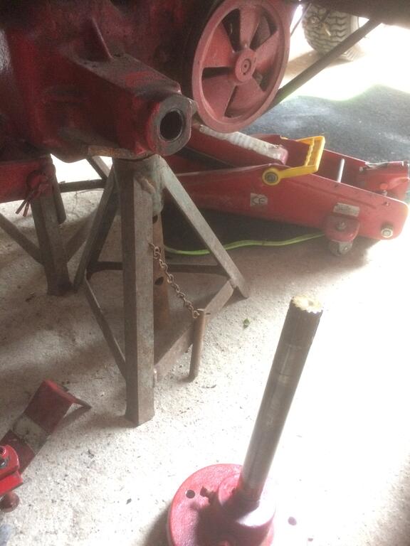

NickG 2 #1 Posted May 7, 2022 Greetings from England everybody, Bought myself an SK486 a while back. Just got the Kohler 16hp running but when I put it into gear the tractor doesn’t move. Thinking it might be the axle keys I took the back wheels off and the rear axle came out with the hub. Looks like a needle bearing has gone that the axle slots into. I’ve looked at the transmission diagrams but can’t work out what holds the axle in place to stop it coming out. Is it just the needle bearings? Any help would be greatly appreciated. Share this post Link to post Share on other sites
lynnmor 8,075 #2 Posted May 7, 2022 A retaining ring goes in this groove, you will need to split the transmission to repair. 1 Share this post Link to post Share on other sites

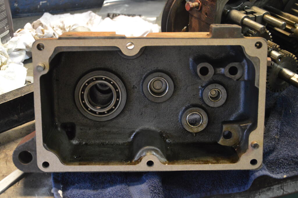

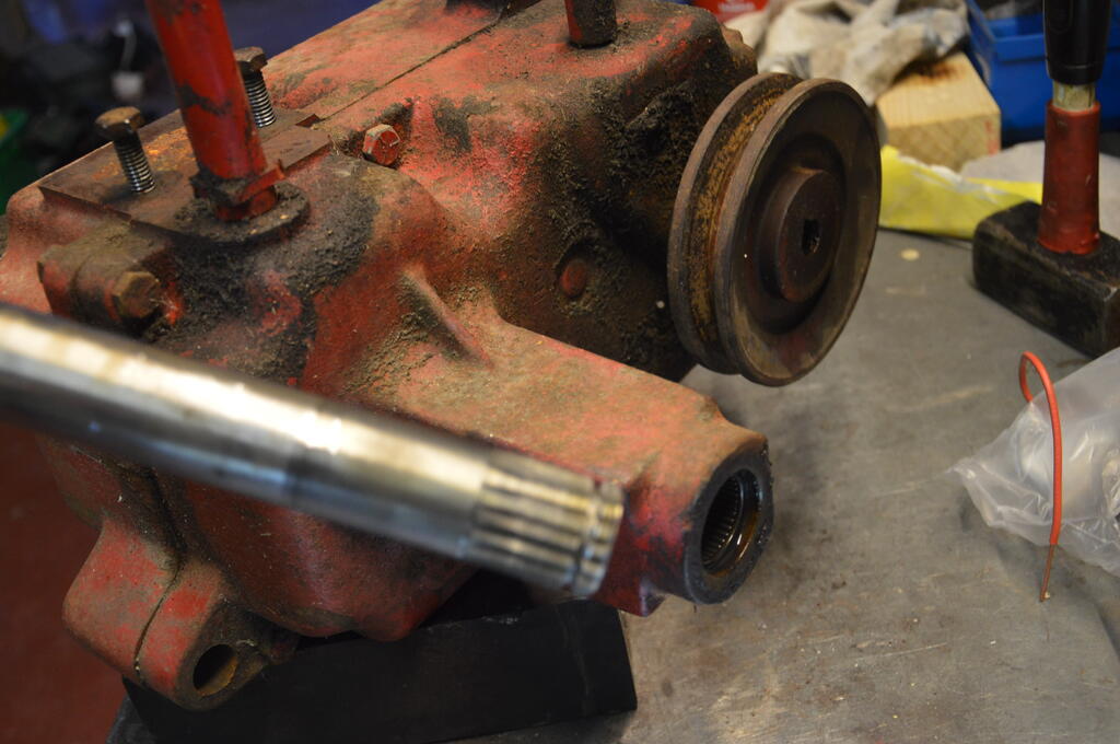

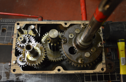

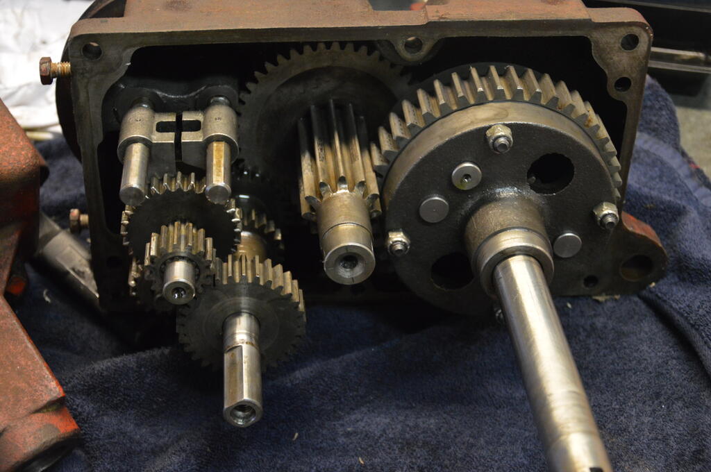

Maxwell-8 4,367 #3 Posted May 7, 2022 (edited) a c-clip or snapring, often gets of the axle when people want to remove the hub with a hammer. Bought one whit the same issue. and when a bearing goes out, you have to be carfull and stop using the tranny, you will have to split th tranny and take out all the bearing rollers and pull the remainings of the bearing and place a now one in. replaced bearings 4-5 times in the 2 year ownership of these tractors Edited May 7, 2022 by Maxwell-8 2 2 Share this post Link to post Share on other sites
ri702bill 10,019 #4 Posted May 7, 2022 And a good time to replace the axle, input, and brake shaft seals if they are at all questionable. @Maxwell-8 - the inside of that 8 speed looks mighty clean - way to go!! 1 2 Share this post Link to post Share on other sites

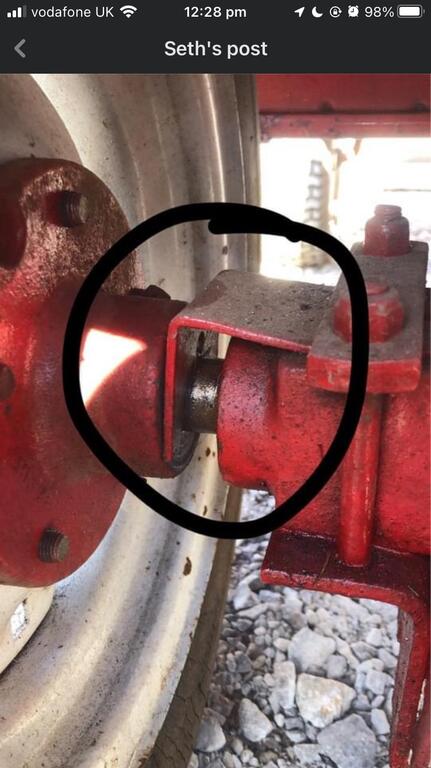

NickG 2 #6 Posted May 7, 2022 Many thanks Guys, your help is much appreciated. i now know why, when I first got the tractor, why the fittings in the picture were fitted on the back. The previous owner was probably took scared to split the transmission 😂. Thanks again. Can’t wait to get this horse moving’ 2 2 Share this post Link to post Share on other sites

Maxwell-8 4,367 #8 Posted May 7, 2022 44 minutes ago, ri702bill said: @Maxwell-8 - the inside of that 8 speed looks mighty clean - way to go!! thanks, I often find rust and dirt inside the transaxles. I am already into the habit that if the oil inside the transmission isn't clean. I open up the transmission. Always peace of mind knowing your tranny is spotless inside. 2 Share this post Link to post Share on other sites

Ed Kennell 43,081 #13 Posted May 7, 2022 3 hours ago, NickG said: Many thanks Guys, your help is much appreciated. i now know why, when I first got the tractor, why the fittings in the picture were fitted on the back. The previous owner was probably took scared to split the transmission 😂. Thanks again. Can’t wait to get this horse moving’ Was that to replace a missing axle bearing? It would not have secured an axle with a missing snap ring retainer. Share this post Link to post Share on other sites

ri702bill 10,019 #15 Posted May 7, 2022 3 minutes ago, Ed Kennell said: It would not have secured an axle with a missing snap ring retainer. Ed - over time that would have cut a groove in the shaft as it squeaked away - making somewhat of a half-a$$ed semi-retainer!! 1 1 Share this post Link to post Share on other sites
NickG 2 #16 Posted May 7, 2022 Yes. Looks like they cut a groove in the axle. Glad I spotted it before I put the tractor to work 😅 42 minutes ago, Ed Kennell said: Was that to replace a missing axle bearing? It would not have secured an axle with a missing snap ring retainer. Share this post Link to post Share on other sites
