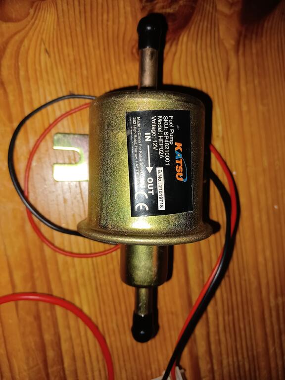

Dan.gerous 2,696 #3 Posted May 3, 2022 Electric fuel pump and the simple version that is currently on a couple of my machines - which also works very well. Share this post Link to post Share on other sites

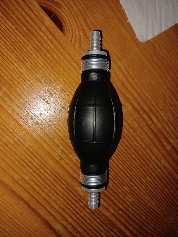

lynnmor 9,013 #4 Posted May 3, 2022 A primer bulb will fill the carburetor if installed correctly, make sure that it is supplying fuel by disconnecting the fuel line. Tossing all kinds of fuel pumps won't help if the primer bulb did indeed fill the carburetor, so look for other problems such as a dirt in the carburetor. 5 Share this post Link to post Share on other sites
Dan.gerous 2,696 #5 Posted May 3, 2022 4 minutes ago, lynnmor said: A primer bulb will fill the carburetor if installed correctly, make sure that it is supplying fuel by disconnecting the fuel line. Tossing all kinds of fuel pumps won't help if the primer bulb did indeed fill the carburetor, so look for other problems such as a dirt in the carburetor. Good point, the bulb could be installed backwards - there is an arrow on it for direction flow. 2 Share this post Link to post Share on other sites

midpack 1,148 #7 Posted May 3, 2022 4 hours ago, Dan.gerous said: Electric fuel pump and the simple version that is currently on a couple of my machines - which also works very well. I've had the same pump (HEP-02A) on mine with a different label for at least 5-6 years. $12.00 shipped off eBay All I did with the existing pump was run a length of fuel line between the connections to keep crud out. Not even sure it was necessary, but cheep ins 3 Share this post Link to post Share on other sites

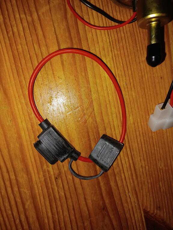

Racinbob 13,111 #8 Posted May 3, 2022 I bought a couple of the Ebay cheapies but decided to get a better unit for my 2005 and purchased a Mr. Gasket 42s. I love it especially in the winter when it can sit for longer spells. I mounted it just under the tank on the left side. It needs to be on a circuit that's hot when the ignition is on. A wire was already back there that was for one of the safety gizmos. I made sure it was fused properly and I'm good to go. I did use one of the cheapies on my 854 and it's working great. 3 Share this post Link to post Share on other sites
953 nut 68,520 #9 Posted May 3, 2022 5 hours ago, mrc said: shot of carb clean to help it get going if it has been sitting. I installed a primer bulb. that did not help. I replaced the fuel pump with a new plastic fuel pump. that did not help. Have you replaced the rubber fuel hose? As they age a fuel line can develop small cracks that allow air to enter. I have gone to electric fuel pumps on several of my tractors and am pleased with the results. Mount the pump lower than the fuel tank bottom. Connect the red wire from the pump to your hour meter wire so it will be off when the ignition key is off and is protected by a fuse. As for a specific brand of fuel pump you'll find all sorts of opinions on that, I have had good results with Carbole 2-3.5 PSI pumps found on . There are lots of threads on here about electric fuel pumps and the brands people prefer, read them and decide. 2 Share this post Link to post Share on other sites

mrc 1,109 #12 Posted May 24, 2022 well I checked the primer bulb and it WAS installed correctly with the arrow pointing towards the carb. I removed the fuel line from the carb and squeezed the bulb, fuel shot out of the line. I removed the float bowl and it was virtually spotless. i wiped out the bowl and reinstalled it .i replaced the fuel line from the bulb to the carb because i had to slice it off one of the nipples. i waited one week and it started without squeezing the bulb and no carb spray either . i'll wait a couple more weeks and retry to start thank you to all who responded. mike in mass. 1 Share this post Link to post Share on other sites
