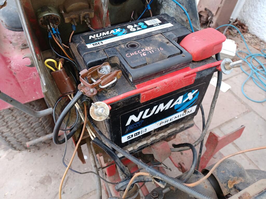

Dan.gerous 2,696 #1 Posted May 1, 2022 Evening/morning Just a quick one, does anyone have a photo of the way the battery in a C125 is secured? All 3 of mine are bodge jobs, wire, bailing twine and bungee. Did a search on here and a result came up from 2008 but the pictures are missing Thanks in advance 👍 Share this post Link to post Share on other sites

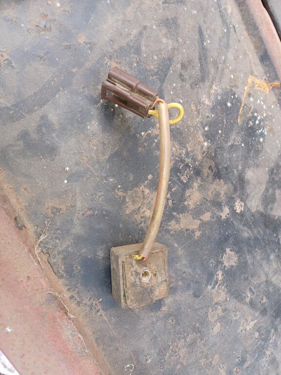

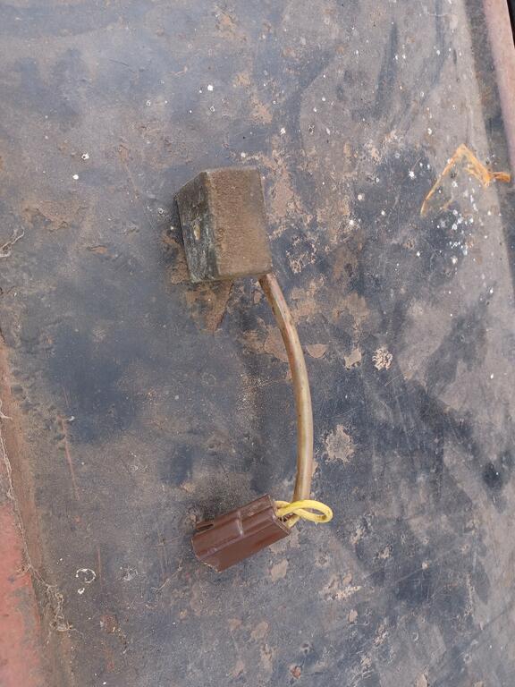

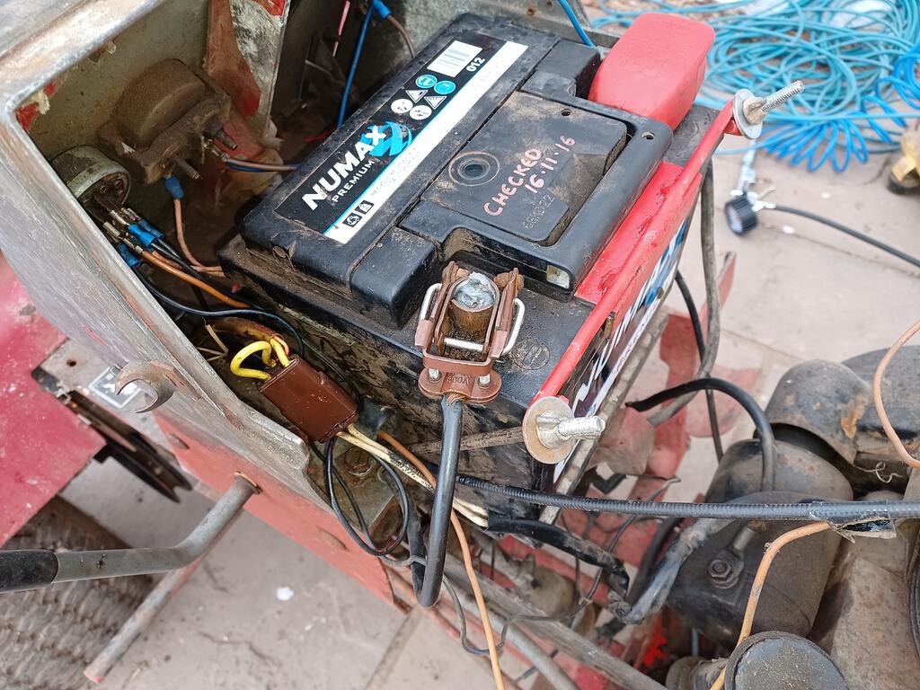

Dan.gerous 2,696 #7 Posted May 2, 2022 OK, so what is this, it's bolted in behind the battery and the brown plastic connection sparked then wheelhorse was dead.... Share this post Link to post Share on other sites
Dan.gerous 2,696 #8 Posted May 2, 2022 Was a bad earth that caused the spark. Share this post Link to post Share on other sites
gwest_ca-(File Mod) 12,416 #9 Posted May 2, 2022 Voltage regulator that is shown starting in 1982 ipl https://www.partstree.com/models/01-12k803-c-125-toro-garden-tractor-1982/electrical-system-single-cylinder-models-6/ 2 1 Share this post Link to post Share on other sites
peter lena 9,993 #10 Posted May 2, 2022 @Dan.gerous grounding is a major issue on horses , converted all mine over to a main line grounding set up . add another battery cable , from your battery ground bolt point , behind dash , to corner of engine / frame , next to clutch pedal , use serrated washers and dielectric grease , at every bolt point , from there , use 10-12 ga wire to engine charging rectifier area , and on to headlights . also run 10-12 ga wire directly back to behind dash / gauge area . that simple grounding enhancement , has eliminated erratic wire issues I had . if you have a single alligator clip heavy ga wire made up , you can easily verify this gain , with clip on . thats what I did . pete 1 Share this post Link to post Share on other sites

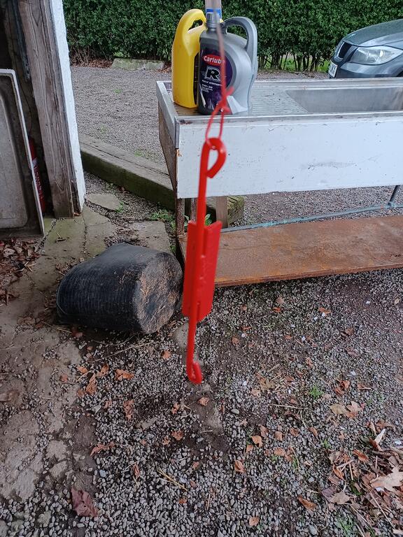

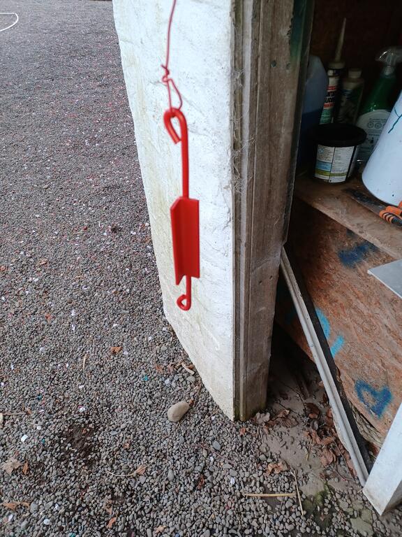

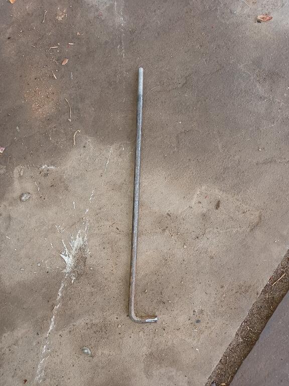

Dan.gerous 2,696 #11 Posted May 2, 2022 Have made a holder out of bits laying about the workshop. Cut some thread into the bar, fingers crossed that it works. Red paint reacted to the undercoat, but it's all I have at the moment. 3 1 Share this post Link to post Share on other sites

Dan.gerous 2,696 #14 Posted May 2, 2022 It's on, had to tweak it a bit but it's very secure 4 3 Share this post Link to post Share on other sites

Dan.gerous 2,696 #16 Posted May 2, 2022 1 hour ago, gwest_ca said: Voltage regulator that is shown starting in 1982 ipl https://www.partstree.com/models/01-12k803-c-125-toro-garden-tractor-1982/electrical-system-single-cylinder-models-6/ All three of the regulators on the C125's look rough. Is there a modern replacement? Share this post Link to post Share on other sites

WHX?? 57,642 #20 Posted May 2, 2022 Lots of threads here Dan on that regulator ...which actually is not a regulator at all but merely a rectifier. Very prone to over charging battery with extended seat time. They are very expensive over here these days and hen's teeth over there most likely. The general consensus is to replace it wit a cheaper and available three term regulator. Do a search here on 109313 and you'll find some good poop on replacing it. 3 1 Share this post Link to post Share on other sites
roadapples 6,987 #21 Posted May 2, 2022 Clean all ground points with wire brush and coat with dielectric grease. No more problems... 2 Share this post Link to post Share on other sites
peter lena 9,993 #22 Posted May 2, 2022 @ Dan.gerous , that separate ground is easy , go from your battery ground bolt point , to the dash area , then you can single wire to all of your gage mounts , bolt , bracket points . that dash dissimilar metal is the ground culprit , when I did that to mine , issues stopped . the bolt on electrical luge info I sent you is a very simple / easy electrical connection . pete 1 Share this post Link to post Share on other sites
Dan.gerous 2,696 #23 Posted May 2, 2022 1 minute ago, peter lena said: @ Dan.gerous , that separate ground is easy , go from your battery ground bolt point , to the dash area , then you can single wire to all of your gage mounts , bolt , bracket points . that dash dissimilar metal is the ground culprit , when I did that to mine , issues stopped . the bolt on electrical luge info I sent you is a very simple / easy electrical connection . pete Will start on that tomorrow, should be able to find most of the bits in town. The Lug is proving difficult, but it's probably called something else over here. 1 Share this post Link to post Share on other sites
