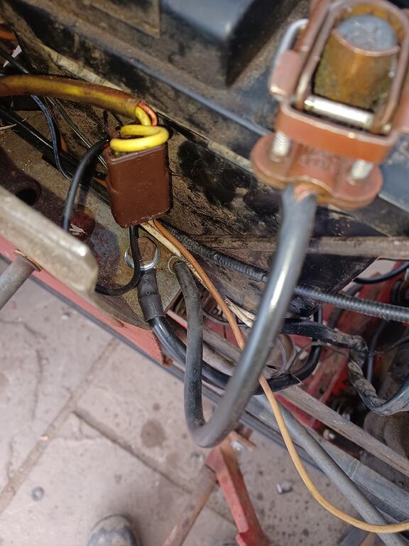

Dan.gerous 2,696 #30 Posted May 3, 2022 On 5/2/2022 at 1:58 PM, peter lena said: @Dan.gerous grounding is a major issue on horses , converted all mine over to a main line grounding set up . add another battery cable , from your battery ground bolt point , behind dash , to corner of engine / frame , next to clutch pedal , use serrated washers and dielectric grease , at every bolt point , from there , use 10-12 ga wire to engine charging rectifier area , and on to headlights . also run 10-12 ga wire directly back to behind dash / gauge area . that simple grounding enhancement , has eliminated erratic wire issues I had . if you have a single alligator clip heavy ga wire made up , you can easily verify this gain , with clip on . thats what I did . pete Added earth from earth clamp on dashboard down to the shaker plate. Has the grippy washers Starts now, hard to say if it helped, but it certainly didn't hurt! Now it won't run without choke, guess must be **** in carb - it has been sat a while. Share this post Link to post Share on other sites

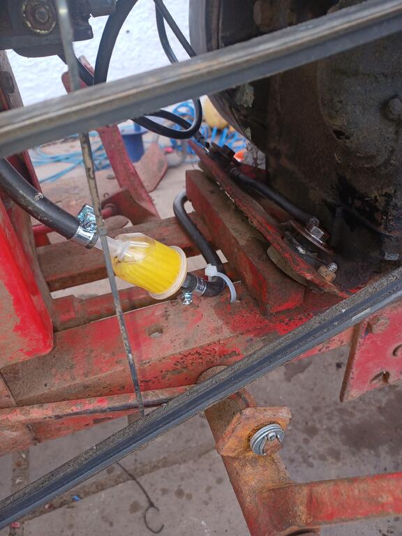

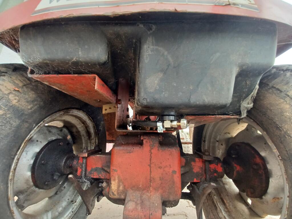

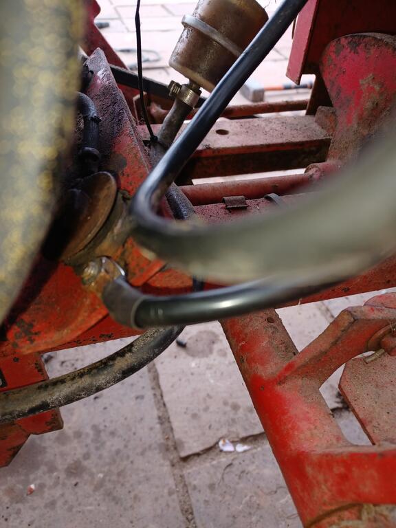

peter lena 9,932 #32 Posted May 3, 2022 @Dan.gerous glad you did that , that added cable , is so easy to do , once I saw improvement , basically the constant function of related electrical hook ups. my headlights are very bright , and my amperage gauge is regularly charging . that fuel filter looks like its over due for a clean swap , would also pull the fuel bowl on carb , that choke usage is telling you something , regularly use a gas treatment to help carb, ever pull that fuel tank bottom valve ? that valve is like 6 $ , used dielectric grease on the tank grommet for easier , installation, thanks for the feed back , good talking , pete 1 Share this post Link to post Share on other sites
Dan.gerous 2,696 #33 Posted May 3, 2022 3 hours ago, peter lena said: @Dan.gerous glad you did that , that added cable , is so easy to do , once I saw improvement , basically the constant function of related electrical hook ups. my headlights are very bright , and my amperage gauge is regularly charging . that fuel filter looks like its over due for a clean swap , would also pull the fuel bowl on carb , that choke usage is telling you something , regularly use a gas treatment to help carb, ever pull that fuel tank bottom valve ? that valve is like 6 $ , used dielectric grease on the tank grommet for easier , installation, thanks for the feed back , good talking , pete Yes a very simple improvement to make. I think there is a fuel filter in the shed so will dump that old one. Thanks again for the advice, will let you know how the fueling goes. 👍 Share this post Link to post Share on other sites

Dan.gerous 2,696 #36 Posted May 4, 2022 22 hours ago, peter lena said: @Dan.gerous glad you did that , that added cable , is so easy to do , once I saw improvement , basically the constant function of related electrical hook ups. my headlights are very bright , and my amperage gauge is regularly charging . that fuel filter looks like its over due for a clean swap , would also pull the fuel bowl on carb , that choke usage is telling you something , regularly use a gas treatment to help carb, ever pull that fuel tank bottom valve ? that valve is like 6 $ , used dielectric grease on the tank grommet for easier , installation, thanks for the feed back , good talking , pete New fuel line, tap and filter - still needs choke so will get carb off next. 1 Share this post Link to post Share on other sites

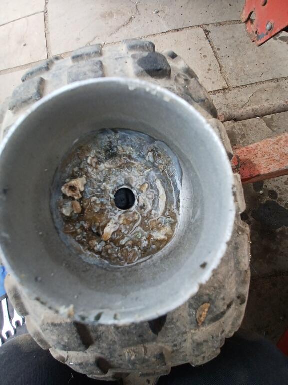

Handy Don 16,915 #37 Posted May 4, 2022 55 minutes ago, Dan.gerous said: You may want to put rear axle seals on your eventual to-do list, as well! 1 Share this post Link to post Share on other sites
peter lena 9,932 #38 Posted May 4, 2022 @Dan.gerous good for you dan ! as you are finding out you are gaining on solid running and reliability , notice those rusty / crusty " movement areas " ? aerosol lubrication or grease will make them work without effort . how did that tank grommet work out for you ?glad you did it ! you might be over there , but your response , is like you are right here ! battery set up looks good . now yo can also add a ground to your ignition rectifier on engine cooling tin , and also on to headlights . just take it off of the added cable bolt point . that really helped out my electrical issues . stay on it , ask away , good job , pete 1 Share this post Link to post Share on other sites
Dan.gerous 2,696 #39 Posted May 4, 2022 Yikes! That would appear to be the problem, all cleaned out and new rubber seals on. Runs like a dream!!!! So excited that I mowed all the lawns once getting it all back together. 2 Share this post Link to post Share on other sites
Dan.gerous 2,696 #40 Posted May 4, 2022 1 hour ago, Handy Don said: You may want to put rear axle seals on your eventual to-do list, as well! Yes for sure. 4 of my 5 horses need that job, be on the short list. There is a nail holding the clutch on this particular machine... 1 Share this post Link to post Share on other sites

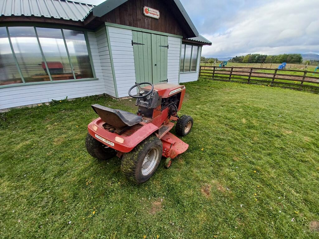

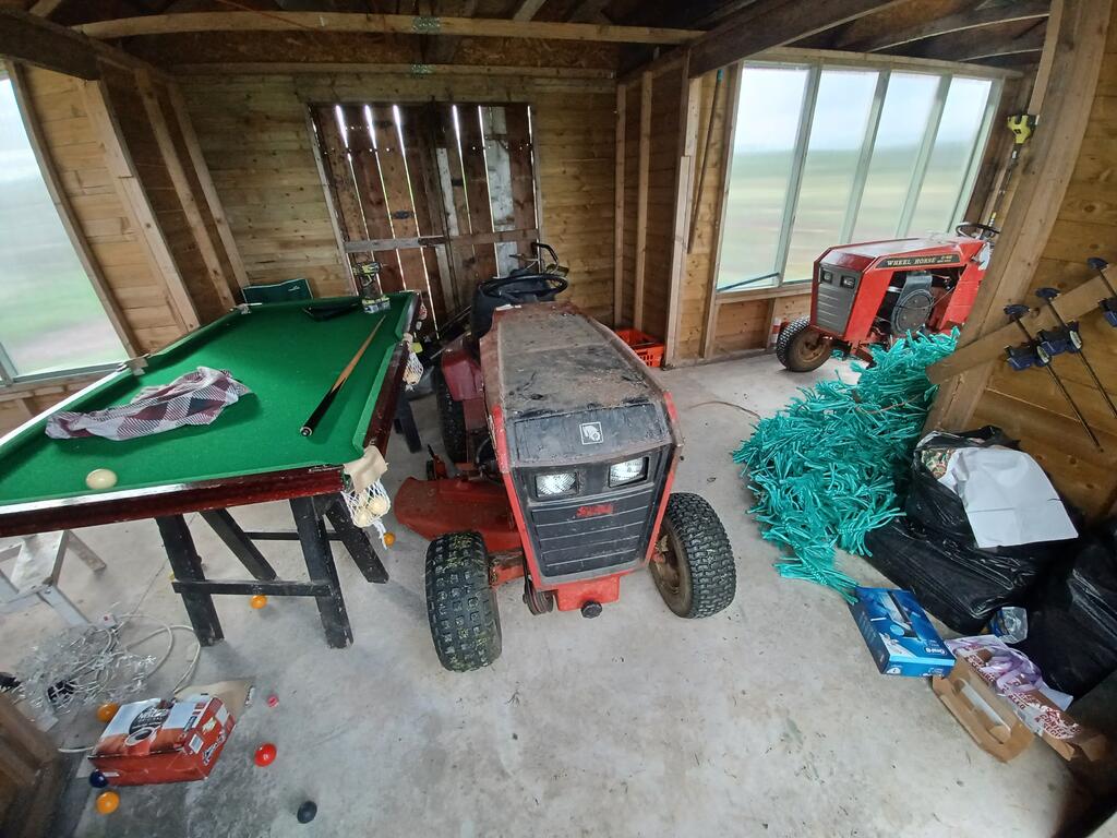

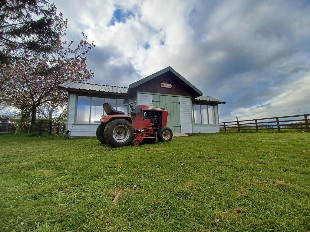

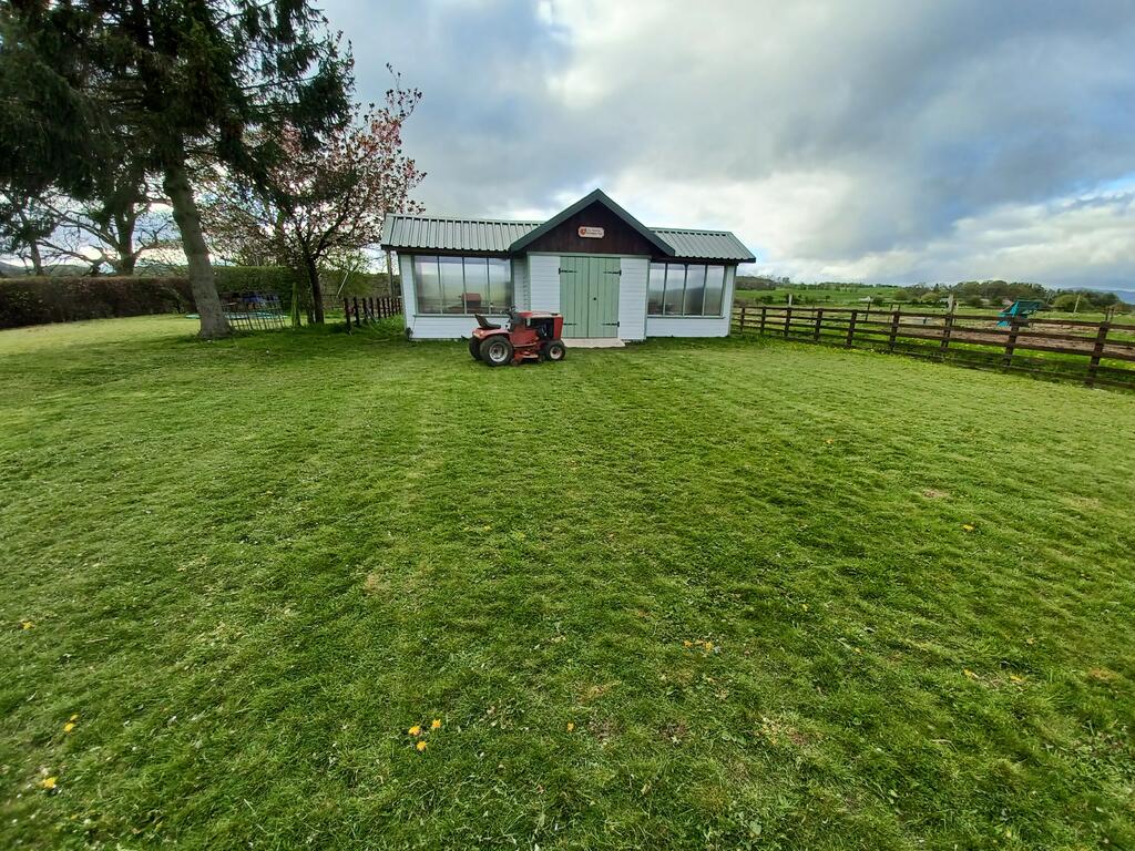

Dan.gerous 2,696 #41 Posted May 4, 2022 Had to squeeze it into the Oranjerie as a present for doing such a good job. I hand mowed the lawn the other day and it took hours. 40 year old machine did it in 15 minutes - just a rough job though to check everything is working. 2 1 Share this post Link to post Share on other sites
Stormin 9,988 #42 Posted May 4, 2022 (edited) Primer bulbs help if tractor stands for a while, Dan. And that shed/greenhouse whatever is the dogs whatsits. BTW. You been putting weight on. Edited May 4, 2022 by Stormin 1 Share this post Link to post Share on other sites
Dan.gerous 2,696 #43 Posted May 4, 2022 13 minutes ago, Stormin said: Primer bulbs help if tractor stands for a while, Dan. And that shed/greenhouse whatever is the dogs whatsits. BTW. You been putting weight on. Yeah the bulbs are good, although my last Chinese one perished after about a year - get what you pay for I guess. I'm really chuffed with the Greenhouse, be a nice legacy to leave from our time at Floors Farm. Nope I'm still a 10 1/2 stone whippet, too busy to get fat!! We will be half an hour closer to being neighbours as back just outside Dumfries at the next Farm. Share this post Link to post Share on other sites
Dan.gerous 2,696 #44 Posted May 4, 2022 2 hours ago, peter lena said: @Dan.gerous good for you dan ! as you are finding out you are gaining on solid running and reliability , notice those rusty / crusty " movement areas " ? aerosol lubrication or grease will make them work without effort . how did that tank grommet work out for you ?glad you did it ! you might be over there , but your response , is like you are right here ! battery set up looks good . now yo can also add a ground to your ignition rectifier on engine cooling tin , and also on to headlights . just take it off of the added cable bolt point . that really helped out my electrical issues . stay on it , ask away , good job , pete Thanks Peter, it's great having all the help - I often miss the obvious. Grommet went in no problem at all. The old tap looked pretty bad inside, good call to replace. Will give the machine a good grease up when I get home, its been sat for several years waiting attention, sadly I'm out of time now. Can't wait to leave my job and work at home! 1 Share this post Link to post Share on other sites
peter lena 9,932 #45 Posted May 4, 2022 @Dan.gerous no problem dan , very often spot something hiding in plane sight. yes those tanks can collect a lot of debris , and its obvious your fuel bowl picked up a lot of it , I usually 2 fuel filters on my horses , 1 close to tank the other close to carb , that combo stopped all the junk in my set up . keep your interest going , you have already eliminated a number of problems . keep in touch , pete 1 Share this post Link to post Share on other sites

Dan.gerous 2,696 #47 Posted May 4, 2022 7 minutes ago, peter lena said: @Dan.gerous no problem dan , very often spot something hiding in plane sight. yes those tanks can collect a lot of debris , and its obvious your fuel bowl picked up a lot of it , I usually 2 fuel filters on my horses , 1 close to tank the other close to carb , that combo stopped all the junk in my set up . keep your interest going , you have already eliminated a number of problems . keep in touch , pete 2 weeks and be home again to keep at it. It's very satisfying and I hate the state the poor old girls are in at the moment. Going to take a set of wheels to work so I can strip them back in my down time. 2 Share this post Link to post Share on other sites
