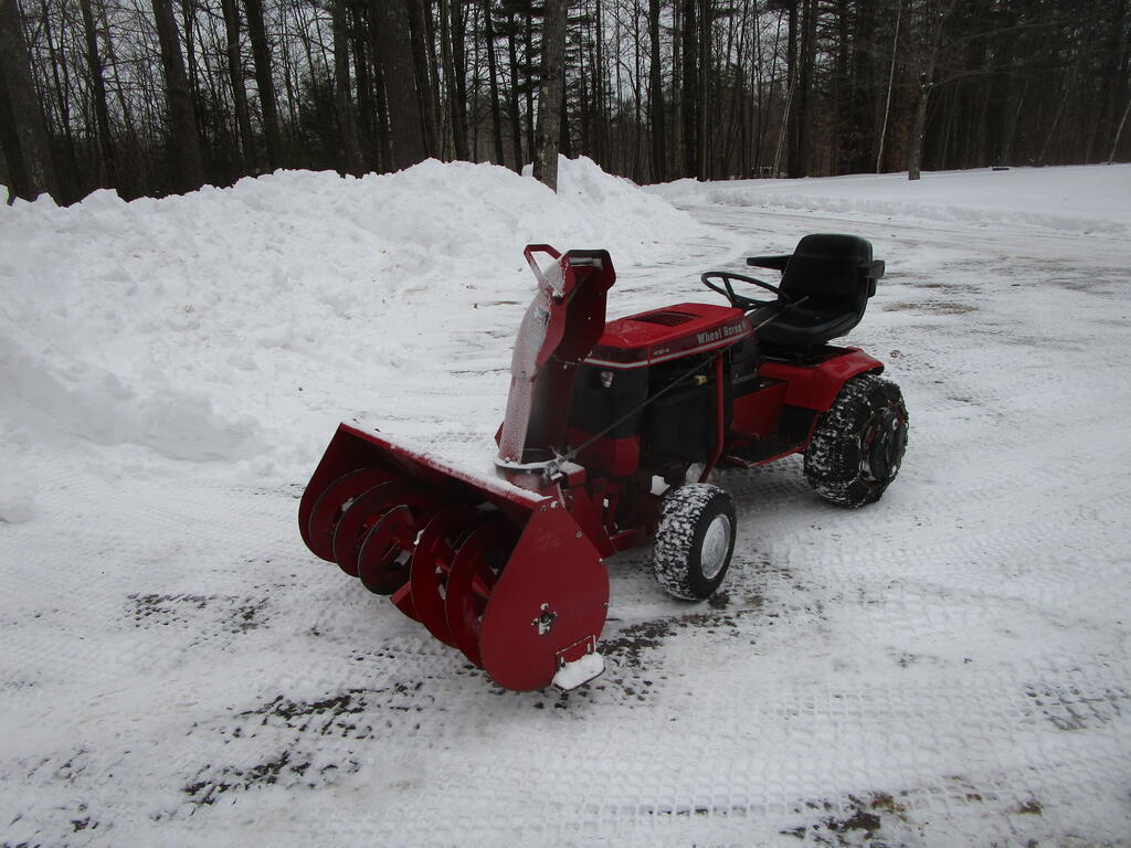

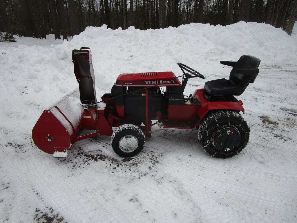

c-series don 11,941 #5 Posted May 1, 2022 (edited) I have a two stage on a 417-A and I must say that thing is unbelievable! We had almost two feet of snow a few years ago and that thing was so impressive that I went and did my neighbors driveways because I was enjoying it so much. They didn’t need it done because they are only here in the summer! I hear it’s a PITA to take on and off but I put it in once and it is now my dedicated snow blower. If I had to take it on and off I may opt for a single stage. Note my F-350 with 8’ Fisher plow and sander in the background that I could use for this task, but this is way more fun! I use the truck for my snowplowing business. Edited May 1, 2022 by c-series don 3 3 Share this post Link to post Share on other sites

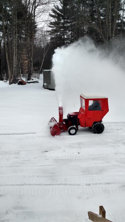

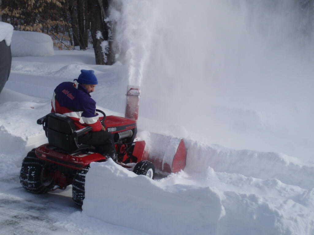

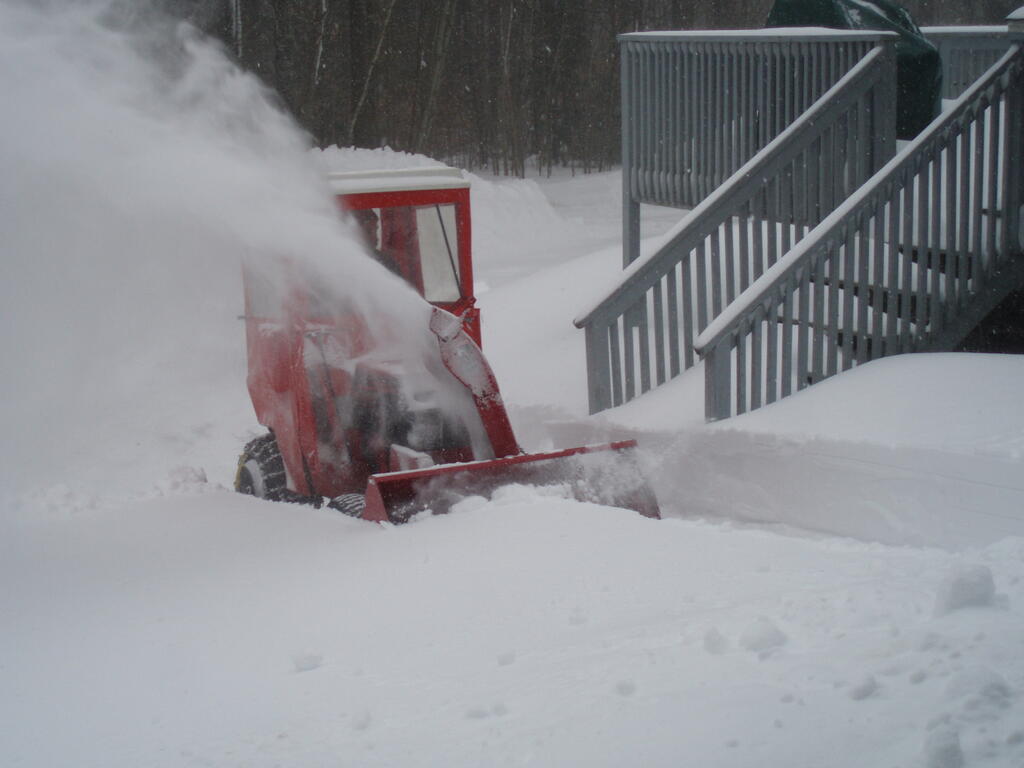

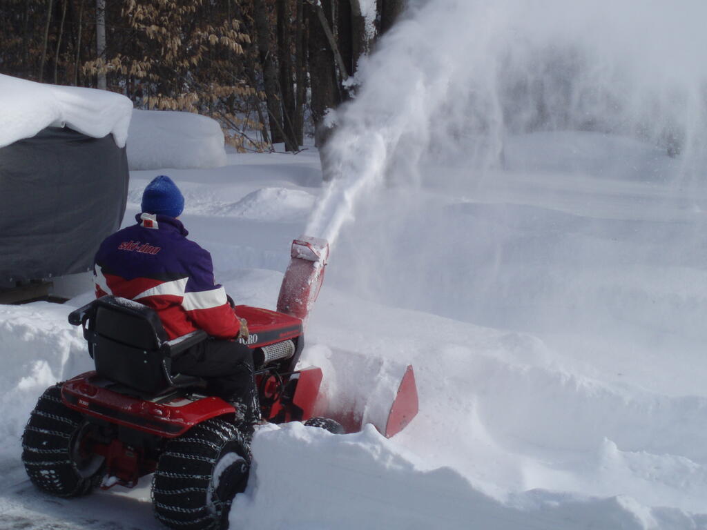

Dfbittner 21 #17 Posted May 1, 2022 9 hours ago, JCM said: Yes the 2 Stage will fit. That Tractor and blower will take on any snowstorm you can throw at it. However, the 520 with gear reduction steering does steer a little easier. Lived in Danvers for 50 years . @Dfbittner Awesome pics. I need to clean mine up and repaint some areas. Mostly cosmetic stuff. I like that seat! Mine is destroyed, there is a seat upholstery place that I frequently pass by that I’ve thought of checking out but I like the armrests on yours. Nice looking setup. 2 Share this post Link to post Share on other sites
JCM 11,153 #18 Posted May 1, 2022 @Dfbittner Moved to Maine in 2008 from Danvers. This September we are having our 4th annual Meet & Greet and you are invited. 63 miles from Danvers. Check out info under Red Square Herd or send me a PM for more info. Pictures of my 520-H just to keep you interested in the 2 stage blower. 3 3 Share this post Link to post Share on other sites
