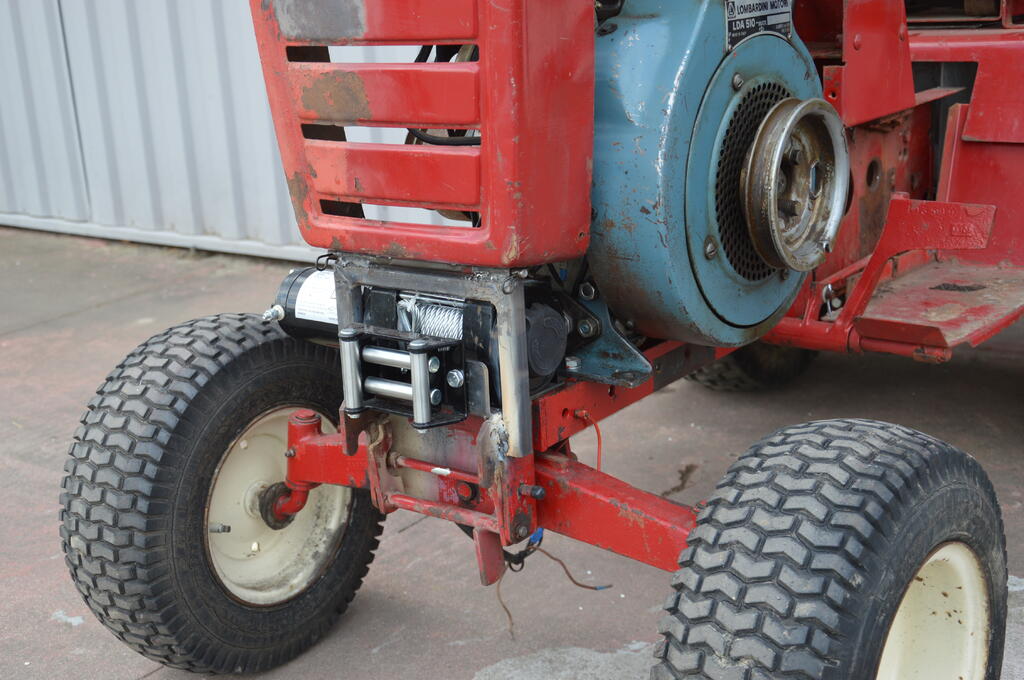

Kenneth R Cluley 712 #6 Posted April 30, 2022 Saw a thread here recently (picture) with a winch mounted in a "bumper" mounted to front of tractor, used the holes in frame that attach a matic mounted to. Will look for it. 2 Share this post Link to post Share on other sites

davem1111 2,432 #10 Posted May 1, 2022 I have a Badland 2000 Winch that I bought a while back to get a (small) dead car onto a trailer. I just rigged it up with some eye hooks and a chain to attach it to the head of the trailer - worked pretty well in spite of a frozen brake drum. Anyway, I recently bought a new welder, and one of the first projects that came to mind was mounting the winch on one of my tractors. I think what I'd like to do is make a bracket that will attach to where the mule drive attaches (is that called "Attach-A-Matic" or is that just the underside attachment?). It seems like it would be pretty simple, as it just needs a bracket either bolted to or welded to a long enough bolt or round steel stock to fit in there, and a part to brace it at the bottom. Has anyone done something like this? I'm guessing that somehow adding a larger battery is a good idea for winch use also. Thanks! 1 Share this post Link to post Share on other sites
