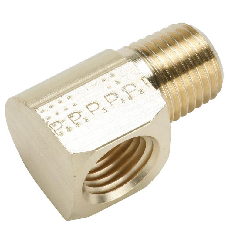

Bill D 3,158 #4 Posted April 28, 2022 i just put a 3/8" street 90 in my Kohlers. 3 1 Share this post Link to post Share on other sites
Craig-906 28 #5 Posted April 28, 2022 (edited) 3 hours ago, Bill D said: i just put a 3/8" street 90 in my Kohlers. Don't always think of a street, that would be perfect in this instance. Edited April 28, 2022 by Craig-906 1 Share this post Link to post Share on other sites
WHX?? 58,214 #6 Posted April 28, 2022 If you can use a brass one Craig is keeps it tighter to the motor. 3 Share this post Link to post Share on other sites

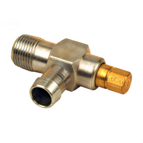

lynnmor 9,042 #8 Posted April 28, 2022 Something else to consider is a drain valve such as this. 2 Share this post Link to post Share on other sites
Bill D 3,158 #9 Posted April 28, 2022 (edited) On 4/28/2022 at 2:31 PM, lynnmor said: Something else to consider is a drain valve such as this. I like that. I may have to change out my street elbow. Edited April 30, 2022 by Bill D 1 Share this post Link to post Share on other sites
