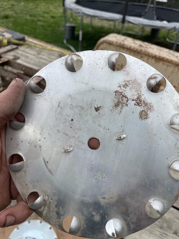

Michaelbailey 1 #1 Posted April 27, 2022 I'm looking for someone that can tell me what the numbers on the planter plates or for and which plate goes for what 1 Share this post Link to post Share on other sites
953 nut 68,484 #2 Posted April 27, 2022 (edited) On the Case planter we had the number told you how many seeds per foot it would plant. think there were some letters that gave the size of the cell so one seed would be in each cell, can't remember for sure. Edited April 27, 2022 by 953 nut Share this post Link to post Share on other sites
oliver2-44 11,694 #3 Posted April 28, 2022 @Michaelbailey Tell us what planter you have and if possible show us some pictures of the planter and plates. Share this post Link to post Share on other sites
Michaelbailey 1 #4 Posted April 28, 2022 I have a wheel horse 67-01pt01 one row planter. Here is one of the plates Share this post Link to post Share on other sites
gwest_ca-(File Mod) 12,451 #5 Posted April 28, 2022 Info that came with a Simplicity planter. Do not know who the manufacturer was. G-12 is in the chart. 1 Share this post Link to post Share on other sites
