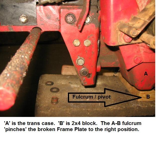

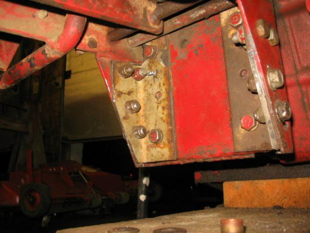

daveoman1966 3,884 #4 Posted April 25, 2022 Agreed... the Frame Plate is a weak point in design. Instead of cut-trim-weld, I've repaired several of these with 1/4-3/16" 2x2 angle iron drilled and fitted to the frame flate...which also reinforces the corners. No welding required...optional though. Here is the .pdf narrative..with pics.. of how to make the 'fix'...without welding. MODERATOR... At your leisure, post this file in the Wheelhorse Form manual...whereever you see fit. WHEELHORSE FRAME PLATE FIX.pdf 4 2 2 Share this post Link to post Share on other sites

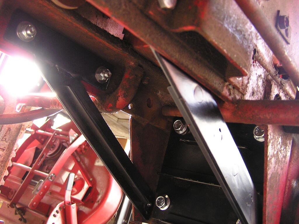

Lee1977 7,709 #6 Posted April 26, 2022 There are some of us that add braces to the frame. I haven't broken one but I have added some plates and braces to all three of mine. 3 3 Share this post Link to post Share on other sites
ri702bill 12,475 #7 Posted April 26, 2022 8 hours ago, Lee1977 said: There are some of us that add braces to the frame... That would be me, too. I took a different approach on this C81 - all the parts are bolt-in and removable. Bill 4 Share this post Link to post Share on other sites
