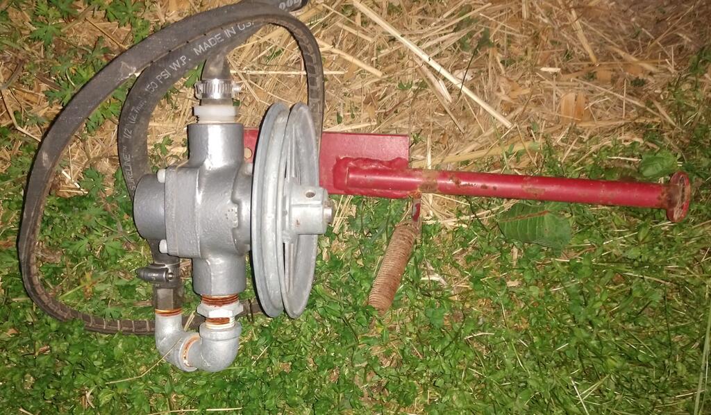

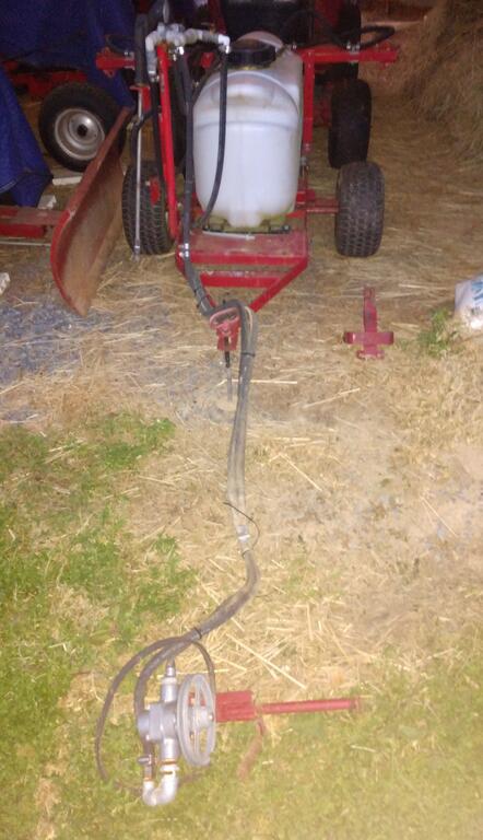

kpinnc 19,006 #9 Posted April 25, 2022 (edited) Hypro still sells roller pumps. I have one set up on my sprayer so it connects to my 310-8. I run it about 1/2 throttle with a 7-ish inch pulley. Hooks up like the tiller idler setup. https://www.tractorsupply.com/tsc/product/hypro-8-roller-cast-iron-sprayer-pump Edited April 25, 2022 by kpinnc Share this post Link to post Share on other sites
kpinnc 19,006 #10 Posted April 26, 2022 On 4/24/2022 at 9:37 AM, oliver2-44 said: To spray 30 ft high I will need a minimum of 60 psi plus a little more for system losses, so I probable need a pump that will do 75-100 psi. then there is the GPM flow question. I don't know what the GPM on my setup is, but it makes about 125 psi. My tank is 27 gallons, and with the arms folded out and all nozzles spraying, it goes in about an hour, maybe less. My tank has a bypass on it, so I can't even make a decent guess. Mine is a Hypro silver (stainless) 4 roller pump. The 6 and 8 rollers are likely higher GPM. I made a bracket so my pump mounts in the belly hitch, and the weight of the pump holds belt tension. It works very well, though I don't run the tractor over 1/2 throttle. 1 1 Share this post Link to post Share on other sites
oliver2-44 11,782 #11 Posted August 6, 2024 I'm still needing to rig up a sprayer. I know you use the tank spray arms, but if you have a hand spray wand could you post a picture of it? On your pump mount, what do you connect the other end of the spring to? Thanks for your assistance. I'd also appreciate any comments from someone that has pump/sprayer design experience. Share this post Link to post Share on other sites
