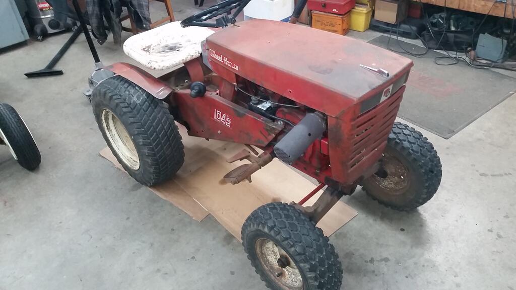

Wheelhorse#1 1,996 #28 Posted April 25, 2022 Nice 1045.She looks to be in good original shape too.Thank god the PO didn’t go nuts with the ole rattle can over everything like so many do. 2 Share this post Link to post Share on other sites

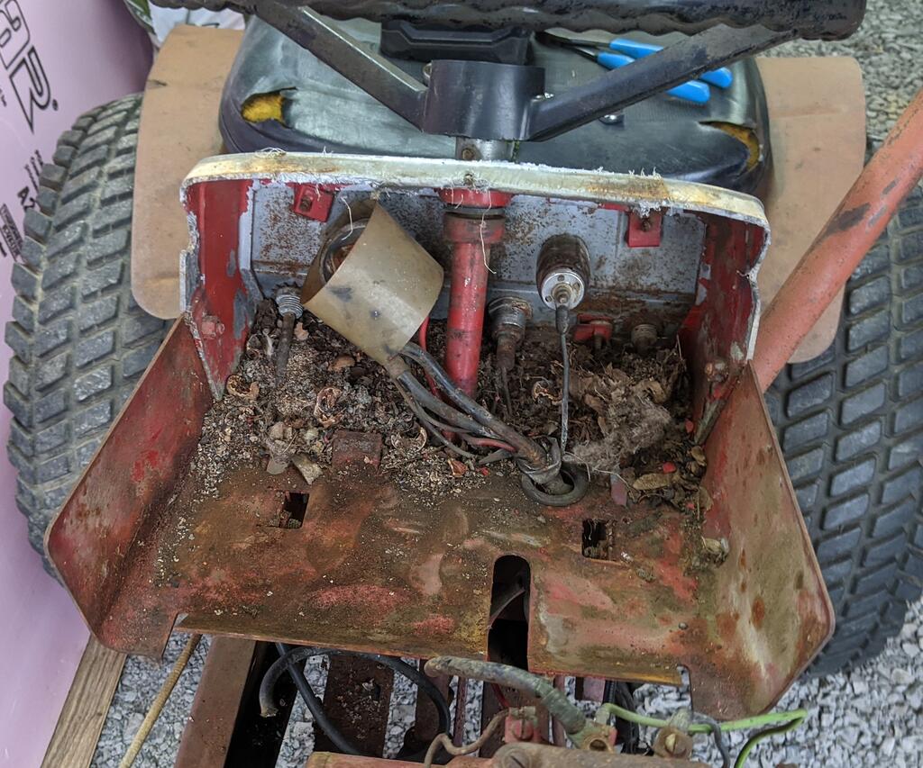

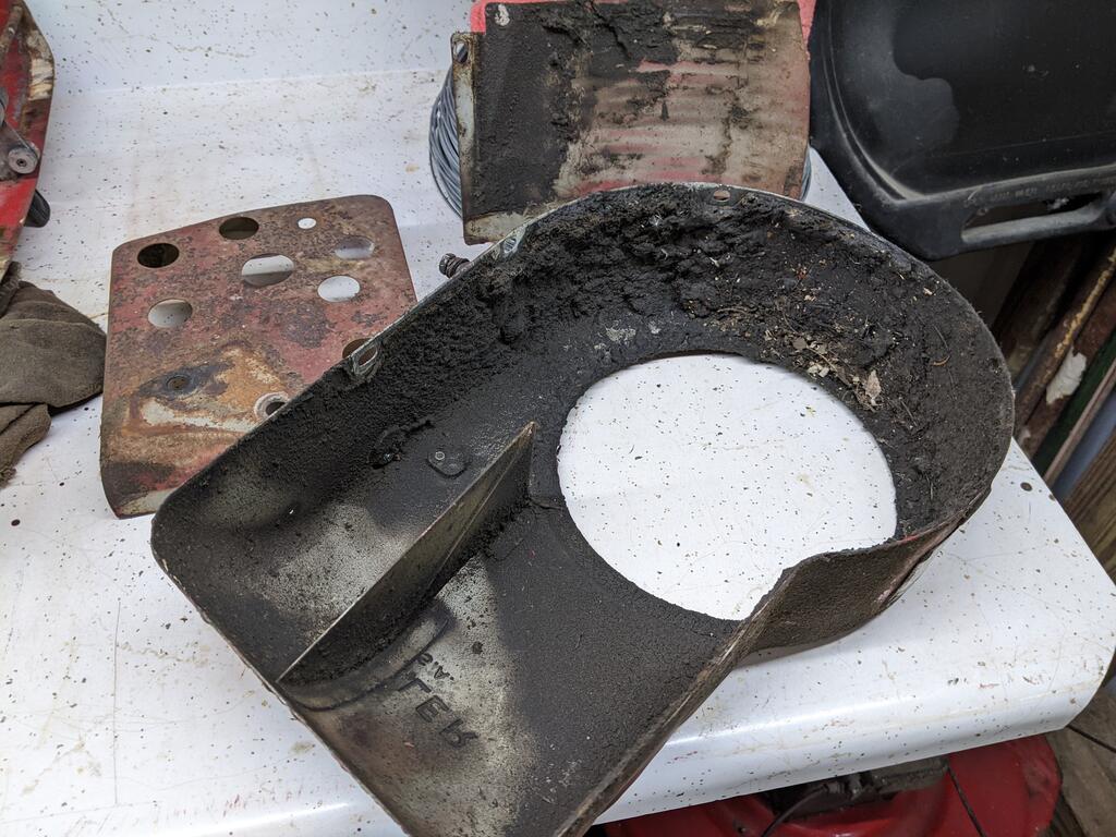

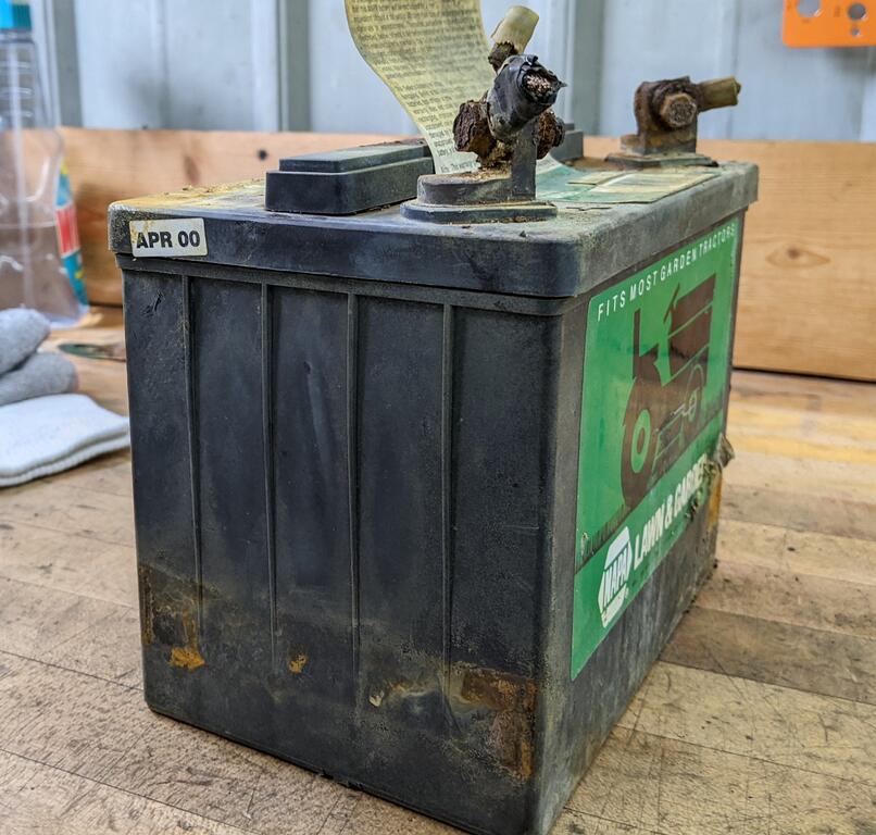

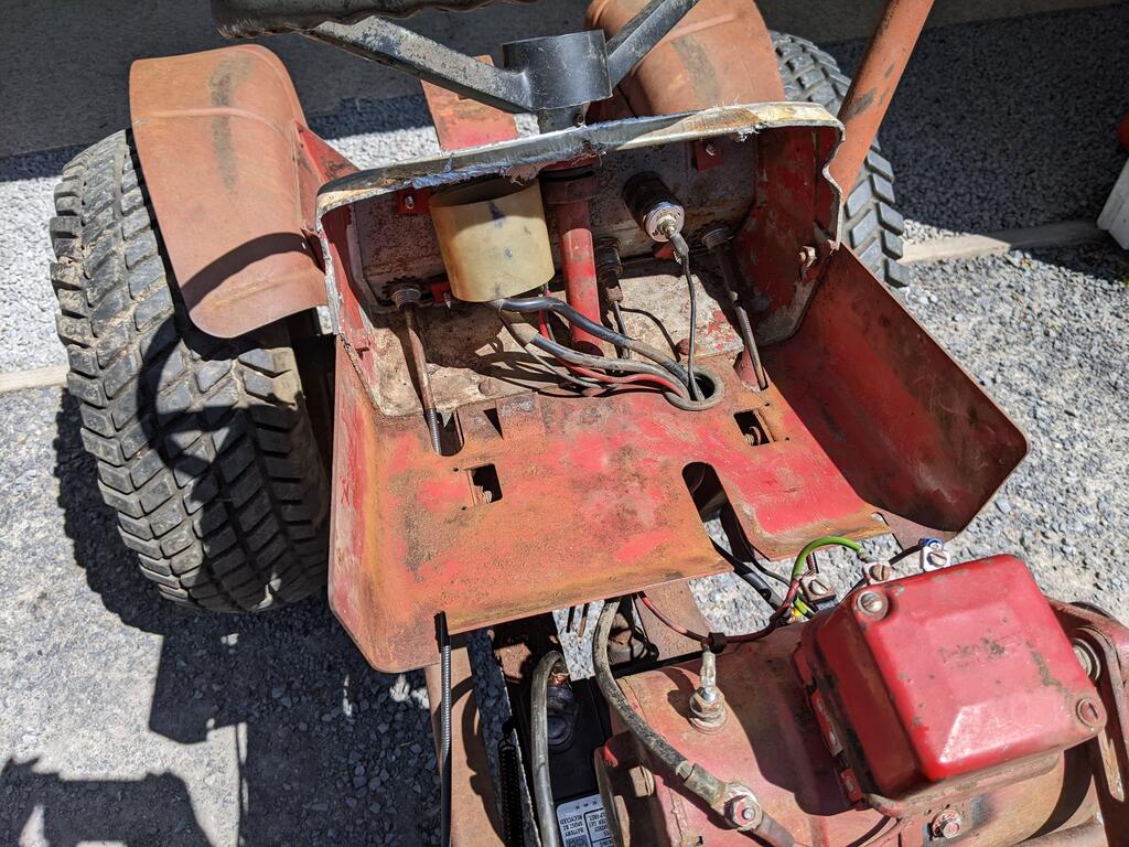

rjg854 13,341 #34 Posted April 27, 2022 The weather's on the cool side today so I decided to dig into this tractor a little bit and start taking things apart and seeing just how dirty it is. Of course the oil is pretty black, but it was up to the proper level. Not all that bad, I've seen worse, at least it wasn't packed full. I don't know why the battery won't hold a charge. 2 6 Share this post Link to post Share on other sites

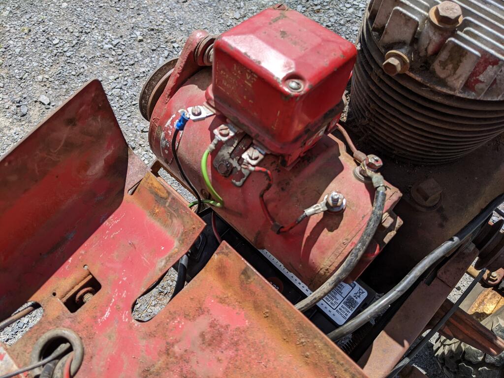

squonk 48,076 #35 Posted April 27, 2022 Nice! You won't have to make the switch shield out of a milk jug! Put new ends on with dielectric grease! 5 Share this post Link to post Share on other sites
ebinmaine 80,649 #36 Posted April 27, 2022 I don't suppose those Napa batteries carry a 22 year warranty? 5 Share this post Link to post Share on other sites
rjg854 13,341 #37 Posted April 27, 2022 11 minutes ago, squonk said: Nice! You won't have to make the switch shield out of a milk jug! you saw that redneck repair on the Raider Some people will do anything to get the job done. 2 Share this post Link to post Share on other sites
rjg854 13,341 #38 Posted April 27, 2022 15 minutes ago, ebinmaine said: I don't suppose those Napa batteries carry a 22 year warranty? We'll have to ask our resident Napa counter jobber Shout out to @squonk 2 Share this post Link to post Share on other sites
squonk 48,076 #39 Posted April 27, 2022 12 minutes ago, rjg854 said: you saw that redneck repair on the Raider Some people will do anything to get the job done. I think @Achto did the same. That's where I got the idea for my 1075 6 minutes ago, rjg854 said: We'll have to ask our resident Napa counter jobber Shout out to @squonk Batteries are prorated. After 22 years you get a penny off of list price. 7 Share this post Link to post Share on other sites

rjg854 13,341 #45 Posted April 30, 2022 Well it's been a fun 3 days. I took everything apart as you know, a lot of cleaning of the tins and fins on the engine. Rebuilt the carburetor, cleaned out the gas tank, changed the sediment bowl over to a petcock, new fuel lines and an inline fuel filter. Went through the wiring, cleaned all the connections, changed what ends needed changed put new ends on the battery cables and just made sure that everything was nice and solid. Surprisingly most of the old wiring is still in good shape. The lighter is still there and it even works. It started fairly easy, a little fiddling with adjustments and it smoothed right out and runs sweet. I want to add a shout out to Dan @Achto for his suggestion on how I could fix a dog point screw that would work on this transmission. I was told the transmission was no good but she runs and drives and all gears work as they should. I just need to go through the rest of the functions of the tractor at some point. I've got a kitchen remodel I want to start this coming Monday and that'll have to take precedent. 2 9 Share this post Link to post Share on other sites
