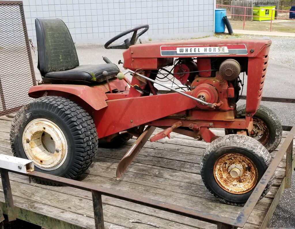

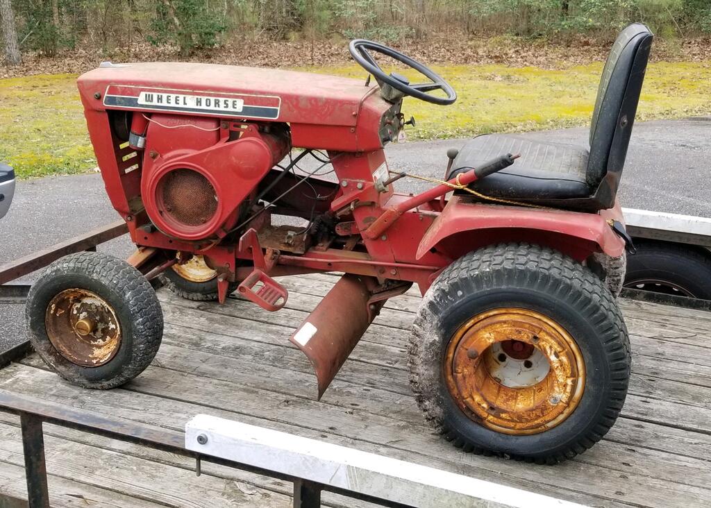

Fishroe 261 #1 Posted April 20, 2022 (edited) Motor is locked up dont know anything about a 1057 Edited April 20, 2022 by Fishroe 1 Share this post Link to post Share on other sites
Achto 32,639 #2 Posted April 20, 2022 1057 is a good stout tractor. 10hp with a 3 speed tranny. The tractor in your pics has 2 price increasers on it. Rear wheel weights = $150 - $200 for the pair. Center blade = $200 - $300 maybe a little more. These are sought after. In my area maybe $100 for the rest of the tractor. Prices may differ in other areas. 7 Share this post Link to post Share on other sites

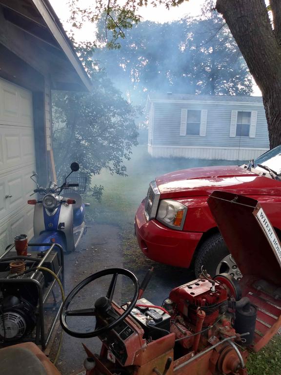

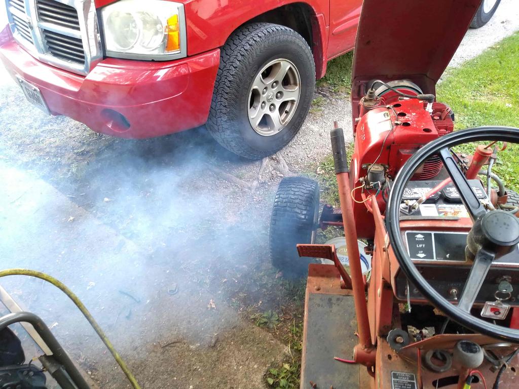

Achto 32,639 #4 Posted April 20, 2022 (edited) 1 hour ago, Fishroe said: Motor is locked up Pull the spark plug out, fill the cylinder with transmission fluid, put the plug back in and leave it sit for a few days. Pull the plug back out before trying to turn it over. Might need to use a pipe wrench on the pulley to turn it, don't force it too hard. It will most likely break free. If not, let it sit a little longer & try again. Once it breaks free, spin it to get the tranny fluid out of the cylinder, change the oil clean the carb/fuel system & I bet it will run. This tractor was locked up when I bought it. Went through the above procedure's and have been using it ever since. PS, your neighbors will love it the first time that you fire the tractor up after this procedure. It took a couple minutes for it to completely clear out. Hasn't smoked since. Edited April 20, 2022 by Achto 1 2 1 2 Share this post Link to post Share on other sites
WHX?? 58,076 #5 Posted April 20, 2022 2 hours ago, Fishroe said: dont know anything about a 1057 Not much to know. 1967 & little bro to a 1067 & a very capable tractor. Bullet proof transmission & very easy to work on. I'd flash 400 in green backs at him for the whole rig and have it loaded and before he come to his senses and knew what hit him. If that's the one the guy is askin 250 for I'd be all over that fer sure. Basically buying the weights & blade and getting the tractor for free. Like Dan said that locked up motor wouldn't bother me abit it's a Kohler. Just my 4 Share this post Link to post Share on other sites
ebinmaine 80,651 #6 Posted April 20, 2022 1 hour ago, Achto said: Rear wheel weights = $150 - $200 for the pair. Center blade = $200 - $300 maybe a little more. These are sought after. In my area maybe $100 for the rest of the tractor 'Round these pahts the weights are about the same, mid mount grader blade is easily $300. Tractor maybe $200. $700 sitting there. Easy. 3 Share this post Link to post Share on other sites
WHX?? 58,076 #7 Posted April 20, 2022 1 minute ago, ebinmaine said: Tractor maybe $200. Nawww 100 tops being non runner. I don't make up these rules I just follow them .... well maybe I do.... but the seller doesn't have to know that. 1 5 Share this post Link to post Share on other sites
Fishroe 261 #8 Posted April 20, 2022 (edited) I got the grader blade for 225 thats what I really needed he wanted 200 for the weights Offered 150 Wouldnt take it could’ve gotten the tractor and weights for 350 I didn’t know whether the motor needed rebuilding or what else could’ve needed replacing. I just bought my 2nd 414-8 several weeks ago. Grader blade going on it and plow blade is on the other one. Cool looking tractor though Edited April 20, 2022 by Fishroe 5 1 Share this post Link to post Share on other sites
