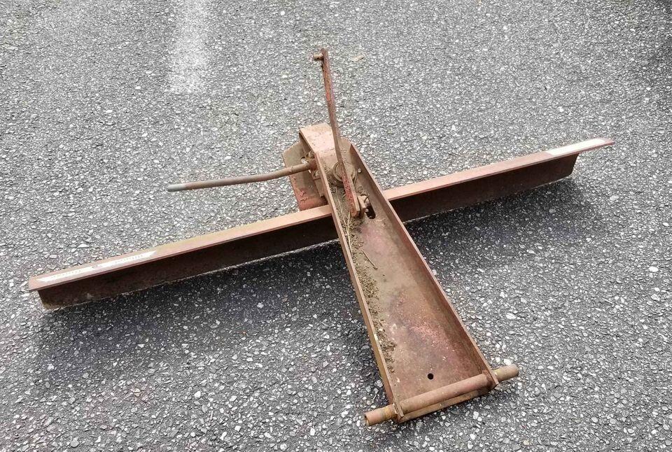

Fishroe 261 #1 Posted April 20, 2022 Found this for sale 40” says it came off a 1057 Will it fit on my 414-8 Are all the parts there for it Also how do you change the angle asking 250 1 Share this post Link to post Share on other sites
rjg854 13,309 #2 Posted April 20, 2022 (edited) Yes, it appears to be all there, that small handle at the back of the blade is how you change the angle. I'm not familiar with the 417 model, but I don't see why it wouldn't fit, most anything is interchangeable. Edited April 20, 2022 by rjg854 add 2 Share this post Link to post Share on other sites
WHX?? 57,794 #3 Posted April 20, 2022 (edited) It should fit if you have the mid mount attach. Might need a different lift lever depending on the tractor rockshaft. Not familiar with a 414's. Angle is changed by the lever sticking out the side. Lift it up move the blade then lock it back down. Has three positions. Price is somewhat fair as these are a desirable implement and getting harder to find. I have seen them sell for upwards of 300. Edited April 20, 2022 by WHX?? 3 Share this post Link to post Share on other sites
squonk 47,887 #4 Posted April 20, 2022 Yes it will fit. I had the exact same blade on a 701,704,857,1267,C-160 and 520H 1 1 Share this post Link to post Share on other sites
