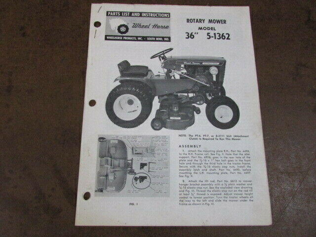

chdinct 28 #5 Posted April 19, 2022 15 minutes ago, gwest_ca said: If you click on the fuzzy picture in the link a page should come up with this on it Drive belt 1563 (1/2" x 39") [1587 in belt chart is wrong] Spindle belts 1578 (3/8" x 37" matched pair) Thanks Gwest. I downloaded your IPL and blew it up and can see the idler pulley and associated parts. I have new deck belts but would need the drive belt once I find the correct idler pulley. I did find this pic on ebay finally, which appears to show my combo tractor (or close enough) with the 36 rear discharge deck and can make out an idler pulley just in front of the foot peg. Share this post Link to post Share on other sites

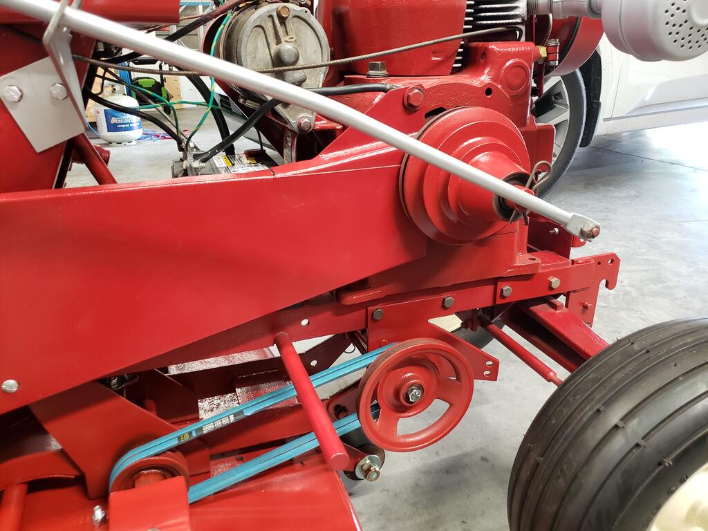

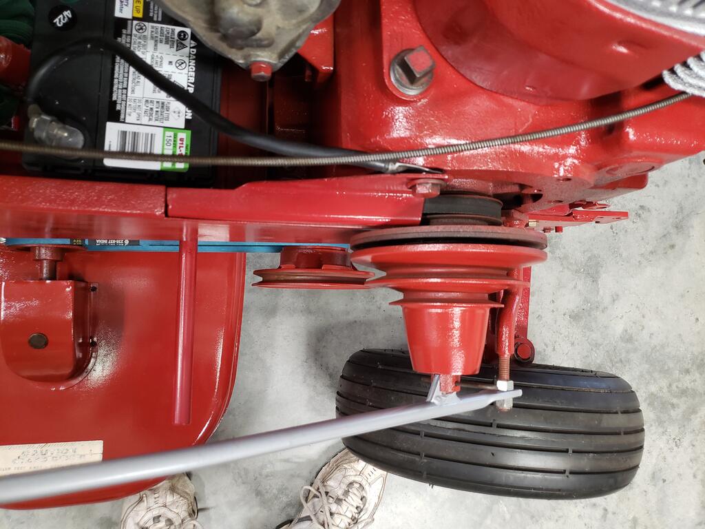

gwest_ca-(File Mod) 12,510 #6 Posted April 19, 2022 This recent thread shows some of the pieces you need. Common on all gear driven rear discharge decks. 1 Share this post Link to post Share on other sites
