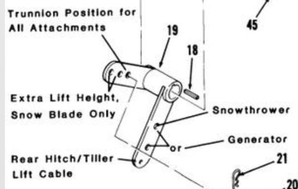

Handy Don 15,384 #9 Posted September 30, 2022 (edited) 2 hours ago, PapR's312-8 said: I cannot remember off the top of my head if there are different holes for the trunnion on the adjustment nut end. Based on what I'm reading, I'm doing things correctly. I just cannot get the rubber stops to touch the bottoms of the foot rests after tightening the trunnion. The trunnion holding the eyebolt, when used for deck lifting, goes into a specific hole on the rock shaft arm. Putting it elsewhere messes with the geometry of the lift action. The correct hole is the one closest to the rock shaft on the upper arm, the "all attachments" position as seen here: I'm not clear on whether your deck is hitting the bottom of the footrests before the lift arm reaches its locked position OR your lift arm is reaches the locked position but the deck bumpers have not hit the footrests. What @Lee1977 mentions is valid. It is a tricky adjustment. I've noticed that there is a slight "hump" in the lifting action where as the lift arm "locks" it drops the lift action very slightly from just before it locked. If the rubber bumpers are no longer flexible, then they cannot "squish" a bit at max lift and still touch the footrest when at locked lift. The lift chain should be slack when the deck is down on the gage wheels (it needs room to let the deck follow a dip in the lawn). Depending on how high you've set the cut, you'll feel the slack come out of the chain sooner for lower settings and later for higher settings. I'll guess the lever may move several inchs before it runs out of slack! Edited September 30, 2022 by Handy Don Share this post Link to post Share on other sites

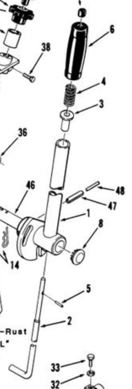

Handy Don 15,384 #11 Posted September 30, 2022 (edited) 56 minutes ago, PapR's312-8 said: Then I have to back off the adjustment of the lift chain This is clearer. You are experiencing the normal situation where the bumpers are no longer pliable enough to absorb the lift motion over the "hump". On mine I was able to tweak it to get only about 1/4" of "looseness" but my bumpers still have a bit of flex to them. If you are still having the deck slip out of the "locked" position, then you'll have to go over the mechanism and look for worn bits. One relatively common issue for tractors stored outdoors without protection is for the spring (#4) within the arm to rust and, potentially, weaken. Edited September 30, 2022 by Handy Don 1 Share this post Link to post Share on other sites
