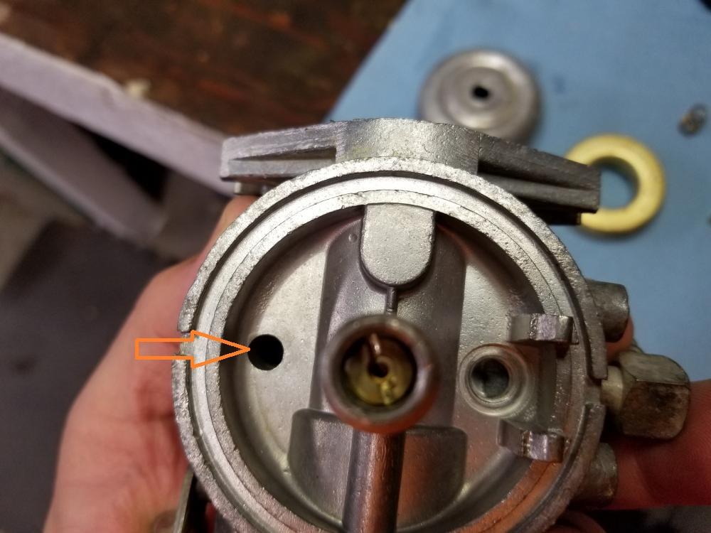

OutdoorEnvy 1,817 #1 Posted April 15, 2022 So I cleaned and rebuilt the carb on my k241s with a genuine Kohler kit 25 757 02. I have done numerous carb rebuilds on small engines over the years and feel like I'm missing something. Gas floods bad from it. Which usually means bad needle and seat, bad float, or bad bowl gaskets. It passes the blow test with the float pressed up into full position. The float floats in water without sinking or filling with water. It moves up and down as freely as you could ask. I used the bowl gasket in the kit. It is as tight as I'm comfortable turning it. It is all the way in without just breaking something. I took the carb apart again just to redo and recheck needle and seat, float, gaskets all looked fine. What am I missing that would still have a mass flooding? something that seemed odd to me is the kit didn't come with a needle that had the rubber tip. It was just brass on brass. But it passed the blow test fine. Do the newer kits not have a rubber tipped needle anymore? Thanks for you help! 1 Share this post Link to post Share on other sites

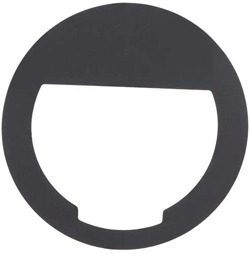

tunahead72 2,645 #2 Posted April 15, 2022 This is kind of an educated guess... I wonder if you might have used the wrong kit. My C-105 with a K241S uses kit number 25 757 01. According to OPE Engines and Repair Clinic, the seat included with the "01" kit has a taper on the bottom, while the "02" seat is flat on the bottom. I don't know why that would make a difference, but everything else in those two kits seems to be the same, including rubber-tipped needles in both. And OPE Engines says the "02" kit is for the K582 engine, but doesn't mention the K241. Do you see a part number on the mounting flange of your carb? Or do you have a spec number for your engine? Either of those might help. Also, you mentioned your float floats in water, but did you try submerging it in gasoline to see if it leaks? And did you install the baffle gasket that was included in the kit? 1 Share this post Link to post Share on other sites
Bill D 3,101 #3 Posted April 15, 2022 The kit had the wrong needle in it. Metal on metal will never seal in this type of application due to engine vibration. Also, did you install the small gasket under the seat body? If your old needle looks decent try installing it with the new seat and see what happens. 4 Share this post Link to post Share on other sites

OutdoorEnvy 1,817 #7 Posted April 15, 2022 Thanks for the suggestions folks! The carb is C-236315. I feel kind of silly now...so turns out the bowl has a few little holes the bottom. When I cleaned it out I noticed a little pitting but have seen that lots of times. Didn't notice any holes but didn't hold it up to the light either... Will do that from now on just to be sure. So how do you get just a bowl? I'm wondering if I'll have to order an aftermarket carb and hope the bowl is a direct fit to the original carb. Any suggestions? 1 Share this post Link to post Share on other sites
