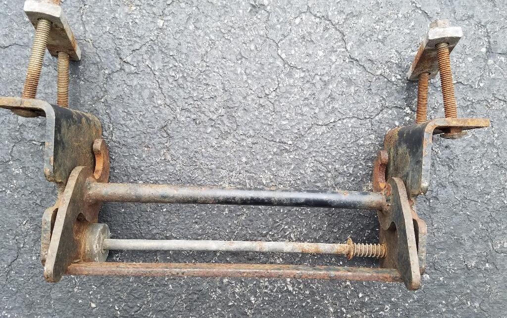

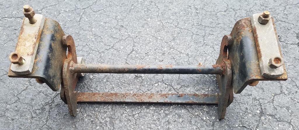

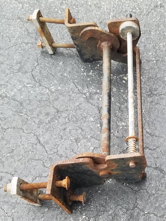

Brockport Bill 2,371 #1 Posted April 14, 2022 (edited) See photos -- Can someone tell me what part number unit this is and what model WH it is used on -- it looks sorta like my typical rear axle bracket ( for plow frame hook up ) for 300, 400 series etc -- but obvioulsy different design -- or is it a center mount attachomatic for under frame? thanks Edited April 14, 2022 by Brockport Bill Share this post Link to post Share on other sites
8ntruck 8,916 #2 Posted April 14, 2022 I'll guess that it is a front Tach-Matic. 1 Share this post Link to post Share on other sites
WHX?? 56,631 #3 Posted April 14, 2022 Axle bracket says it's for the rear. Tiller maybe? Share this post Link to post Share on other sites
gwest_ca-(File Mod) 12,254 #4 Posted April 14, 2022 Looks like it may be for the rear of a 5xi 2 Share this post Link to post Share on other sites
Brockport Bill 2,371 #5 Posted April 14, 2022 3 minutes ago, gwest_ca said: Looks like it may be for the rear of a 5xi thank you, thank you - you folks are amazing resource of info - - it looked strange to me and certianly different than my rear axle bracket for my 312 -- thanks !!!!!!!!! 1 Share this post Link to post Share on other sites
Pullstart 70,022 #6 Posted April 14, 2022 Do you have a use for it? Any interest in a trade at the Big Show? Share this post Link to post Share on other sites
Brockport Bill 2,371 #7 Posted April 14, 2022 50-50 on able to get to show...I am not really wh trader type......my grandson is visiting next week for spring break so planned for him to clean up rust and paint it.......then post for sale.....If you want to make dollar offer I'll certainly consider it....i sold a few traditional wh axle brackets this winter for $70 all reconditioned. I dont know value of Toro bracket like this? Share this post Link to post Share on other sites
Damien Walker 297 #8 Posted April 12, 2023 Definitely a 5xi rear axle Attach-a-Matic...used for the Bulldozer and Tiller etc. It is a more modern version of the one used on C/300/400/500 series and fits these as well. I have two of them...one on my C121 and the other on my C175. Why? Because the correct part was no longer available! The 5xi part is possibly better in that it is a single unit so the spacing between sides is already set and the latch mechanism works as one and latches into place as per a front or mid Attach-a-Matic I have recently acquired the correct hitch for my 518H and I am contemplating either swapping things around or just buying another of this new type (assuming they are still available). Share this post Link to post Share on other sites
