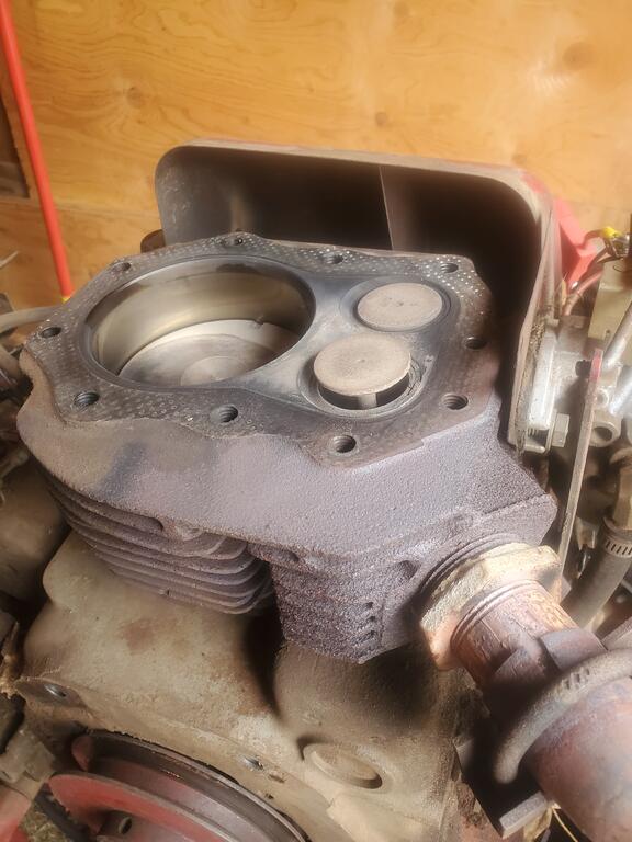

RJR49 179 #26 Posted April 17, 2022 A new Head Gasket is on order. I'll check the points, and valve clearance before I put it back together. NAPA doesn't have the Helicoil kit but there's an AutoZone nearby. Back to Ebay if they don't have it. FYI NAPA wanted $23.00 for the gasket and $27.00 for shipping. Ebay was $13.00 including shipping. They claim genuine Kohler. We'll see. Share this post Link to post Share on other sites

RED-Z06 2,720 #32 Posted April 21, 2022 Either loose plug or over tightened last time and pulled the threads, see both alot, from saws to cars, and everything inbetween, i don't even typically pull the heads to fix it, i make sure the piston is down, grease up the thread resizer, go about half and pull it out, brake kleen it then grease it again then finish...put the insert in, set it with a hammer and put in a new plug. Valves, running rich or lean...won't cause this. Share this post Link to post Share on other sites
Snoopy11 5,731 #33 Posted April 22, 2022 17 hours ago, RED-Z06 said: i don't even typically pull the heads to fix it I don't recommend this method. Any little metal flake can go down into the piston, and scar the cylinder wall. Then you have much bigger problems. Not worth the risk. 17 hours ago, RED-Z06 said: Valves... won't cause this I beg to differ. Ask any mechanical or performance expert, one of the causes of spark plug blowout (ejection) is excessive cylinder pressures which are caused by valve train mechanical issues... (i.e.) exhaust valve not opening adequately. Ordinarily, it happens when engines are at operating temp and at full running governor RPM. Yes, it can cause this. I haven't personally ever used heli-coil fixes. I have always seen it as more of a ghetto bandage. I usually buy new cylinder heads if anything happens to the spark plug threads, if possible. However, if the other engine guys on the forum say that the heli-coils work, I stand behind that. Don Share this post Link to post Share on other sites
lynnmor 9,012 #34 Posted April 22, 2022 4 hours ago, Snoopy11 said: I haven't personally ever used heli-coil fixes. I have always seen it as more of a ghetto bandage. I usually buy new cylinder heads if anything happens to the spark plug threads, if possible. However, if the other engine guys on the forum say that the heli-coils work, I stand behind that. I did a fair amount of work for NASA in my shop. Every tapped hole in anything had to have Heli-Coil type of inserts. If it is good enough to go to the moon, it will be good enough for your tractor. 5 Share this post Link to post Share on other sites
RED-Z06 2,720 #35 Posted April 22, 2022 4 hours ago, Snoopy11 said: I don't recommend this method. Any little metal flake can go down into the piston, and scar the cylinder wall. Then you have much bigger problems. Not worth the risk. I beg to differ. Ask any mechanical or performance expert, one of the causes of spark plug blowout (ejection) is excessive cylinder pressures which are caused by valve train mechanical issues... (i.e.) exhaust valve not opening adequately. Ordinarily, it happens when engines are at operating temp and at full running governor RPM. Yes, it can cause this. I haven't personally ever used heli-coil fixes. I have always seen it as more of a ghetto bandage. I usually buy new cylinder heads if anything happens to the spark plug threads, if possible. However, if the other engine guys on the forum say that the heli-coils work, I stand behind that. Don Most heads are aluminum, most cylinders are iron/steel, you arent going to get a scar from a softer metal..remember that the rings are steel, and the aluminum already run up and down the bore...it'll be fine, its the standard fix for 4.6/5.4 fords that were known to blow plugs out. Helicoils are a proven repair if done right, if you arent experienced enough to do them then i understand your reluctance to stand behind them but don't put down something you dont know much about. Ive fix stripped bar studs on saws, head bolt holes, plug holes, cylinder holes on saws, there's not much you cant fix with a helicoil/insert..in fact in some instances a helicoil is a preventative fix for bad designs...32v Northstar V8s had porous block castings and the head bolts would pull if it got hot...the fix is to drill the block and put in a timesert or keensert..the insert bites the block and prevents the bolts from pulling during torque down because the friction is on the insert. 2 Share this post Link to post Share on other sites

Snoopy11 5,731 #38 Posted April 23, 2022 18 hours ago, RED-Z06 said: it'll be fine Not trying to split hairs or scratch lilies here... but I must disagree. First of all... @RJR49 already has the cylinder head off... so it seems like he knows what he is doing. Moreover, while you may not pull the heads, pulling the heads before installing a thread insert is inarguably the best policy. There are other methods, which I will mention here... but from an engine builder standpoint... my analysis is going to be much different. If your heads are still installed, you can apply grease to the tools you are using to catch the shavings using white lithium grease. This isn't going to stop/catch all the shavings, but it is better than doing nothing. You say that this is the standard fix for a couple of Ford Engines. Further, you present that shavings and chips going into an engine is no big deal... Well... I outright knew this was wrong... but I'll pull a source just to prove it. Ford says: CAUTION: Ford Motor Company recommends removal of the cylinder head to avoid chip contamination in the engine. CAUTION: If spark plug thread repair is being done in vehicle make sure the piston is 1/3 - 1/2 way down the bore on the down stroke. This will ensure the valves are closed to help reduce contamination... Note: If procedure is being done in vehicle clean hole using a vacuum cleaner to remove debris. Lastly, it was not my intention to "put down" thread inserts... rather, from an engine building standpoint, I personally tend to replace cylinder heads rather than fix them. What I will never do is work on a cylinder head... allowing shavings to go into the engine... Don Share this post Link to post Share on other sites

RJR49 179 #42 Posted April 24, 2022 Don, thanks for the complement. I hope I deserve it. Another thought. The inserts were either to short, or to long. I didn't feel comfortable with either configuration. The short one not having enough threads, and the long one, either hitting the piston, shielding the spark, or burning the part sticking below the head. so I cut the long one flush with the head. One question. I used 400 grit emeroy cloth on a granit block to flatten the head. That took forever. 220 took less time but I didn't like the finish. Any thoughts? Share this post Link to post Share on other sites

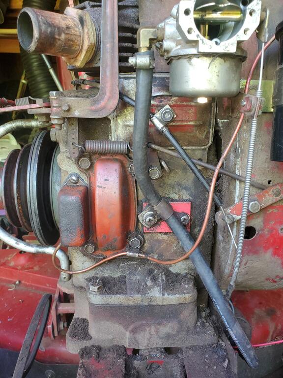

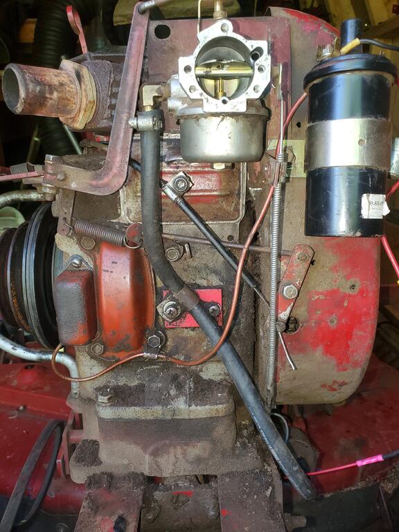

RJR49 179 #49 Posted May 10, 2022 I hate to embarass myself this way but I didn't take a picture before I disasembled everything. I believe I have it right but confirmation would be appreciated. The throttle is closed in ..58 and open in..11 Share this post Link to post Share on other sites
