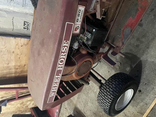

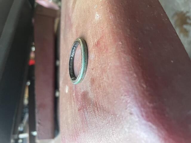

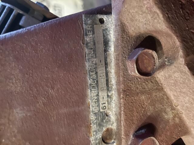

AHS 1,682 #1 Posted April 12, 2022 The B80 , my snowplow ride! It’s been leaking axle fluid out of the right rear axle tube. I tore into it, and dug out the seal with my fingers. I checked the wheel bearing by shaking the axle and no play. The # is 61-08k803-24946. I think it a 76 B80 with 1” axles. It’s time for new axle seals! Ok, I’ve done some digging, 1528 or 100823 is the axle seal number? Correct me if I’m wrong from any of the numbers! Share this post Link to post Share on other sites
ebinmaine 79,550 #2 Posted April 12, 2022 4 minutes ago, AHS said: 1” axles Did you measure that carefully? I thought those were 1- 1/8"..... Share this post Link to post Share on other sites
ebinmaine 79,550 #3 Posted April 12, 2022 Once you get the right number you can probably purchase the seal at a local auto parts store by having them cross it. 1 Share this post Link to post Share on other sites
AHS 1,682 #4 Posted April 12, 2022 13 minutes ago, ebinmaine said: Did you measure that carefully? I thought those were 1- 1/8"..... I thought so too. But it only measures 1”. 1 Share this post Link to post Share on other sites
gwest_ca-(File Mod) 12,330 #5 Posted April 12, 2022 This is the transmission listed for the 61-08K803 The 3 other 1976 models used the 5091 transmission. Only 2 8-speed transmissions used 1" axles Can you read the numbers on the lower box of the ID plate? That is the build date 1 Share this post Link to post Share on other sites

AHS 1,682 #7 Posted April 12, 2022 100863! I got two from Toro today! Bradstreets, in Brewer had them on the seals on the shelf! Not bad for a 46 year old tractor! Thanks guys! 2 2 Share this post Link to post Share on other sites
