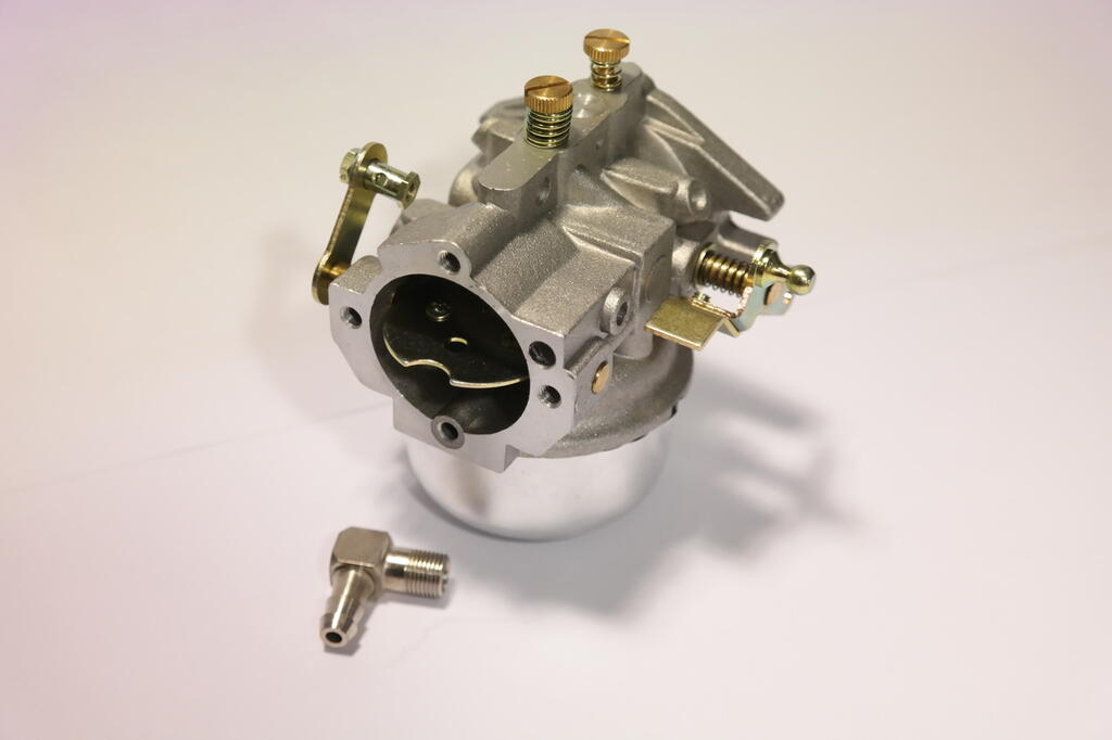

"Manic-Mechanic" 1,485 #1 Posted April 12, 2022 (edited) I think it's long overdue for a carb! I get into a stumble fit and end up cleaning & rebuilding the carb after everything else is ruled out! Then after it's rebuilt the tedious process of adjusting the jets back & forth, while simultaneously trying to keep the tractor still, all from the seat! No matter how I set hydro linkage, nor the adjustments, she'll either creep forwards or backwards, depending on her mood! I Save Tractors has this one been given great reviews, but is it truly an interchangeable parts Carb Edited April 12, 2022 by "Manic-Mechanic" 1 Share this post Link to post Share on other sites
