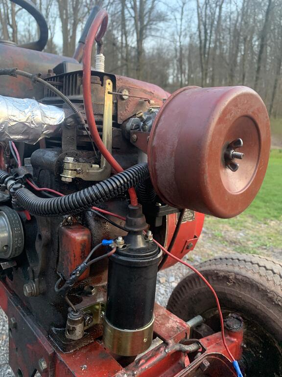

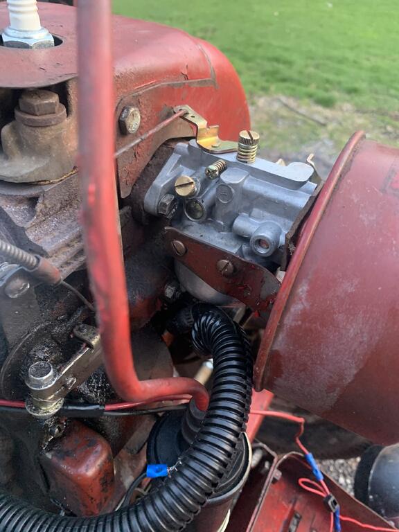

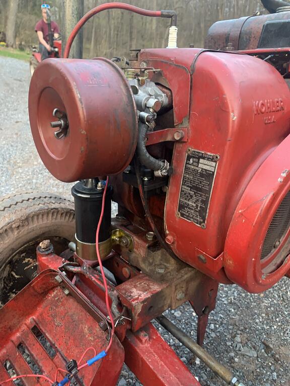

857lover 291 #1 Posted April 11, 2022 (edited) so i have my 857 and i really am not sure what to do anymore it seems to just keep dying and won’t stay running ever i replaced the coil,carb,cleaned the fuel tank, put a fuel filter on,new fuel pump and a new head gasket it will run every once in a while then die and i take the carb apart and “clean it” and then it works fine and i have no idea what’s happening i belive it’s a fueling issue it’s hard to describe in words but it seems like something you have to see with your own eyes but idk if you guys have any ideas Edited April 11, 2022 by 857lover Share this post Link to post Share on other sites

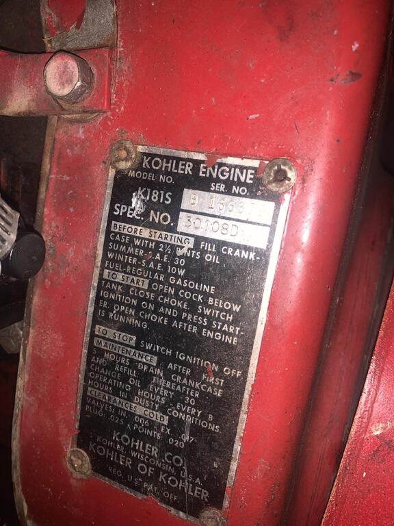

953 nut 70,325 #2 Posted April 11, 2022 Do you have a good strong spark? Have you set the ignition points? What is the spec. number on the engine ID tag? If the suffix is A, B or C you can check the timing with a timing light. If the suffix is D or higher you can use static timing to set the timing. 1 Share this post Link to post Share on other sites
squonk 48,322 #3 Posted April 11, 2022 Your condenser looks as old as the tractor. Easy thing to replace. If it fixes it great. If not, at least its eliminated. 2 Share this post Link to post Share on other sites

Wheelhorse#1 1,998 #11 Posted April 14, 2022 (edited) Could be your fuel pump.I know you said you put a new one on but I would disconnect and give a couple cranks and see if it’ pulses. Theres some crappy aftermarket stuff around rite out of the box . Edited April 14, 2022 by Wheelhorse#1 Share this post Link to post Share on other sites
