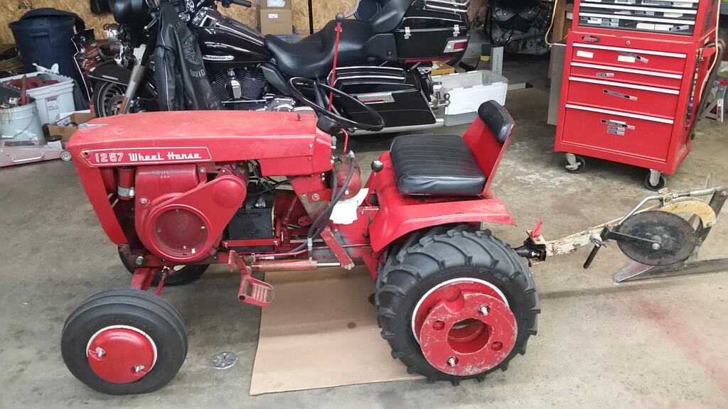

Achto 32,637 #2 Posted April 11, 2022 17 minutes ago, 857lover said: front tire replacements for size 16-5.5-8 but i am seeing some as 16-6.5-8 and i was wondering if these would fit nice 16-5.5-8's seem to be no longer available. This leaves you with a choice to go narrower 4.00/4.80-8 or wider 16-6.5-8. I have not put wider tires on any of my older narrow rims, instead I chose to go with the narrow tires Here is some pic's of one of mine with the DeeStone 4.00-8's 2 2 Share this post Link to post Share on other sites

Achto 32,637 #4 Posted April 11, 2022 7 minutes ago, 857lover said: do you think i would have to get a new wheel to use a 16-6.5-8 Not really, you will just have some more side wall bulge with a wide tire on a narrow rim. As far a performance of the narrow 4.00-8 DeeStones. I have the same tires on my plow mule. This tractor spends a lot of time pulling a mold board plow, never have issues with them in the dirt. 2 5 Share this post Link to post Share on other sites

Achto 32,637 #8 Posted April 11, 2022 21 minutes ago, 857lover said: i was thinking actually going to a 23-10.50-12 also will i need new wheels for those 4.80/4.00-8 My plow tractor that I have pictured has 23-8.50-12's on the rear. 4.00-8's on the front, all on the original rims. 23-10.50-12 rear tires will also fit on the original rear rims. 2 Share this post Link to post Share on other sites

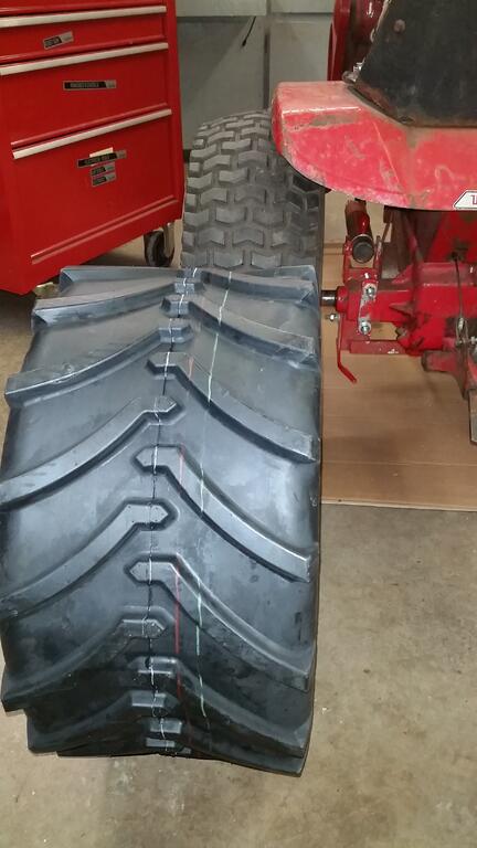

WHX?? 58,075 #9 Posted April 11, 2022 (edited) Stock tire 23 8.50 ag is 23.10.50 Edited April 11, 2022 by WHX?? 2 1 Share this post Link to post Share on other sites

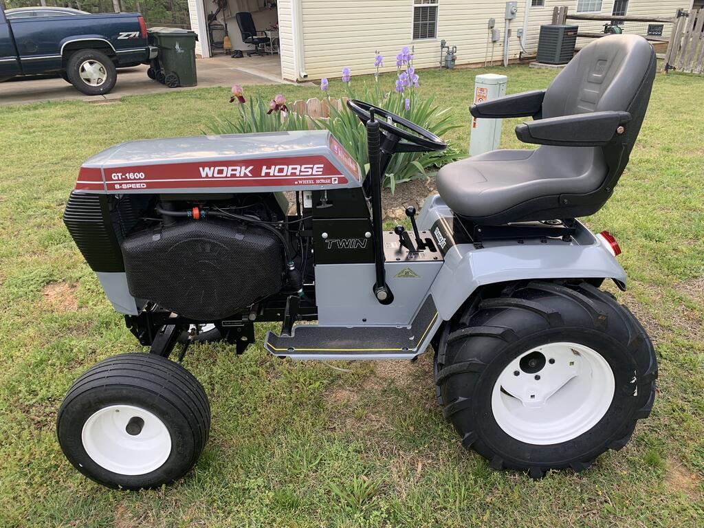

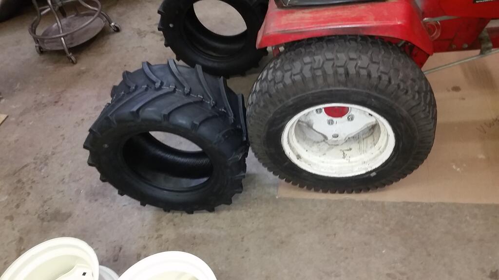

pfrederi 21,145 #10 Posted April 11, 2022 Left are Deestone 10.50 on 7 inch (standard old WH rims) Right is Carlisle 10.50 on 8.5" rim (Later WHs 520s) 4 Share this post Link to post Share on other sites

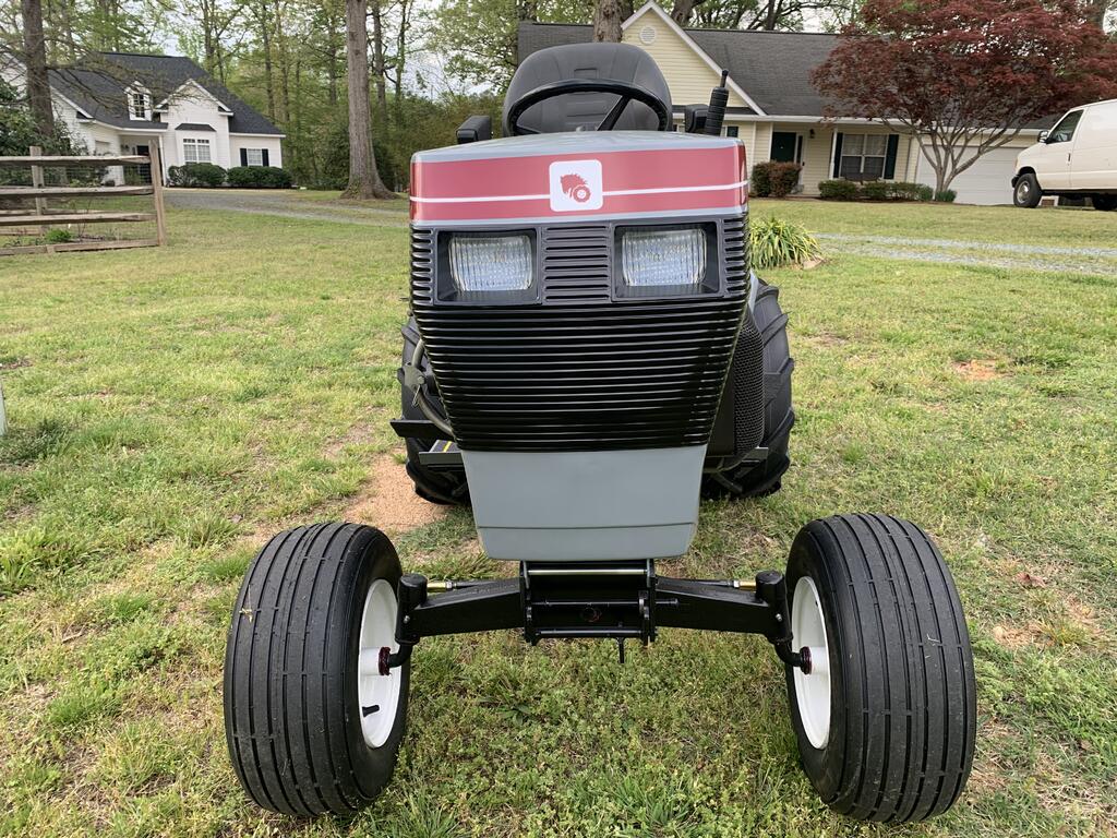

Horse Newbie 7,405 #12 Posted April 13, 2022 Hi-Run 23x10.50-12 ags on rear… Hi-Run 16x6.50-8 straight ribs on front… 3 3 Share this post Link to post Share on other sites
TJ5208 1,841 #13 Posted April 13, 2022 1 hour ago, Horse Newbie said: Hi-Run 23x10.50-12 ags on rear… Hi-Run 16x6.50-8 straight ribs on front… How do the straight ribs do? It almost looks like it has no tread. 2 Share this post Link to post Share on other sites
WHX?? 58,075 #14 Posted April 13, 2022 19 hours ago, kpinnc said: Those sure are some good looking tires! Hy runs too. Reasonably priced and boy do they grab. I get alot of compliments on the plow field on how well they do. There is only a 1/2 belt spinning them which gives out long before they lose grip. Undouble the best tractor tires I ever bought. I should load them 4 2 Share this post Link to post Share on other sites
Horse Newbie 7,405 #15 Posted April 13, 2022 18 hours ago, TJ Salyers said: How do the straight ribs do? It almost looks like it has no tread. They work great !… riding up and down the street like I’m in a parade… 1 Share this post Link to post Share on other sites

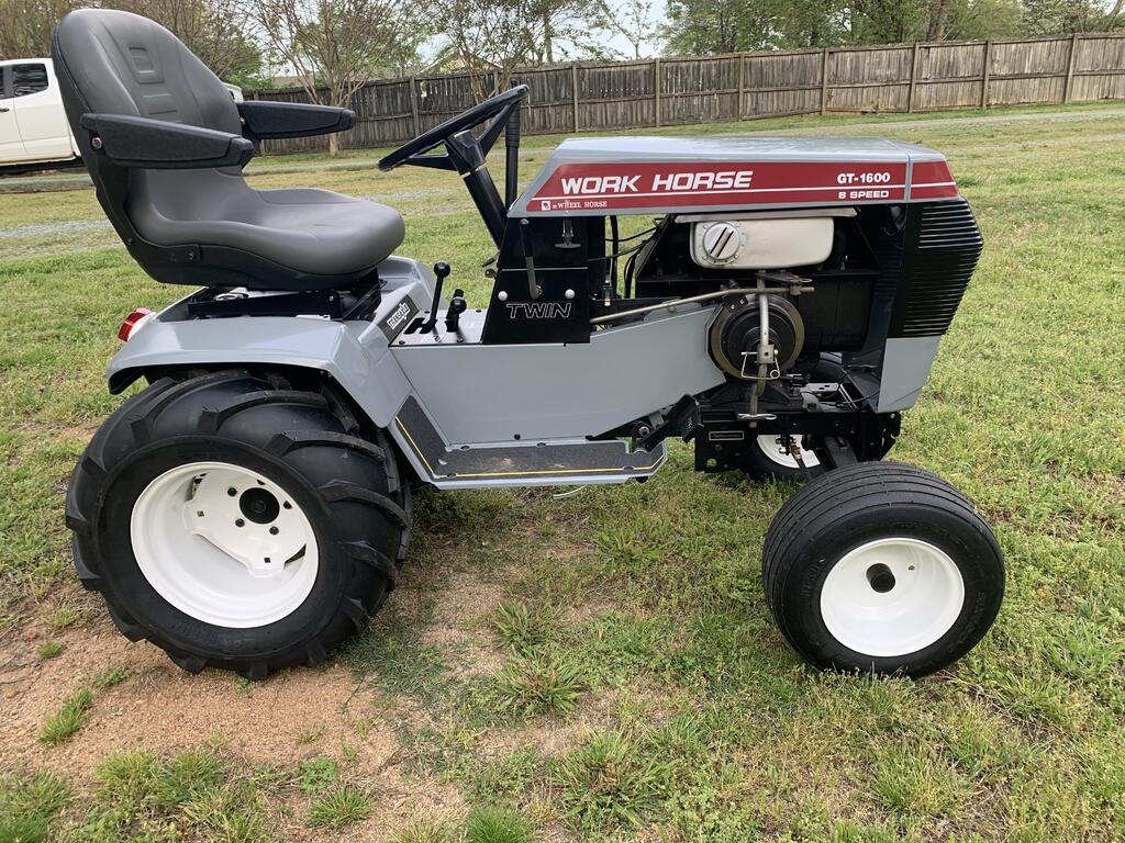

rjg854 13,341 #16 Posted April 13, 2022 I put these tri-ribs on my 854 3 Share this post Link to post Share on other sites
