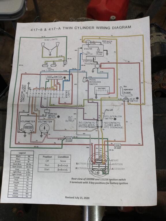

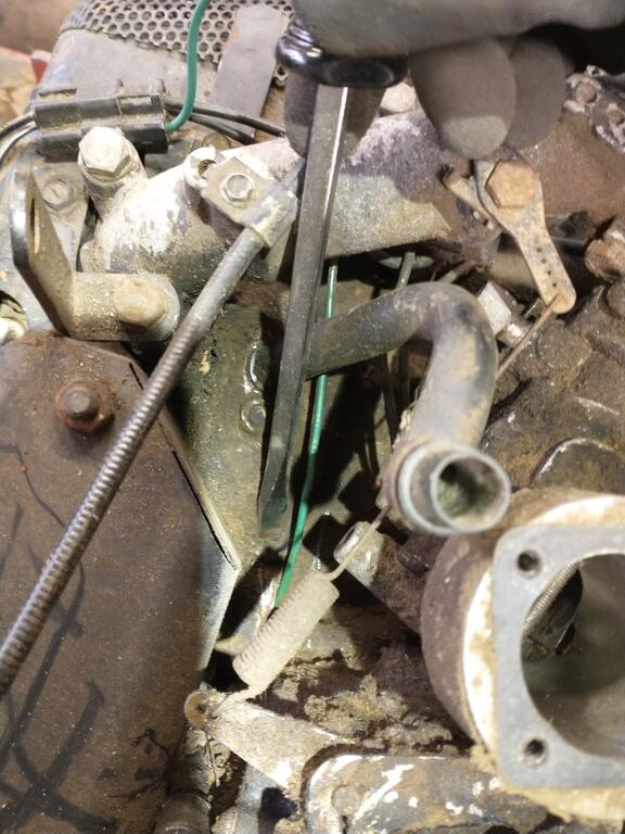

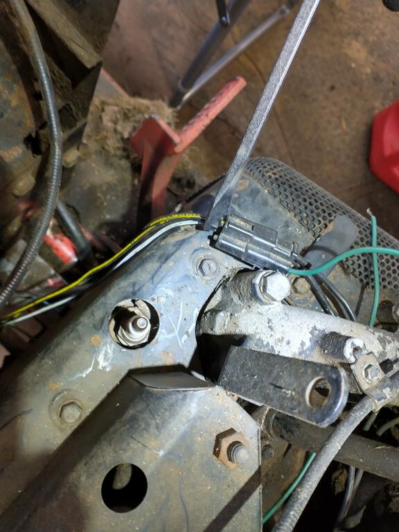

ebinmaine 77,821 #1 Posted April 11, 2022 @JCM here's tractor #2... I'd like to get this beast up n runnin' and drive it so I can see if the transmission is healthy. After that I may borrow the engine for a bit for another tractor. The PO had a nephew that had good intentions but some folks just should not pick up a tool. The wiring is partially removed from the tractor. There is no test circuit board. There are no test lights. Here's the schematic diagram I've been using. The engine topside has a GREEN wire coming out where I believe it should have a BLUE wire for the (oil pressure sensor??). I have to assume it's a replacement wire and/or sensor. At the plug where that wire would normally lead into and exit there is NO wire on the outgoing side as it's been cut. Note the end of the screwdriver. Do I need the oil pressure sensor to be connected to start the engine? If so what do I connect that green wire to? Thanks. 1 1 Share this post Link to post Share on other sites
Handy Don 16,061 #2 Posted April 11, 2022 1 hour ago, ebinmaine said: Do I need the oil pressure sensor to be connected to start the engine? If so what do I connect that green wire to? If you have the right schematic, then the oil switch is an indicator light only. Only the seat and PTO safeties affect start/run. 2 1 Share this post Link to post Share on other sites
ebinmaine 77,821 #3 Posted April 11, 2022 6 hours ago, Handy Don said: If you have the right schematic, then the oil switch is an indicator light only. Only the seat and PTO safeties affect start/run. I believe the schematic is a colorized version of the OE Wheelhorse diagram so it should be right. That info makes sense. I'll do more when I get time. Those safety switches are temporarily bypass-able so it should be headed towards starting with a coil, 2 plugs, and 2 ignition wires. 5 Share this post Link to post Share on other sites
953 nut 64,647 #4 Posted April 11, 2022 (edited) 10 hours ago, ebinmaine said: get this beast up n runnin' and drive it so I can see if the transmission is healthy. If your only goal is to get the engine running to test the engine and transmission then the only wiring you'll need is a temporary jumper wire from the battery "+" (switch optional) to the ignition coil "+" terminal and a small jumper wire from the battery side of the solenoid to the small blue wire on the solenoid for momentary contact (push button optional). 10 hours ago, ebinmaine said: Do I need the oil pressure sensor to be connected to start the engine? NO, a test light to reassure you that there is oil pressure might be nice though. Edited April 11, 2022 by 953 nut 1 2 Share this post Link to post Share on other sites
ebinmaine 77,821 #5 Posted April 11, 2022 22 minutes ago, 953 nut said: If your only goal is to get the engine running to test the engine and transmission then the only wiring you'll need is a temporary jumper wire from the battery "+" (switch optional) to the ignition coil "+" terminal and a small jumper wire from the battery side of the solenoid to the small blue wire on the solenoid for momentary contact (push button optional I wondered if that was a possibility. Thanks Richard. 1 Share this post Link to post Share on other sites
