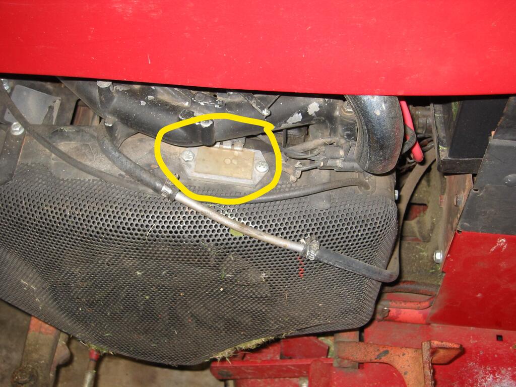

pfrederi 20,062 #2 Posted April 10, 2022 (edited) Regulator is circled. Check for AC voltage on the outside terminals engine running should be about 30 VAC. If it is and you are not getting 13.6 or more at the battery regulator is probably bad...but first get the battery fully charged and load tested before you buy a new regulator. Edited April 10, 2022 by pfrederi 1 Share this post Link to post Share on other sites

953 nut 64,647 #4 Posted April 10, 2022 3 hours ago, Stubby said: Just touch one terminal at a time? Meaning ground one side of my meter to engine (ground) somewhere and then touch + side at a time. Both should get 30 volts each? This is inaccurate information! The center terminal of your regulator should be 12 volts DC with the ignition key on, without battery voltage the regulator won't work. The voltage on the two outer terminals with the engine running at high RPMs should be 36 volts AC +/- between the two outer terminals, not to ground 5 Share this post Link to post Share on other sites

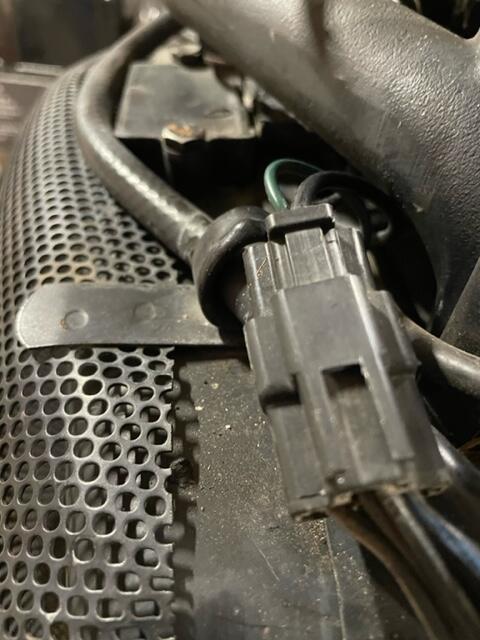

Stubby 19 #5 Posted April 11, 2022 (edited) 20 hours ago, 953 nut said: The center terminal of your regulator should be 12 volts DC with the ignition key on, without battery voltage the regulator won't work. The voltage on the two outer terminals with the engine running at high RPMs should be 36 volts AC +/- between the two outer terminals, not to ground I am not getting any voltage on the center terminal. I also checked the same wire from the ignition to the connector and nothing. Wanted to make sure it was not the connector that is pictured. The connector did ohm so there is continuity through it. Edited April 11, 2022 by Stubby Share this post Link to post Share on other sites

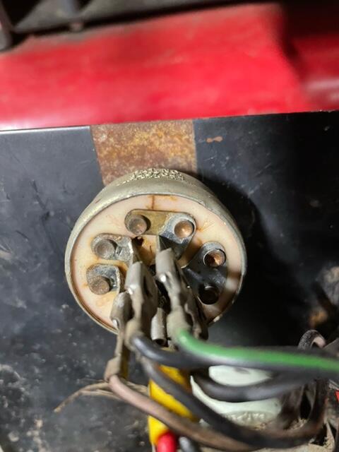

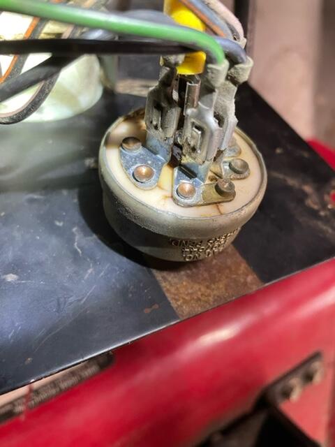

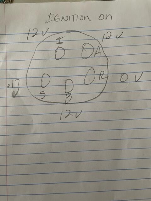

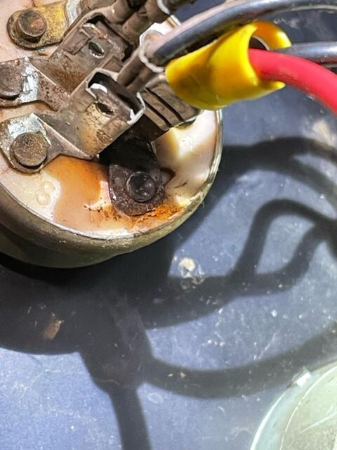

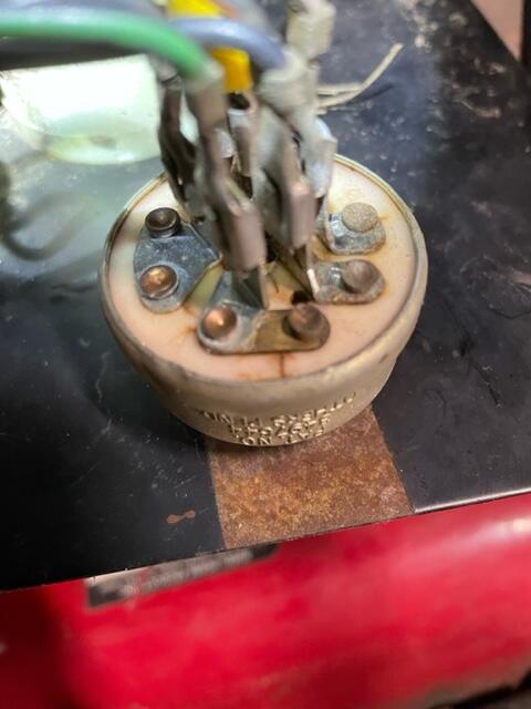

Stubby 19 #10 Posted April 16, 2022 (edited) I want to make sure your reference to key on, is just the key forward, not starting etc? I ohm the regulator wire, from the regulator to the ignition switch and it ohms fine. Just do not get any voltage with key in on position with tractor not running. With the key on, this is what I am getting at the ignition. So far al the wiring checks out. Edited April 16, 2022 by Stubby Share this post Link to post Share on other sites
gwest_ca-(File Mod) 12,066 #11 Posted April 16, 2022 Since there is no power on the R terminal that is likely the problem. First off a regulator requires battery voltage to regulate the charge current and the power supplied has no way to get to the battery. Click on the picture in each link for more. Share this post Link to post Share on other sites
Stubby 19 #12 Posted April 16, 2022 thank you all very much it was the ignition switch. Replaced and putting over 14 volts to the battery. Share this post Link to post Share on other sites
