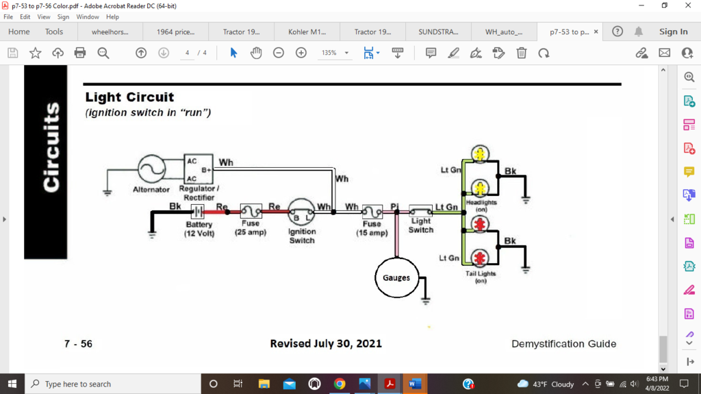

WHX?? 58,214 #5 Posted April 8, 2022 Yes we do like our Pics are a thousand words. We'll see if we can get you a wiring diagram. Share this post Link to post Share on other sites
WHX?? 58,214 #6 Posted April 8, 2022 (edited) Click on the pic... some nice colored diagrams there. Edited April 9, 2022 by WHX?? Share this post Link to post Share on other sites
953 nut 69,544 #7 Posted April 8, 2022 (edited) The two black wires probably have a colored tracer printed on them that corresponds to the lighting wires. Here is a drawing of your lighting. You can use a meter or test light to see if these wires have 12 volts with the lights on. Edited April 8, 2022 by 953 nut 1 Share this post Link to post Share on other sites
