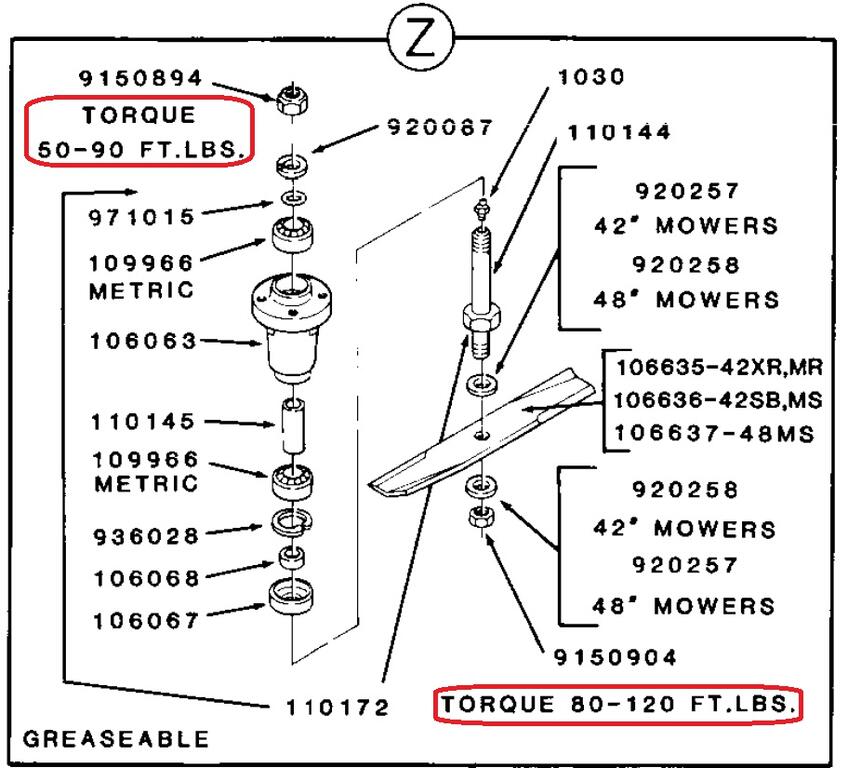

Searcher60 209 #1 Posted April 6, 2022 Hello, anyone know the belt and blade nuts torque on like a 78360 or 78345 mower deck? Is it the same torque for both nuts? Thanks! Share this post Link to post Share on other sites
gwest_ca-(File Mod) 12,451 #2 Posted April 6, 2022 I believe the Z spindle assemblies in the ID charts are used in the 78345 and 78360 decks. The torque spec. for the blades is also in the deck operator manuals. 1 1 Share this post Link to post Share on other sites
peter lena 10,013 #3 Posted April 6, 2022 @Searcher60 make sure you use a 6 POINT SOCKET on those nuts , also replace the nuts if corroded or visibly round edge worn. pete Share this post Link to post Share on other sites
