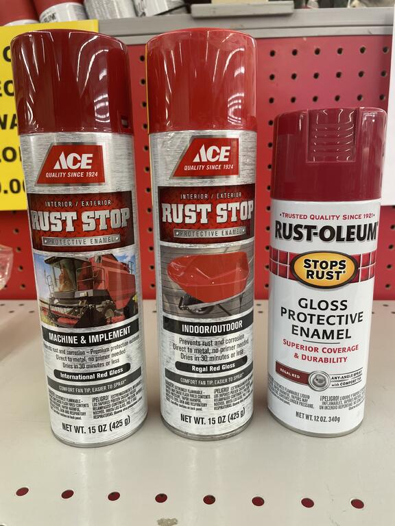

Redav72 231 #1 Posted April 4, 2022 Of these three options, which is the best for a worker? Share this post Link to post Share on other sites
rmaynard 17,634 #2 Posted April 4, 2022 Whichever one you like best. 4 Share this post Link to post Share on other sites

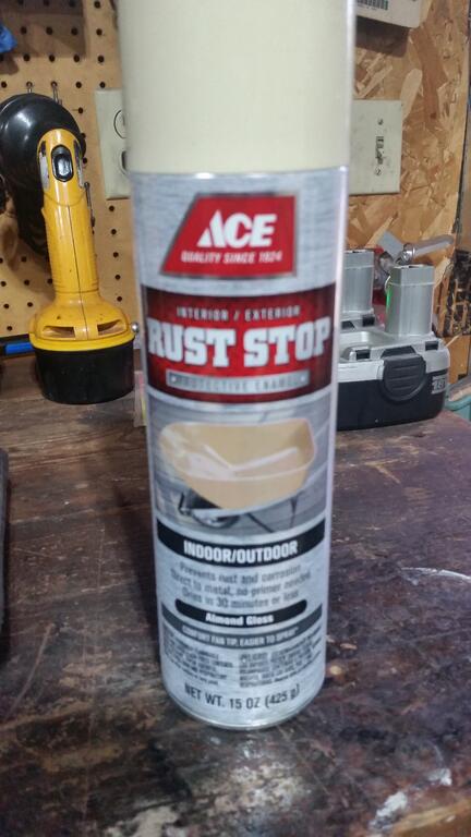

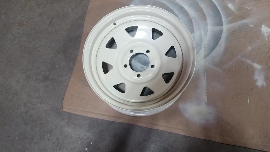

WHX?? 58,324 #3 Posted April 4, 2022 (edited) If you plan on ruining the patina on that 753 I ain't gonna tell ya Phil! I generally use the one on the right with good results but not a big fan of Rustolem products these days. I use the same Ace stuff on rims. Color is good enough for the women we go out with and covers well & cures fast. Comes out of the can very nice. Just did a trailer rim with jt. Don't have the red color at my Ace but would like to try it. Edited April 4, 2022 by WHX?? 4 Share this post Link to post Share on other sites

Brockport Bill 2,498 #5 Posted April 4, 2022 i have used all -- they do have minor difference in the look--------- so depending if you try to plan to match prior factory red on the tractor..... or if the entire tractor is being redone? susggest you do a couple test pieces and compare in outdoor light 2 Share this post Link to post Share on other sites
Redav72 231 #6 Posted April 4, 2022 18 minutes ago, WHX?? said: If you plan on ruining the patina on that 753 I ain't gonna tell ya Phil! Nope! This is for it's younger (but bigger) brother the Charger 12. Since the Charger is my plow horse I'm planning to do a full tear-down and rebuild this summer. 1 Share this post Link to post Share on other sites
WHX?? 58,324 #7 Posted April 4, 2022 11 minutes ago, Redav72 said: Nope! Whew... ok all good. I would like to try that IH implement red too. May try to order it. Like Bill said try it on a few test pieces first. Share this post Link to post Share on other sites
briankd 833 #8 Posted April 5, 2022 Just did mine with the Rust-Oleum spray cans junk they spray globs out I used 6 cans they not like they once was 1 Share this post Link to post Share on other sites
ri702bill 13,271 #9 Posted April 5, 2022 I have brought this up before - stand your rattle cans up in a pan of faucet hot water for about 20 minutes before use - a tip I used from my old model car building days. Doing this thins the paint and raises the pressure in the can - just remember to dry the outside of the can off first!! Bill 1 Share this post Link to post Share on other sites
midpack 1,148 #10 Posted April 5, 2022 Dupli-Color DE1653 red is a better quality (automotive) paint and it matches well 1 Share this post Link to post Share on other sites
