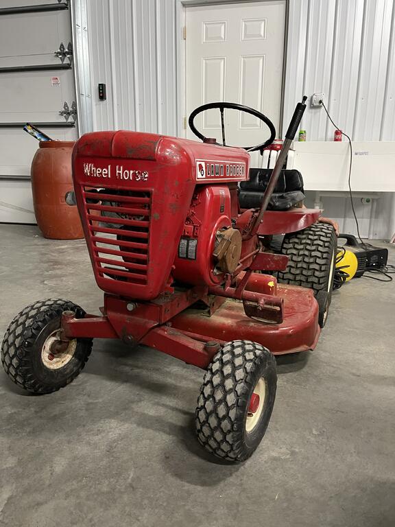

briley 5 #1 Posted April 2, 2022 Does anyone know the front tire size and where I should buy the tires? Thanks 2 Share this post Link to post Share on other sites
Terry M-(Moderator) 2,239 #2 Posted April 2, 2022 Nice looking 1968 Lawn Ranger!!! Should say on the side of the tires…just curious but what’s wrong with the tires that are on It? 1 Share this post Link to post Share on other sites
kpinnc 14,663 #3 Posted April 2, 2022 You won't be able to replace those with the same size. The original tires are actually the size that they claim. All new tires seem to be about 20% smaller that the claimed size. If the fronts are not weather cracked, I would clean them well and keep them. They give a look to the Ranger that will be hard to duplicate. 9x3x4 tri ribs will fit, but the same size of anything else looks smaller. 3 Share this post Link to post Share on other sites

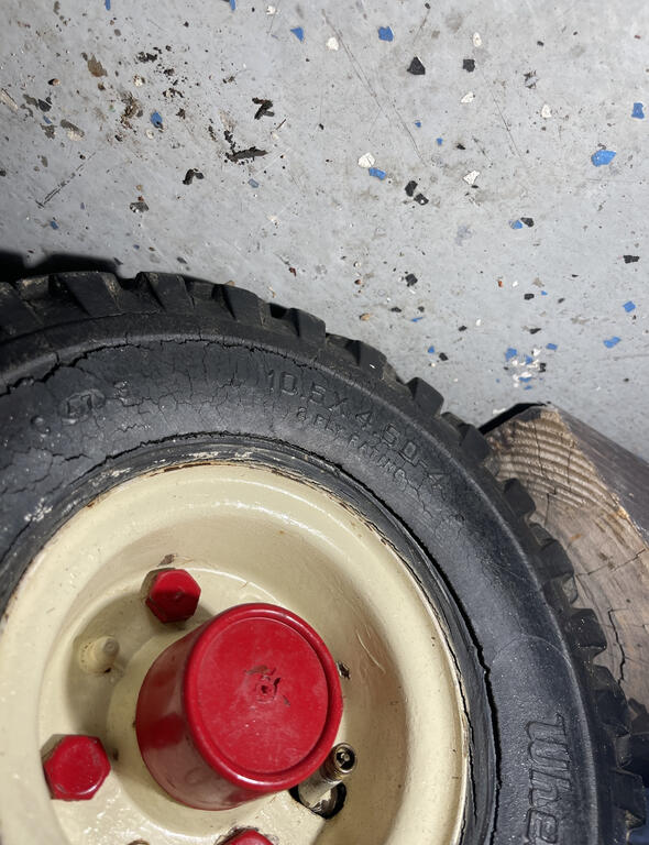

briley 5 #6 Posted April 2, 2022 3 hours ago, Terry M said: Nice looking 1968 Lawn Ranger!!! Should say on the side of the tires…just curious but what’s wrong with the tires that are on It? The ones in the back leak air and the front ones have a lot of cracking. 2 Share this post Link to post Share on other sites

WHX?? 51,864 #8 Posted April 2, 2022 (edited) @dclarke what do you use on your LR work? That's too bad Briley those have the WH on them too. Any one know if tire paint would help on the cracks? Edited April 2, 2022 by WHX?? 1 Share this post Link to post Share on other sites

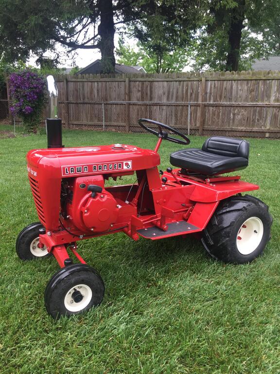

dclarke 4,083 #9 Posted April 2, 2022 8 minutes ago, WHX?? said: @dclarke what do you use on your LR work? I run Vredestein 3.00-4 tri ribs on the front and Carlisle Super Lugs 18 x 9.50 -8 on the rear. Got them from Miller Tire. 3 3 1 Share this post Link to post Share on other sites

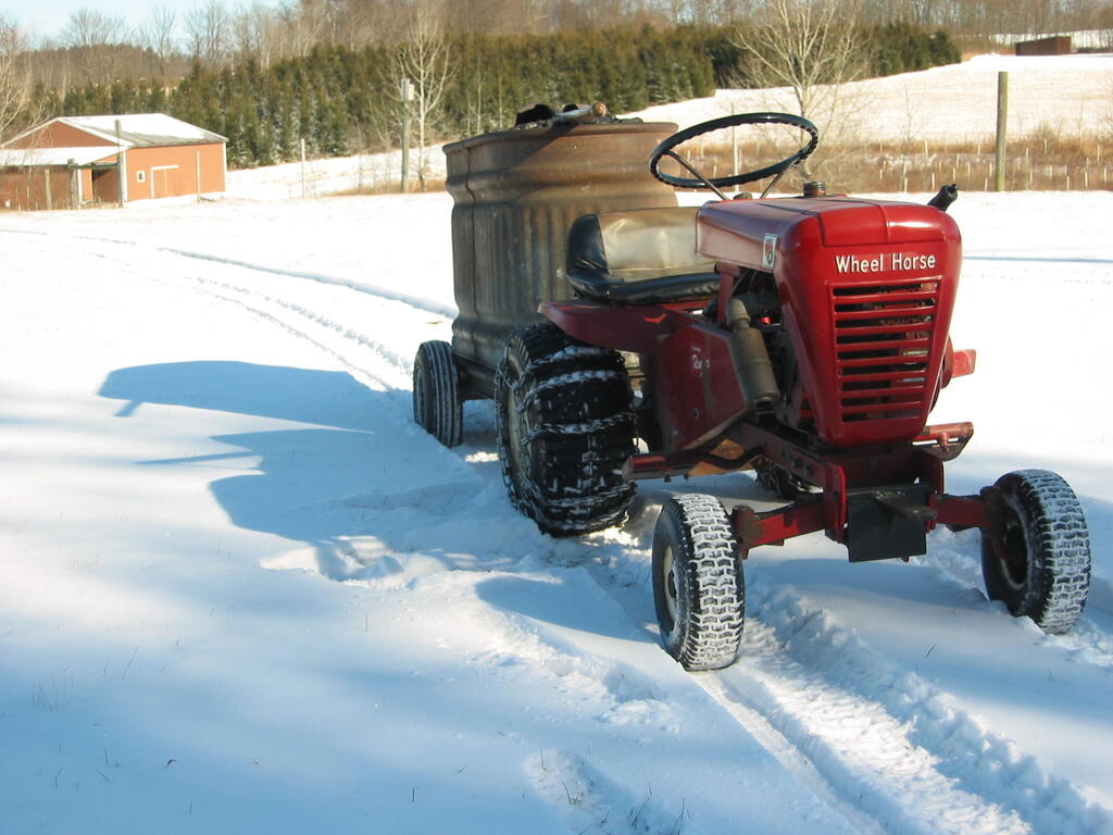

pfrederi 18,708 #10 Posted April 2, 2022 I searched high and low for original size tread pattern for my L107. The are no longer made. Since she is my work tractor i put the originals on the shelf and went with the ones below. There rears hiding under the chains are originals still say WH. (still working after 55 years) I run Ag treads in the summer and mud seasons. If yours are leaking just tube them. 4 1 Share this post Link to post Share on other sites

ol550 830 #12 Posted April 2, 2022 3 hours ago, WHX?? said: @dclarke what do you use on your LR work? That's too bad Briley those have the WH on them too. Any one know if tire paint would help on the cracks? Tire paint would help as much as lipstick on a pig. 1 6 Share this post Link to post Share on other sites

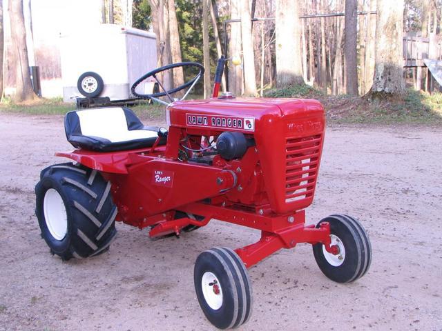

kpinnc 14,663 #15 Posted April 2, 2022 (edited) If I had no other choice, the tri ribs on a Ranger look good. I don't know who this belongs to, because I just googled it. A very nice 1968 Ranger, whoever it belongs to! Edited April 2, 2022 by kpinnc 2 Share this post Link to post Share on other sites
