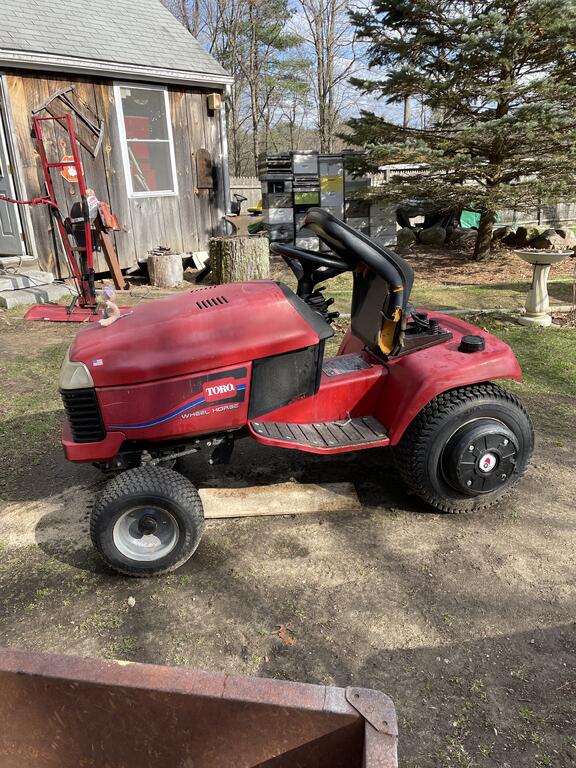

AveryO 1 #1 Posted April 1, 2022 Hello all I just acquired a 522xi tractor. The tractor was used previously to plow snow. The trans seams to slip and the surge as if it just grabs all of a sudden. It seams fine in reverse at all speeds. I have changed the trans oil and filter and cleaned the power steaming filter. Since it just happened it forward I am assuming it is probably a issue in the hydro drive and not the trans. Any help would be appreciated. Also do they still sell parts to rebuild one of these units? Share this post Link to post Share on other sites

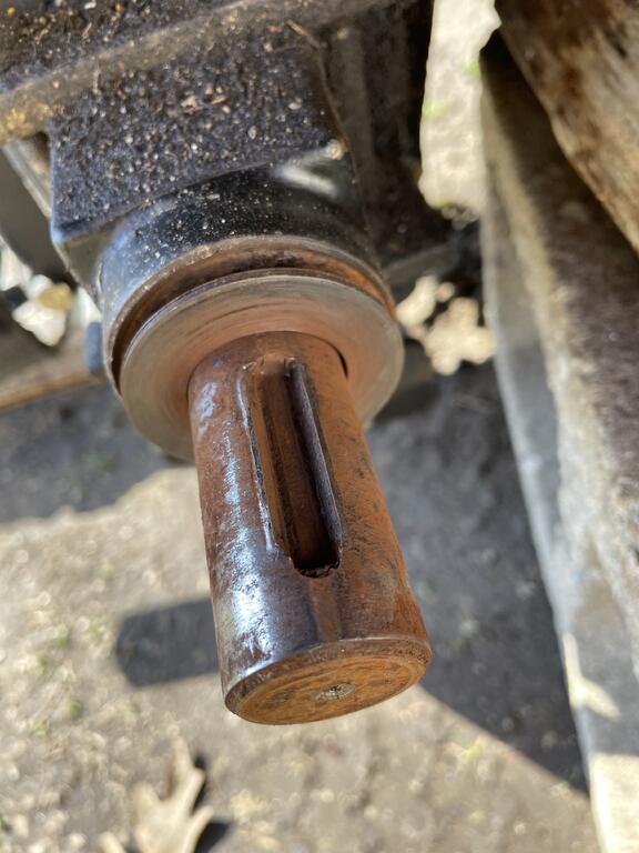

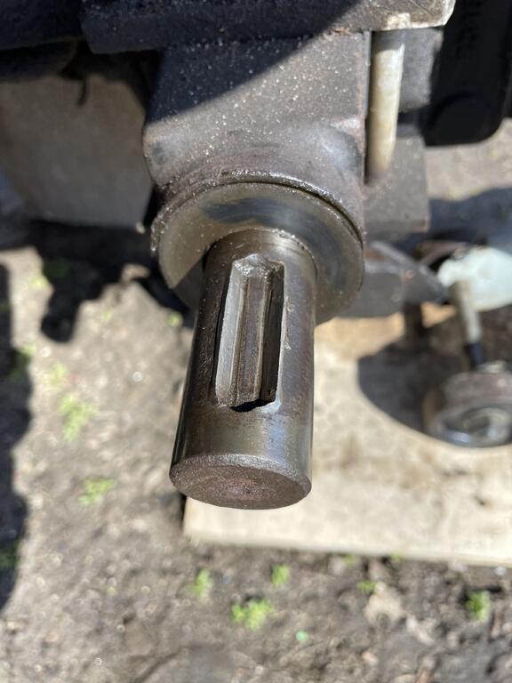

AveryO 1 #7 Posted April 2, 2022 Hello all I tore into the hubs and found as all of you had told me the the keyway and hub was bad. Sure enough it was just as you said.both sides were bad. Thanks again for the insight. AO 1 Share this post Link to post Share on other sites

Handy Don 17,549 #12 Posted April 2, 2022 1 minute ago, AveryO said: Has any one tried drilling straight through the axle and hub and running a hardened bold straight through.. don’t know if the axle is hardened. I may also weld short term. Don’t want to put to much money before this rest of the unit is proven out to be in good shape. The axle is hardened at the bearing races, but clearly is not hardened at the hub (the key would have sheared before a hardened axle deformed). A through bolt is NOT a good idea. It severely weakens both the axle and the hub AND puts all the torque on a very small area of the axle & hub where they butt against the bolt. It might work for a show tractor that was doing no work, but for a worker? No way. If you are thinking of a temporary solution, given that your axles and hubs are already toast, I'd consider a skilled welder welding them. BUT FIRST, I'd preemptively replace the about-to-become-inacessible axle oil seals! 1 Share this post Link to post Share on other sites
Handy Don 17,549 #13 Posted April 2, 2022 Just had another thought... I'd give Lincoln at A-Z a call next week and ask him about the possibility of using these clench hubs on your wallowed axles by just cleaning them back to round and fitting a "good enough" key. Not a cheap fix, but would not involve opening the transaxle. Share this post Link to post Share on other sites
pfrederi 21,216 #14 Posted April 2, 2022 If you have access to a welder you can make a key substitute out of brass fill in the gaps then use a regular key. Share this post Link to post Share on other sites
