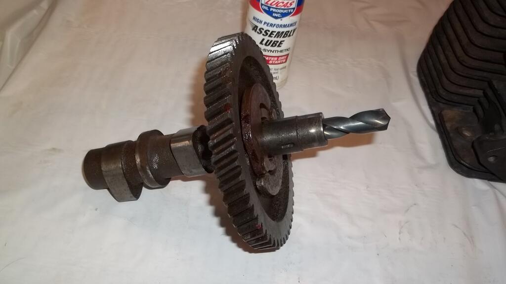

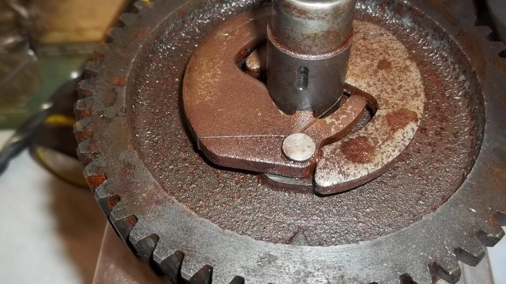

953 nut 64,116 #1 Posted March 31, 2022 If you are rebuilding an older model Kohler engine with the two piece ASA (Automatic Spark Advance) camshaft you may feel like it is an imposable task. Unlike the ACR (Automatic Compression Release) cam the ASA cam is a two piece unit and none of the manuals I've read give you any guidance on their installation. The portion of the camshaft that operates the valves and fuel pump is separate from the portion that opens the ignition points. There is a pair of flyweights and associated springs on the cam gear that will advance the ignition timing once the engine comes up to speed. The gear and the ignition actuator cam have markings so you won't put it together 180 out. (see first picture) The ignition cam slips over the two flyweights and the small springs ride on the outside. So far so good. Now comes the tricky part, sliding the cam into place without dislodging the ignition cam. I have found that a 7/16" drill bit is just right for the job. You slip the drill bit into the hallow camshaft assembly, lower it into place. As you push the shaft your cam rides on into place it pushes the drill bit out the other end and both pieces are where they belong. There are a couple ways to determine what camshaft you have. Presuming the camshaft in your engine is the one it was born with the data plate on the engine has a suffix that can tell you what camshaft was used. The table below will tell you the suffix applicable to your engine. The other way to determine what camshaft you have is to remove the cam gear cover and take a look. If you see a mechanism attached to the cam gear it is the ACR cam. The following engines have the spark advance camshaft; K-141, Suffix prior to “C” K-161, Suffix prior to “J” K-181, Suffix prior to “D” K-241, Suffix prior to “D” 5 3 3 Share this post Link to post Share on other sites

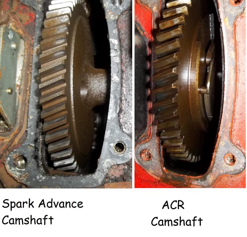

squonk 45,526 #2 Posted March 31, 2022 Remember small blocks don't have the gear cover. Suffix "A" K181's have the 2 piece cam. Suffix D has the 1 piece. 1 Share this post Link to post Share on other sites

953 nut 64,116 #6 Posted April 1, 2022 10 hours ago, Handy Don said: You answered the question that was on the tip of my tongue--what cam gear cover?! Thanks. My Spec 30108A, then, has the two-piece actuator for the points cam advance. Good to know. Today did a static points setting and .020 has the points opening at just 1 or 2 degrees before TDC according to the T mark on the flywheel. Should I be dropping this to .018 or .019 to retard the timing slightly? Ignition timing on Kohler engines. Gapping the ignition points at .020 has always been the standard answer to how points should be set. That probably will get you into the ballpark where the engine will run, but with a bit of additional effort you can improve the engine’s power and performance. The Kohler engine manual in the Red Square files section covers two methods for setting the ignition timing, Static Timing and using a Timing Light. This manual is a relatively new manual and it overlooks the fact that many of our engines were built prior to the ACR (automatic compression release) camshaft. Earlier engines (mostly 1965 and earlier) had a Spark Advance camshaft that can not be timed using Static timing. At rest (and very low RPMs) the timing is retarded to fire slightly after TDC. The timing mark (SP) on your flywheel is at twenty degrees before top dead center but at rest the points on these engines break about ten degrees after top dead center. The only reliable way to check or set the timing on these engines is with a timing light. There are a couple ways to determine what camshaft you have. Presuming the camshaft in your engine is the one it was born with the data plate on the engine has a suffix that can tell you what camshaft was used. The table below will tell you the suffix applicable to your engine. The other way to determine what camshaft you have is to remove the cam gear cover and take a look. If you see a mechanism attached to the cam gear it is the ACR cam. The following engines have the spark advance camshaft; K-141, Suffix prior to “C” K-161, Suffix prior to “J” K-181, Suffix prior to “D” K-241, Suffix prior to “D” 3 Share this post Link to post Share on other sites

Handy Don 15,944 #13 Posted April 2, 2022 1 minute ago, Achto said: No I did mean an ACR cam. @953 nut explained that static timing will not work on a spark advance cam. Yikes. Yes, now rethinking and I'm not sure I agree with @953 nut that it won't work. It seems that when at rest, the SA cam should static time at the "retard" position for easier starting--right around TDC, i.e. the T mark (this is what I did today). Once running, the cam advances the spark for more power, so it should dynamic time at the S mark, a few degrees before TDC. So a timing light would still be handy to tweak it once it's running. I agree that static timing cannot be quite as precise as dynamic, but it should be very close. Share this post Link to post Share on other sites

Handy Don 15,944 #15 Posted April 2, 2022 9 minutes ago, Achto said: Just for an example: I have a K91 that was was a major PITA to start, warm or cold. The points were set at .020". A K91 has a basic cam, no ACR or spark advance. I static timed the engine and the points gap ended up at .018". This engine now starts on 1 or 2 pulls without fail. Decreasing the point gap retards the spark because the points open later, so your change makes perfect sense. Without ACR or SA, it is always a compromise between ease of starting and maximum efficient power output. I'm sure you've seen older cars and trucks that had manual spark advance controls so they could be tuned on the fly based on the quality and octane of the fuel, the engine temperature, and other factors. Typically, they "rotated" the distributor body holding the points a few degree relative to the points actuating cam. The issue with the SA cam is that it isn't a precise movement. Those little fingers on the weight arms pushing on those little holes in the cam have some slack and can wear. Hence, yes, the most precise way to set the timing is by timing light. Share this post Link to post Share on other sites
