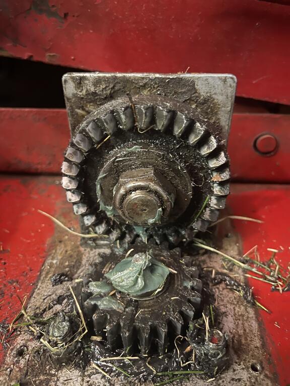

briley 5 #1 Posted March 31, 2022 Does anyone know where to get these gears? Mine are worn down to where they whine when they spin and no matter where I look I can’t seem to find them. Thanks Share this post Link to post Share on other sites

Handy Don 17,316 #4 Posted March 31, 2022 1 hour ago, briley said: I'd say that gear has given good service and is ready for retirement. Share this post Link to post Share on other sites
daveoman1966 3,884 #5 Posted April 1, 2022 Me thinks your gears are #3130 and #3131. Do an Ebay search on Wheelhorse 3130. Search again on Wheel;horse 3131. I found a few, but don't know how good they are.. 2 Share this post Link to post Share on other sites

Handy Don 17,316 #8 Posted August 4, 2023 A-to-Z in our vendor list will have some, but ones in good condition are becoming uncommon. Typically, it is the face gears that get worn/chipped (the ones attached to the cross shaft). The gear on the blade shaft can be reversed to put the lesser worn end into service. Shipping for two face gears wouldn’t be to pricey. Those of us who use and like these decks always try to have a spare gear (or two) for the inevitable too-worn-to-continue situation. Put an add in the “Classified - Wanted” section--you never know! Share this post Link to post Share on other sites
