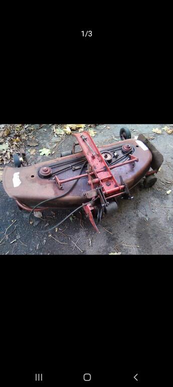

Rides2000 6 #1 Posted March 30, 2022 I have a 1997 312-8 wheel horse with a 36" rear discharge. I would like to upgrade to a bigger one but do not know compatibility. There is one online that is 42" wheelhorse with mule but do not know if it works. Any ideas? 1 Share this post Link to post Share on other sites
squonk 48,215 #2 Posted March 30, 2022 (edited) Wrong deck. That one is mid 60's. Anything from the mid 70's on up will work. Edited March 30, 2022 by squonk 3 Share this post Link to post Share on other sites

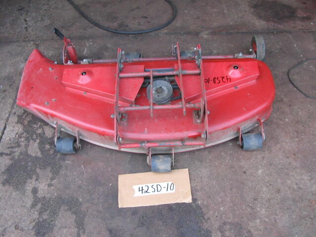

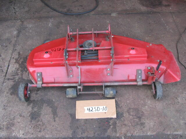

Handy Don 17,562 #4 Posted March 31, 2022 (edited) That one has a single large support member running from front to back. You want one with two smaller front-to-back support bars and a smaller lifting bar, joined by rods between them like this: Edited March 31, 2022 by Handy Don 3 1 Share this post Link to post Share on other sites
daveoman1966 3,884 #5 Posted March 31, 2022 This 42" deck is the style to fit your 312-8. The pic above by Handy Don is a 48"...but it would also fit. 2 1 Share this post Link to post Share on other sites
