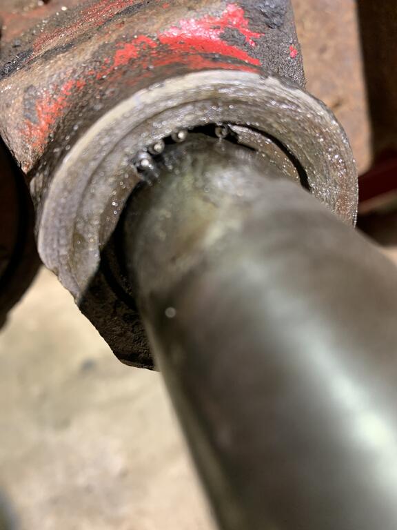

857lover 291 #1 Posted March 30, 2022 (edited) so i went up to a-z tractor picked up some axel seals and i pulled the seal out but i think i broke the front part of my needle bearing what should i do i’m getting such bad luck 3 weekends ago my 857 trans broke last week i bought this 1267 found out it was leaking really bad and this week this i am really getting frustrated with theese machines but i think this one was operator error but what do you guys think i should do @danweikert21 Edited March 30, 2022 by 857lover 1 Share this post Link to post Share on other sites
Handy Don 15,997 #2 Posted March 30, 2022 Bummer. If it is any solace, know that every one of the members here has done at least one "oops" like this (in fact, there was a recent thread where folks owned up to some of the most colorful ones). But that doesn't help you get your tractor fixed. Unless the axle itself or the trans casing is damaged, this is repairable. For parts you'll need the new bearing, the seal you already have, and a gasket for when you put the transmission back together. And of course a refill on the oil. I don't know the level of your mechanical skills and tooling, though. Have you ever taken an engine or transmission apart and put it back together? There are some threads here on rebuilding transmissions that are worth watching. Failing that, you'll have to have someone do it for you or with you. 4 1 Share this post Link to post Share on other sites
kpinnc 17,274 #3 Posted March 30, 2022 You gotta go inside that tranny. That axle bearing will not hold up in that condition. It's likely a good time to replace both sides and be done with it. That will set you up for another 50 years. These trannies are very simple, and lots of folks on here can help you out. I know a couple members have full take down and reassembly videos as well. 3 1 Share this post Link to post Share on other sites

kpinnc 17,274 #6 Posted March 30, 2022 4 minutes ago, 857lover said: mean i’ve done some engine work but never a transmission and where can i find a part number for my bearing and do i need a press to install them ?? I know someone here will have part numbers. They are posted many times over the years. No, a press isn't required. It is helpful, but not absolutely necessary. You can GENTLY drive them in. I've used a socket and a light hammer. Just be careful. 3 1 1 Share this post Link to post Share on other sites

oliver2-44 11,258 #9 Posted March 30, 2022 You can split that transmission and Possible just remove the differential without disturbing the other gears and shifter forks. But it really depends what it looks like when you get in there. 2 1 Share this post Link to post Share on other sites

Maxwell-8 4,370 #20 Posted March 30, 2022 Gosh, bad axle bearings, Have had my good share of them. Makes sure nothing of the bearing is still in the tranny, good practice is to open the diff, just to make sure it's empty. 8 Share this post Link to post Share on other sites
