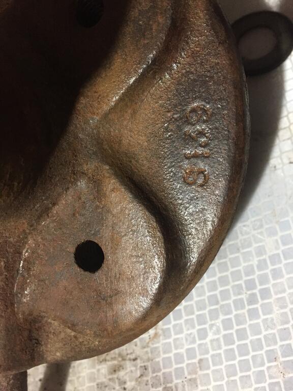

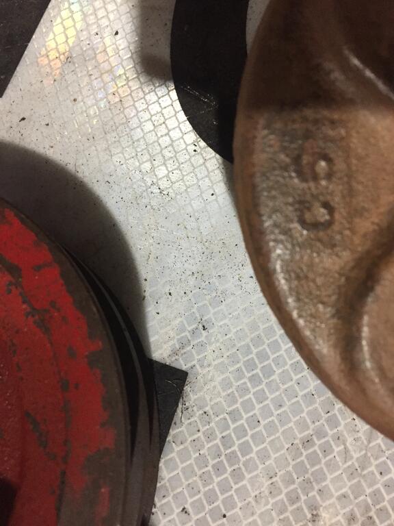

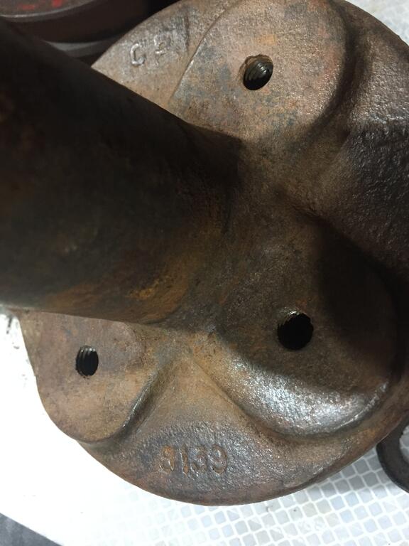

JimSraj 583 #1 Posted March 28, 2022 (edited) Does anyone have a chart of late 1960s deck spindle numbers and the decks they work with? I rently picked up a beat up deck that the PO said was from a Charger. It has what appear to be 2 good spindles and one with a beat up casting but decent shaft. Numbers cast into them are hard to be sure of but look like 8139 or S139. A few pictures to help. Edited March 28, 2022 by JimSraj Add pics! Share this post Link to post Share on other sites
gwest_ca-(File Mod) 12,354 #2 Posted March 28, 2022 These are the parts lists the 8139 shows up in. Keep in mind some lists may cover both sizes of deck and the 8139 is used on only one of them. 5-0481, 48" Side Discharge Mower, 1970 5-1000, 42" Side Discharge Mower, 1971 5-1001, 42" Side Discharge Mower, 1972 5-1200, 48" Side Discharge Mower, Use 5-1010, 1971 5-1422, 42" Side Discharge Mower, 1969 5-1423, 42" Side Discharge Mower, 1970 5-1482, 48" Side Discharge Mower, 1969 5-1483, 48" Side Discharge Mower, 1970 There is also this service bulletin listed The spindle charts 2 Share this post Link to post Share on other sites
