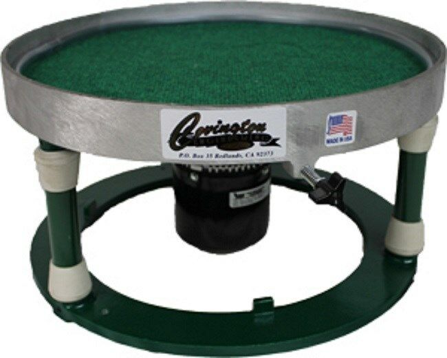

ebinmaine 80,500 #1 Posted March 27, 2022 I have about half a dozen cylinder heads that need planing at the moment for projects coming up in the next few weeks. All Kohler engines. All flatheads. All aluminum. Up until now I've been planing them by sticking a piece of sandpaper to a very flat surface and moving the head back and forth back and forth back and forth. Turn 90°. Repeat. Over and over and over until it's done. As many of you know that's very time-consuming and... right now I'm fighting some physical issues that make it difficult to keep doing that for very long. At some point in the future I'm going to pick up a larger belt sander for this type of work. Right now I don't want to spend any money until the barn project is figured out. I had a thought this morning that maybe I could take a short piece of wood or metal. Put a solid bolt centered in it facing UP and two screws or bolts a few inches apart facing DOWN. Loosely stick the down-facing bolts in between the cooling fins and slowly spin the cylinder head..... By hand using a standard battery powered drill. Not on a drill press. Super slow. Sweep off the sandpaper every few dozen rotations. Would this work? Why or why not? 1 Share this post Link to post Share on other sites
ri702bill 12,942 #2 Posted March 27, 2022 7 minutes ago, ebinmaine said: Would this work? Why or why not? Eric: MAYBE - I am not a fan of circular motion to get something flat - as in bodywork - you use a linear flat sander for that. I AM a fan of the tried-and-true method with wet or dry sandpaper, used wet, and moving the head in a figure 8 motion. Why not take a head from the "Parts Department" - one with a half stripped out spark plug hole - or some other less than desirable defect and have at it??? (In the old days at work we would have to do a sample of no less than 30 to gain confidence in the outcome of a statistical analysis study ....) 5 Share this post Link to post Share on other sites

gwest_ca-(File Mod) 12,483 #4 Posted March 27, 2022 The outside of the head surface is going to see a lot more abrasive than the inside. Think of it like pulley sizes. 2 2 Share this post Link to post Share on other sites
wallfish 20,570 #5 Posted March 27, 2022 (edited) I'm with Bill & Gwest. It might be difficult to apply even pressure as even a very slight deviation of the angle when spinning will make the edges uneven, To save time start with a more aggressive grit and work your way down. (Down in size of the actual grit size but up according to the number grit). Edited March 27, 2022 by wallfish 3 Share this post Link to post Share on other sites

bc.gold 3,406 #19 Posted March 27, 2022 (edited) The flat lap, motor is attached to a cup inside an eccentric weight attached to the motor shaft creates the motion. Edited March 27, 2022 by bc.gold 1 Share this post Link to post Share on other sites
