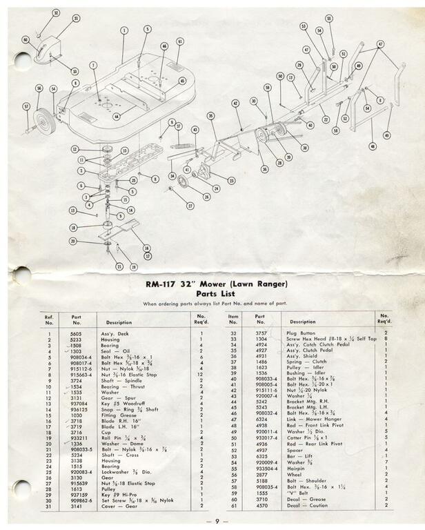

Handy Don 16,952 #5 Posted March 27, 2022 (edited) Check for even a slight amount of play in the spindle by trying to wiggle the blade (with the engine off, of course). Get the model number of the deck and look on this site for its IPL. If memory serves, I believe those decks used bushings. Edited March 27, 2022 by Handy Don Share this post Link to post Share on other sites
pfrederi 20,870 #6 Posted March 27, 2022 2 bearings each shaft WH# 1508 Torrington B-1212 1 Share this post Link to post Share on other sites
pfrederi 20,870 #7 Posted March 27, 2022 2 bearings each shaft WH# 1508 Torrington B-1212 1 Share this post Link to post Share on other sites
