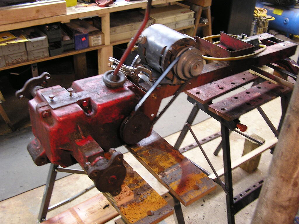

ri702bill 10,642 #15 Posted July 20, 2022 (edited) On 3/26/2022 at 3:27 PM, Brockport Bill said: Could you clarify the tranny flush for a 8 gear Did this 502 4 speed prior to opening it up to change a bad 3rd gear. Same can be done using a complete tractor - drain the oil - elevate the front off the ground a foot or so while draining. 2 quarts of diesel go in with tractor level - run thru all gears and hi-low for about 10 minutes each. Drain and look at what comes out - if still rusty, repeat. Two flushes should do it. Check the 4 seals to see if they leak, as diesel is a lot thinner. Change the seals and the boot if needed... Edited July 20, 2022 by ri702bill 1 1 Share this post Link to post Share on other sites
