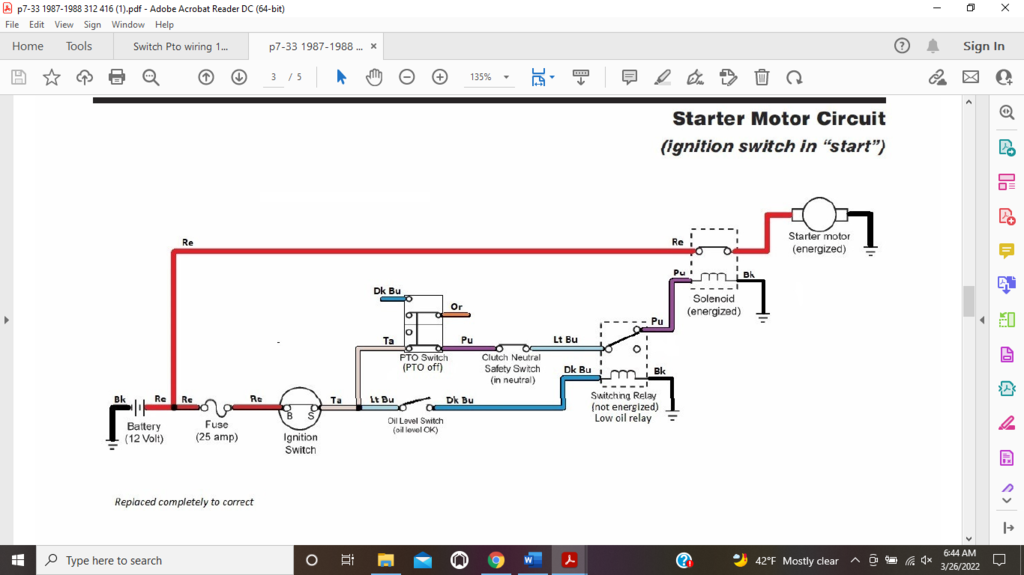

TC10284 118 #1 Posted March 26, 2022 (edited) I am working on a 312-A with a no start issue. Starter is good as I can connect negative battery cable and touch positive to start and it turns over. Turning key to Start results in nothing. Turning key to Run results in nothing on voltmeter and hour meter doesn't appear to be working. Tested for voltage at voltmeter gauge and got nothing. Get 12v to red wire on key switch. Fuse appears to be good. Made sure motion lever in neutral position. Pressed down on center of seat to trigger seat switch (if applicable). Key switch appears to be new. I think I replaced it last year or prior, but not certain. Tried a new relay switch. Didn't get a chance to check PTO lever switch. Might be my next step. Also been reviewing the wiring diagrams. Model is: 21-12KE03 Edited March 26, 2022 by TC10284 Share this post Link to post Share on other sites

953 nut 68,518 #3 Posted March 26, 2022 Thank you for providing the model number, not all 312s are wired alike. The diagram below is a flow chart of the starting system of your tractor. I would begin by cleaning and tightening ALL electrical connections including grounds, probably hasn't been done in 35 years. The fuse holder lives next to the battery and is subjected to acid fumes so even though you are reading voltage to the red wire on the ignition switch it should not be overlooked. Be sure your oil level is OK, the oil sentry switch and relay will prevent the starter from operating from the key with a low oil level. With the transmission in neutral run a small jumper wire from your battery "+" terminal to the small purple wire on the solenoid, the solenoid should close and the starter turn the engine. Hope this is helpful. 2 Share this post Link to post Share on other sites
