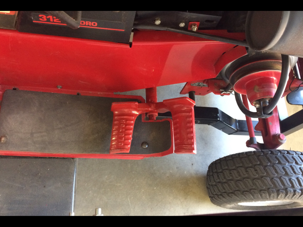

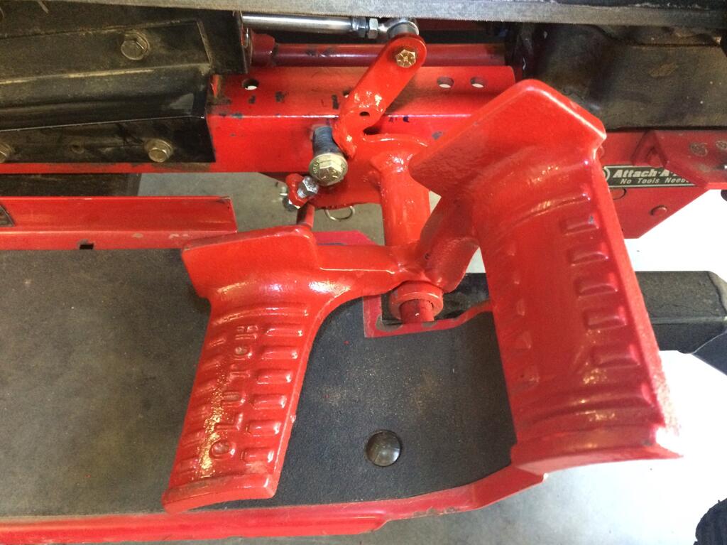

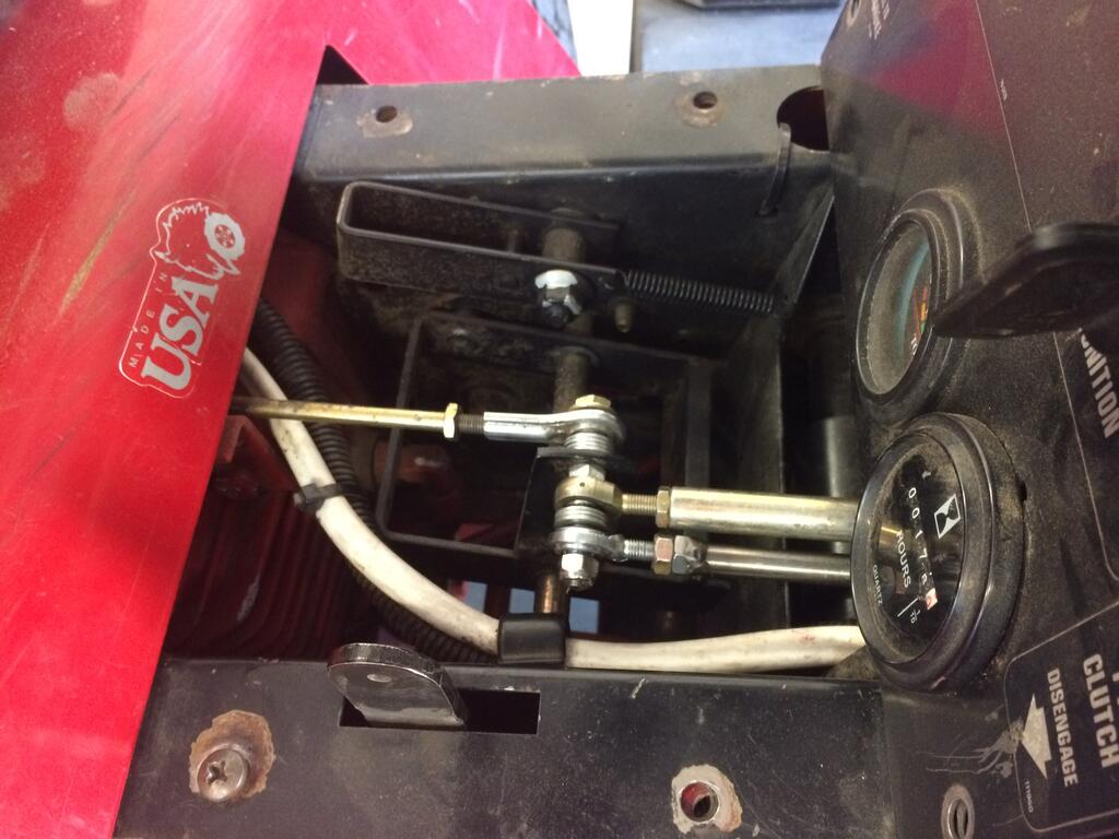

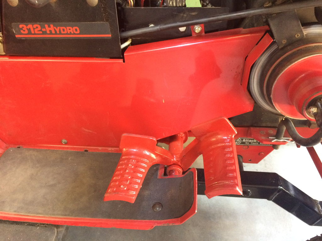

Stroller 20 #1 Posted March 25, 2022 I didn’t actually do this today but I love it so here goes. After adding a loader to my 312 H I was having a terrible time working the bucket while shifting forward and reverse with my right hand, while also attempting to steer. I picked up an old brake and a clutch pedal on eBay, cut and brazed them together and installed them on the existing shaft under the right floorboard. I then fabricated (bent) a linkage rod that connects to the original linkage under the floor in front of the seat. Lastly I ground out the notch in the plate under the dash that causes you to have to lift the shift lever to shift to forward or revers. I have now have full foot control or can still use the hand lever if desired. Cost about 40 bucks and works flawlessly. 5 11 Share this post Link to post Share on other sites
ACman 7,702 #2 Posted March 25, 2022 (edited) Pretty clean fab work and installation …. Picturess with measurements would be appreciated . Edited March 25, 2022 by ACman 4 Share this post Link to post Share on other sites

Handy Don 15,997 #4 Posted March 26, 2022 Nice craftsmanship there. Congrats I would really appreciate if you would add a couple of pictures with a foot operating it to full forward and full reverse? 3 Share this post Link to post Share on other sites
lynnmor 8,644 #5 Posted March 26, 2022 It appears to be a very simple installation compared to others. My one question is the ability of it to find and maintain the neutral position. 2 Share this post Link to post Share on other sites
kpinnc 17,273 #6 Posted March 26, 2022 1 hour ago, lynnmor said: It appears to be a very simple installation compared to others. My one question is the ability of it to find and maintain the neutral position. Just shove the left pedal. Returns to neutral. On my hydros, I call the left pedal my "panic button"... 1 Share this post Link to post Share on other sites
JoeM 9,642 #7 Posted March 26, 2022 Siamese foot control. pretty cool. Doesn't look like an auto self center, just the operator using the rocker, same as the the hand control. I have left the hand control hooked up on a couple foot control conversions. Found running on the hillside side saddle, the hand control is a little easier. Share this post Link to post Share on other sites
EB-80/8inPA 1,981 #8 Posted March 26, 2022 That the business end of that thing is 100% Wheel Horse is pretty neat. Nice! Share this post Link to post Share on other sites
