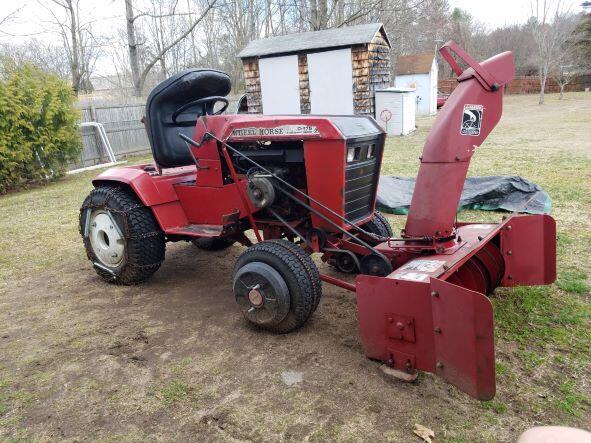

pfrederi 21,148 #4 Posted March 25, 2022 Since the friction surface in an electric PTO is steel to steel i doubt wear would be a huge issue. I may get one for the electric clutch I have to use on my sweepster C-175... (has a JD spec replacement engine) Curious why you are using an electric PTO on your C175 1 Share this post Link to post Share on other sites
midpack 1,148 #5 Posted March 25, 2022 7 minutes ago, pfrederi said: Since the friction surface in an electric PTO is steel to steel i doubt wear would be a huge issue. I may get one for the electric clutch I have to use on my sweepster C-175... (has a JD spec replacement engine) Curious why you are using an electric PTO on your C175 Its got a Magnum 18 in it. Curse of the KT 17 rod 2 Share this post Link to post Share on other sites
pfrederi 21,148 #6 Posted March 25, 2022 6 minutes ago, midpack said: Its got a Magnum 18 in it. Curse of the KT 17 rod Understand that!! I just ordered one from Ebay. Thank you so much. I keep waiting for something bad to happen when I switch on my sweepster even with the engine e at idle the jerking is big time. 1 1 Share this post Link to post Share on other sites
midpack 1,148 #7 Posted March 25, 2022 18 minutes ago, pfrederi said: Understand that!! I just ordered one from Ebay. Thank you so much. I keep waiting for something bad to happen when I switch on my sweepster even with the engine e at idle the jerking is big time. Yeah, that snowthrower would really jump! I feel the engagement but it's much more subdued 3 Share this post Link to post Share on other sites
