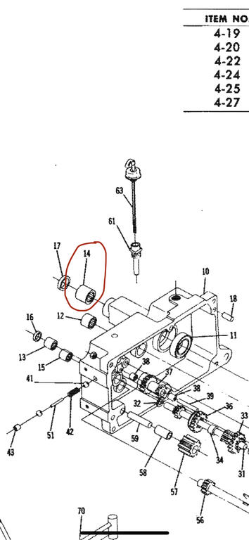

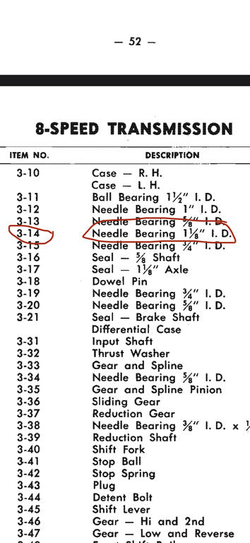

Sam McCall 1 #1 Posted March 25, 2022 Got a c-141 me and my buddies are restoring, I’m rebuilding the transmission and getting ready to put new axle and break seals on. Pulled old axle seals off and the one Torrington bearing is missing a needle and the case is broke, I checked the manual and they are discontinued and I can’t find a part number that works. Does anyone have a part number that will fit? Much appreciated! 1 Share this post Link to post Share on other sites
stevasaurus 23,857 #2 Posted March 25, 2022 The 1 1/8" needle bearing is Wheel Horse 1526, cross over to Torrington or KOYO B-1816. You can get those from any auto parts store, Motion Industries, or Lowell at Wheel Horse parts&more...one of our vendors. Where are my manors??? Welcome to Red Square Sam. Ask any questions you want and enjoy the site. 3 1 Share this post Link to post Share on other sites
