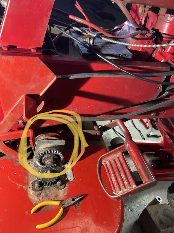

briley 5 #1 Posted March 25, 2022 Does anyone know how to get a mowing belt on the deck pulley? Share this post Link to post Share on other sites
gwest_ca-(File Mod) 12,451 #2 Posted March 25, 2022 Welcome to the forum. Remove the 2 bolts holding that bearing/gear to the deck on the right side. Loosen the 2 bolts holding that bearing/gear to the deck on the left side. That will allow you to lift the gear on the right side enough to slip the belts in and out. 4 Share this post Link to post Share on other sites
squonk 47,887 #4 Posted March 25, 2022 And get a lot of rags! 1 Share this post Link to post Share on other sites
