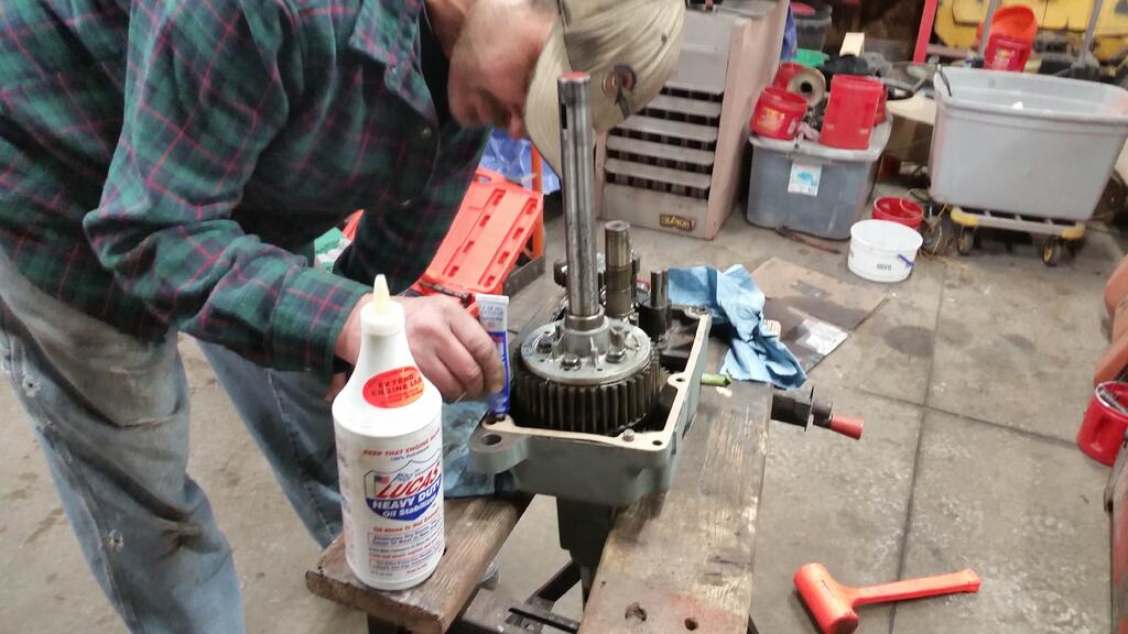

Achto 30,044 #6 Posted March 25, 2022 I use a thin coat of gasket sealer on mine. it's a PITA to get back off if you need to open them back up again, but a Scotchbrite wheel on a 90 degree die grinder makes short work of it. https://www.amazon.com/Permatex-80015-Form-Gasket-Sealant/dp/B0002UEOU0/ref=zg_bs_15719581_21/144-4897151-0344826?pd_rd_i=B071QWMQM2&psc=1 2 Share this post Link to post Share on other sites
WHX?? 53,081 #7 Posted March 25, 2022 4 minutes ago, Achto said: I use a thin coat of gasket sealer on mine. Caught in the act..... 'Side do it right and it won't have to come apart for another 50 years..... I'll be dead.... 4 1 Share this post Link to post Share on other sites
