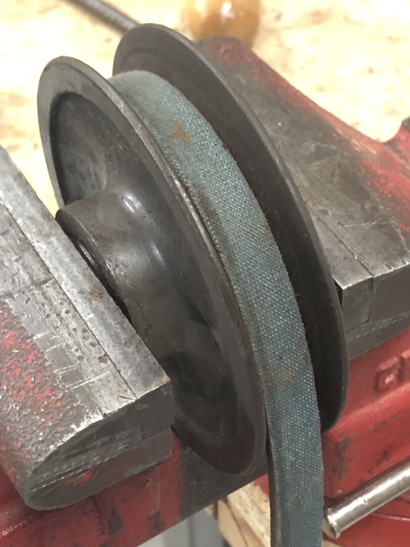

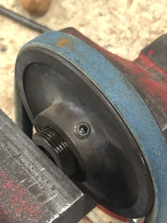

Handy Don 14,452 #1 Posted March 24, 2022 (edited) This is a variable-diameter pulley that @JPWH found and was willing to part with (big thank you!) to give me a hand on my 854 refurb. I'm posting it in a separate topic because, frankly, it just so cool! It is cast steel and nicely finished on all sides with one wall of the pulley fixed to the hub and the other wall threaded onto the hub. A dogpoint set screw secures the fixed-side hub to the shaft. A separate dogpoint setscrew secures the threaded-side to one of the two flats on the threaded hub. The bore is ⅝" with a keyway which matches the input shaft on the 5060 and newer transmissions perfectly. Outer diameter is 4" and and as you can see in the first image, with the movable side turned in tightly against the fixed side, it leaves a 4L belt about ⅛" proud of the pulley--effectively a 4.125" pulley. With the movable side turned away from the fixed side and flush with the outer end of the hub, The belt drops 0.5" lower into the groove, making it a 3.125" pulley. The threading range covers four full revolutions so the pulley diameter adjusts in eighths of an inch. Factory for the 854 input pulley was a 4" but I'll initially set this for 3.5" to get a slight speedup (about 12%) since the 5060 being swapped in is a six speed. Ideally, I can get a compromise belt length that works well at that pulley diameter but still operates ok across its full range. The pulley adjusts with a simple hex wrench and the pulley doesn't have to come off the tractor to be adjusted as long as the belt has a bit of slack. Edited March 25, 2022 by Handy Don 8 3 1 Share this post Link to post Share on other sites

Handy Don 14,452 #10 Posted March 25, 2022 20 minutes ago, Pullstart said: Cool stuff! Will you have enough adjustment in your clutch to allow speed changes at given times, or will you set the belt length according to your predetermined size? My plan is to size the belt for best operation at around the mid-point of adjustment -- 3½" diameter -- and then see how it does at the limits. A lot depends on the clutch pulley range to adapt without hitting the inside of the belt guard when engaged and being able to stop the belt when disengaged. Standard belt is 70" with the 4" pulley. At 3" it should be a 68.5" belt. I'm gonna try a 69" and see how it goes across the adjustment range. I'll be sure to post what I find out! Stock top speed is 5.5 mph. A 3" pulley is a 25% boost to a head-snapping 6.875! 2 2 Share this post Link to post Share on other sites
Handy Don 14,452 #11 Posted March 25, 2022 15 minutes ago, WHX?? said: I didn't think they would stand up to horse duty. I have a small bit of trepidation on that, too. This is being spun at high speed and it's only an 8hp engine so, fingers crossed! 1 Share this post Link to post Share on other sites
WHX?? 52,448 #12 Posted March 25, 2022 2 minutes ago, Handy Don said: bit of trepidation on that I've seen them walk or self adjust if the setscrew isn't super tight. Really messes up threads. Might be ok for for a non worker small HP. 1 Share this post Link to post Share on other sites

wallfish 18,542 #20 Posted March 25, 2022 Hmmm, I like that pulley. Need to get me one of those to play with. It appears to have a flat for the set screw instead of damaging the threads. Maybe drilling a dimple into that could help keep in place for the higher torque of an engine. 2 Share this post Link to post Share on other sites
Handy Don 14,452 #21 Posted March 25, 2022 2 hours ago, wallfish said: Hmmm, I like that pulley. Need to get me one of those to play with. It appears to have a flat for the set screw instead of damaging the threads. Maybe drilling a dimple into that could help keep in place for the higher torque of an engine. I'll get a shot of the flats when I'm in the shop next. 4 hours ago, Maxwell-8 said: Have been thinking about a MTD vario drive on a Wheel Horse I think John Deere used a vario pulley for a while A number of GTs used them at different times. One of my Dad's Craftsman had it. The mechanism had a splined shaft that the movable side slid on and something like a car clutch throwout to change the position. 1 Share this post Link to post Share on other sites
