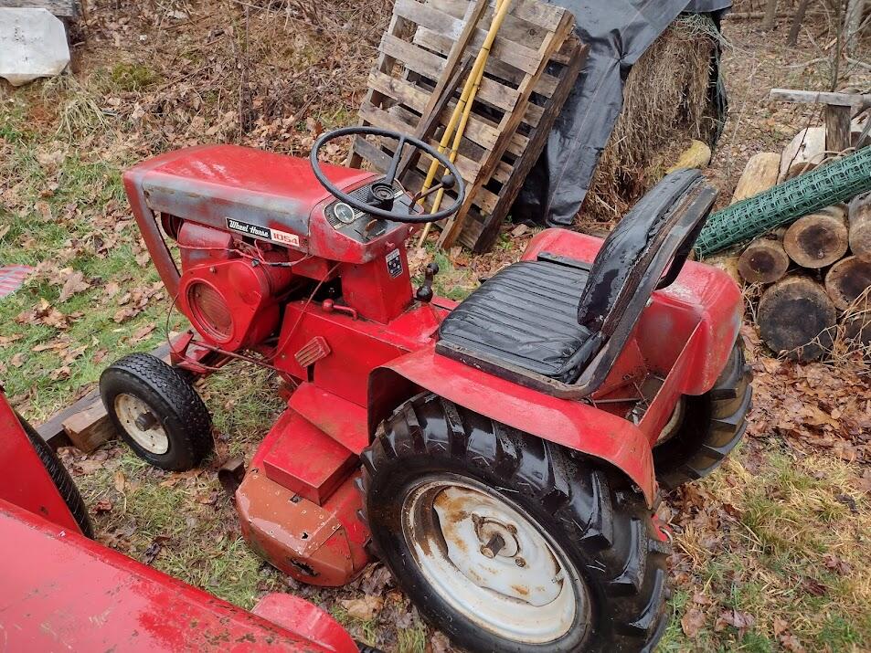

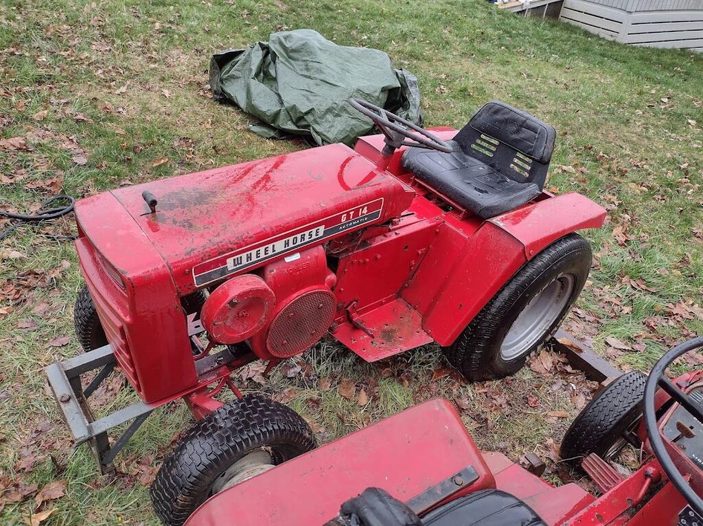

Skwerl58 792 #1 Posted March 22, 2022 I picked up a 70 GT-14 and a 1054 this winter and started checking them over today. I pulled the spark plugs and added about a tablespoon of Marvel mystery oil into the cylinder. Also washed them off and lubed the choke and throttle cables. The GT 14 cables came free and were working but the 1054 were being stubborn. My next move is to drain the old gas from the GT 14 and replace the fuel line, filter and spark plug. The oil is dirty but full, should I change the oil before I attempt to start it or get it going and warm the oil to drain? After I get it running I will move on to the hydro trouble shooting, brake and then tires. 6 2 Share this post Link to post Share on other sites
